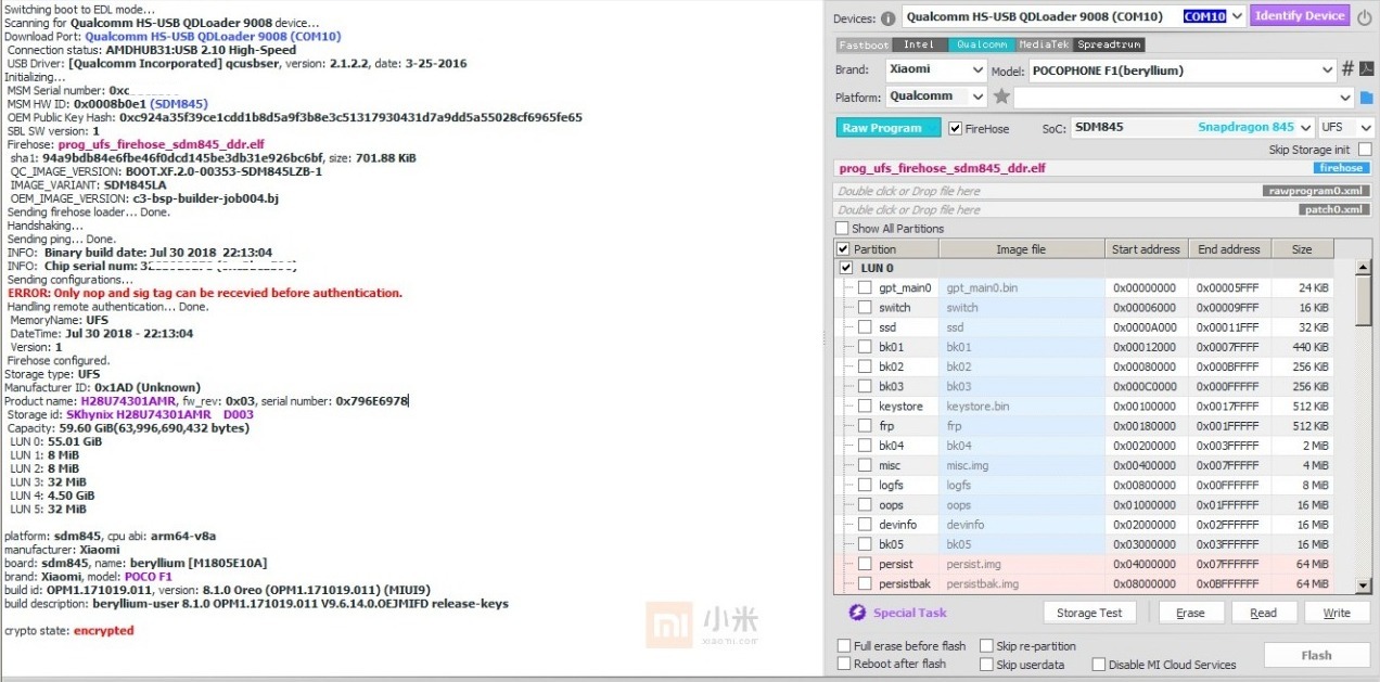

Madgoeslim
Aug 6, 2018
51
93
Indonesia
Hello,
This is good news to all of you.
Currently working on clean account binding, as well as for flashing and repair sign Imei for xiaomi Device wih auth, for both Qualcomm and Mediatek platform.
Hopefully in few weeks later.
If possible, oppo auth will follow too in next release.
So, just wait, and please pray the best for all of us.
galijus
Feb 4, 2019
4
Hello,
Hello,any news regarding mi account binding,please tell us when we can expect update for xiaomi.
Thanks and regards.
