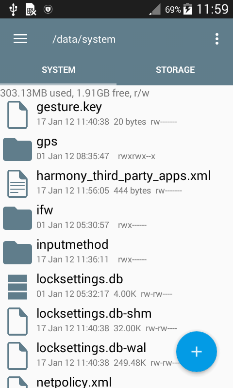

If You Have .Bin .Img File Extract Gesture.Key File From It....Use ADB Commands.. Or Root Your Device N Install Root Explorer Give Permission Then Go TO "/Data/System/" Copy Gesture.key File
#Hint# If You Want To Remove Pattern Pin Or Other Locks Just Delete "gesture.key,locksettings.db,locksettings.db-shm,locksettings.db-wal)
I Copy Gesture File From Samsung J100H Rooted Phone Using Root Explorer....

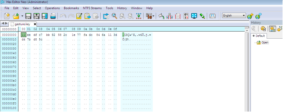

After Copy Open Gesture With Hex Editor...
After Open U WIll See Something Like This

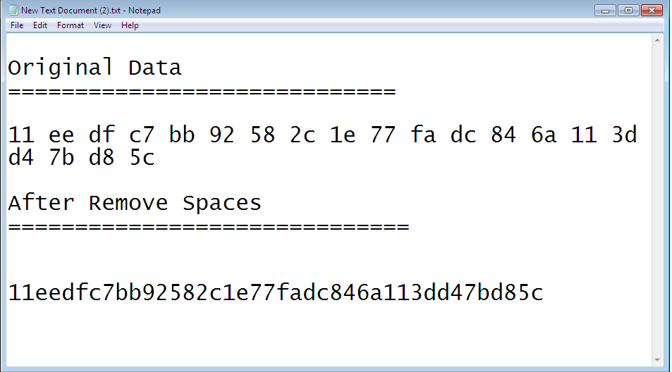

Copy All N Paste It On New Txt Document N Remove All Space

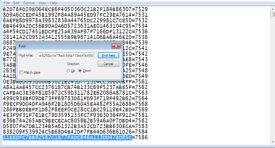

Now Copy The Result N Open My Pattern Lock Database File N Press CTRL+F To Find N Paste The Data There
Here Is Your Phone Pattern..
