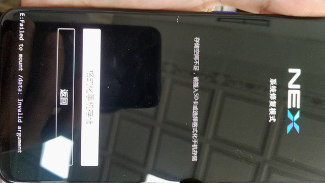

EMT-VIVO NEX (PD1806, 8.1.0) Stuck on recovery mode solve by Factory Reset
Case: VIVO NEX (PD1806, 8.1.0) stuck on recovery
Demand: Factory Reset

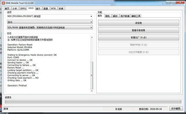

Operation process:
1.Go to Service Tab, Press "Factory Reset"
2.Enter Qualcomm EDL/9008 mode connect USB Cable (install drivers)

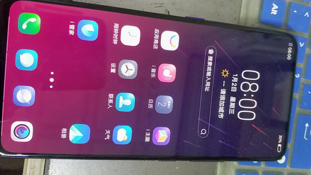

4.Waiting for the operation to complete
Operation process:
