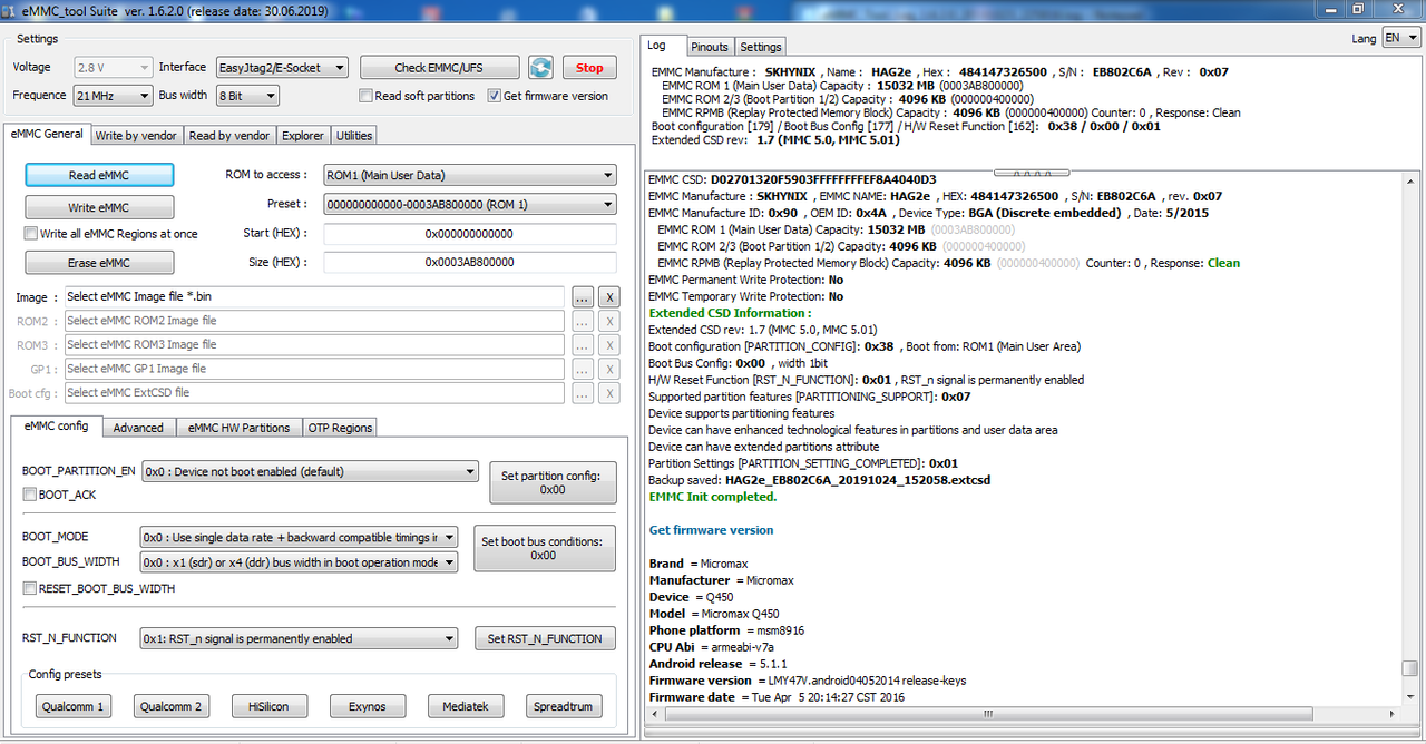

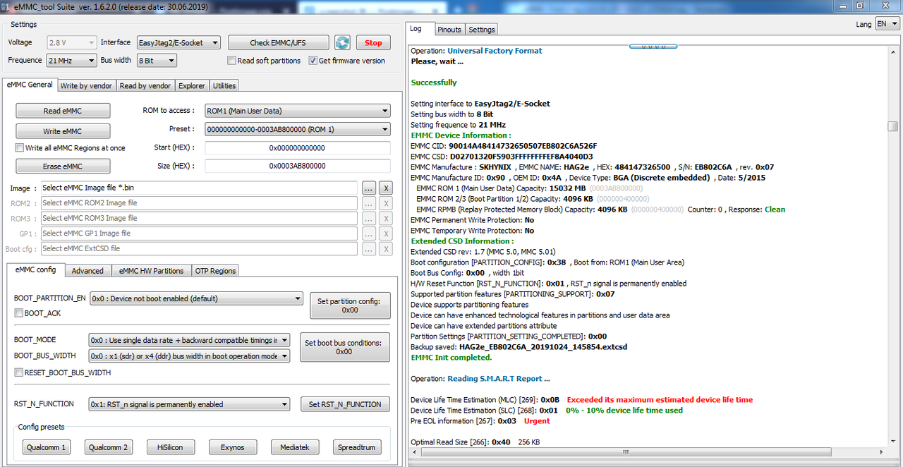

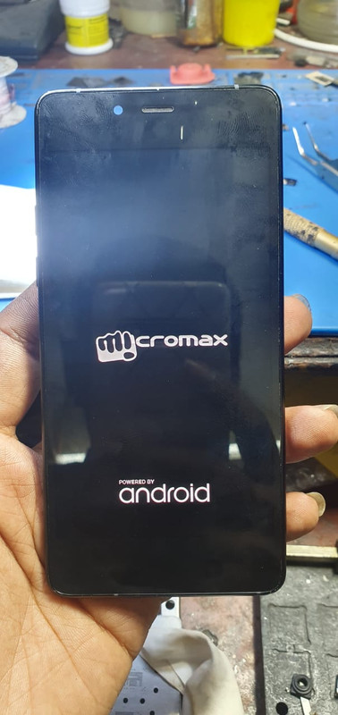

Recevied as HANG on Logo
Flashed with QPST But error
removed Emmc
took read info
every thing was okay
took S.M.A.R.T report showed
Exceeded its maximum estimated device life time. (MLC)
took backup and tried Universal Format
but still error
with special tricks Emmc Back to Normal
Emmc removed
STILL ERROR WITH FORMAT LOGS
After Emmc Repair
Back to Life

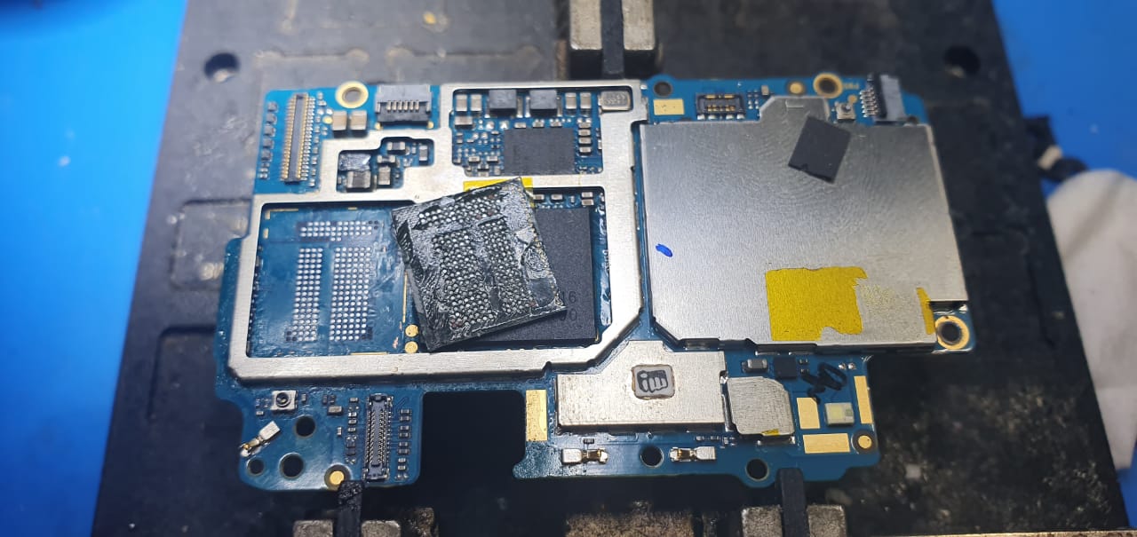

removed Emmc
took read info
but still error
Emmc removed
After Emmc Repair
Back to Life
