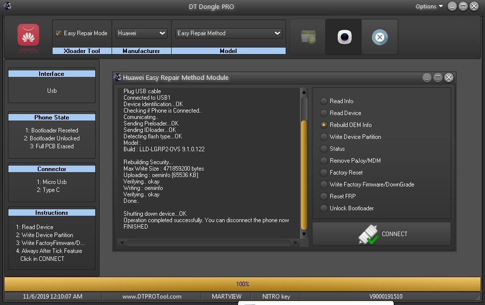

HONOR 9 Lite Unknown Model - Fixed Using DT programmer - Rebuild OEM INFO Success!!
Naeemrh
Apr 30, 2017
28
5
Delhi
HERE IS LOG
Initializing..
Check If Phone is Connected..
Comunicating..
Model :
Brand : HONOR
Manufacturer : HUAWEI
Baseband : 21C60B269S003C000,21C60B269S003C000
State : ABSENT,ABSENT
Hardware : hi6250
Serial : P8B4C18106005679
Cpu : arm64-v8a
Operation Success!!
Selected interface: USB (KIRIN)
Checking USB driver status...OK (Kirin Flash Device 2.01.02.00)
Plug USB cable
Connected to USB1
Device identification...OK
Comunicating..
Sending Preloader...OK
Sending IDloader...OK
Detecting flash type...OK
Model :
Build : LLD-LGRP2-OVS 9.1.0.122
Rebuilding Security...
Max Write Size : 471859200 bytes
Uploading : oeminfo [65536 KB]
Verifying.. okay
Writing : oeminfo
Verifying.. okay
Done..
Shutting down device...OK
Operation completed successfully. You can disconnect the phone now
FINISHED
Initializing..
Plug USB cable
Connected to USB1
Comunicating..
Model : LLD-AL10
FINISHED
REBUILDIING SEECURIITY SET DONE
THANKS DT PRO TEAM FOR HELP
