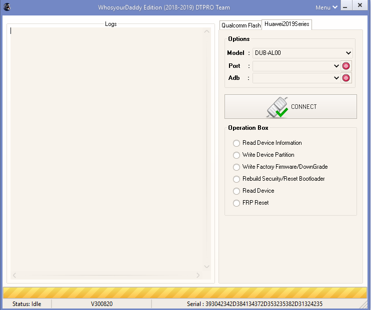

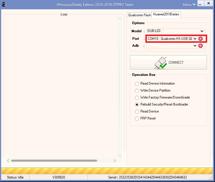

Open Tool

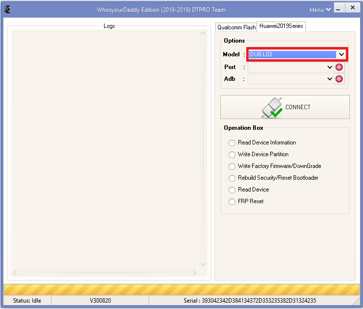

Select Your Correct Model

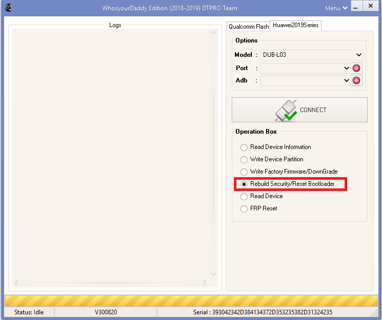

Tick Rebuild Security

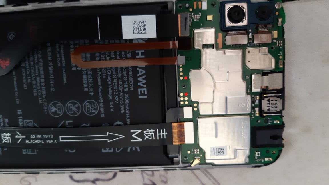

Make TestPoint
Select Qualcomm HS-USB QDloader 9008 "Generate to Make Testpoint"

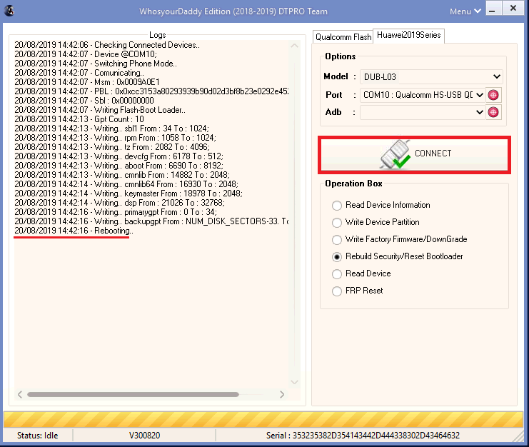

Click in CONNECT -"Wait Finish Operation"

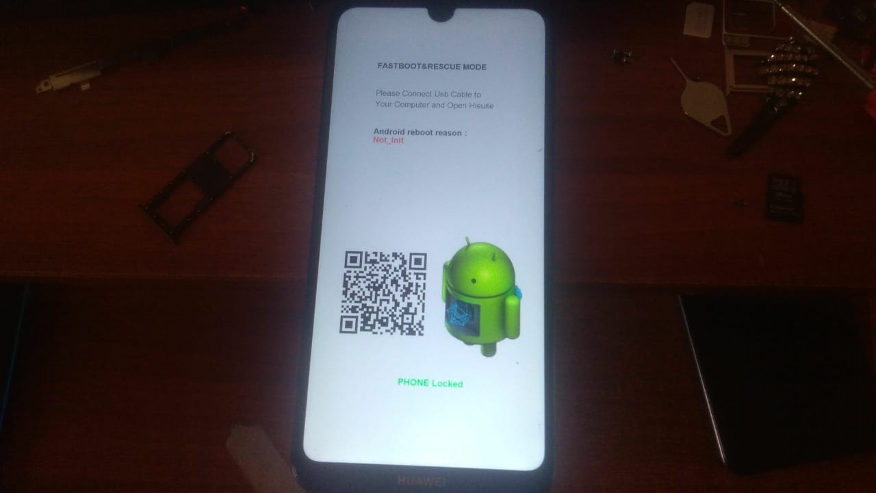

NOW Your Phone is Rebooted to Fastboot Mode

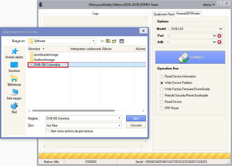

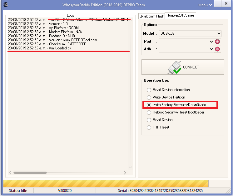

Tick Write Device Partition & Click in Conect
"Select DUB File XML Downloaded"

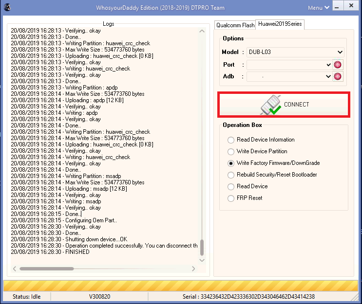

Tick Write Factory Firmware/DownGrade
click in CONNECT - and Wait that Finish Operation
DownGrade Is OK!!

25/08/2019 8:52:36 p. m. - Checking Connected Devices..
25/08/2019 8:52:36 p. m. - Device @COM137;
25/08/2019 8:52:36 p. m. - Switching Phone Mode..
25/08/2019 8:52:36 p. m. - Comunicating..
25/08/2019 8:52:36 p. m. - Msm : 0x0009A0E1
25/08/2019 8:52:36 p. m. - PBL : 0x0xcc3153a80293939b90d02d3bf8b23e0292e452fef662c7499
25/08/2019 8:52:36 p. m. - Sbl : 0x00000000
25/08/2019 8:52:37 p. m. - Writing Flash-Boot Loader..
25/08/2019 8:52:42 p. m. - Gpt Count : 10
25/08/2019 8:52:42 p. m. - Writing.. sbl1 From : 34 To : 1024;
25/08/2019 8:52:42 p. m. - Writing.. rpm From : 1058 To : 1024;
25/08/2019 8:52:42 p. m. - Writing.. tz From : 2082 To : 4096;
25/08/2019 8:52:42 p. m. - Writing.. devcfg From : 6178 To : 512;
25/08/2019 8:52:42 p. m. - Writing.. aboot From : 6690 To : 8192;
25/08/2019 8:52:43 p. m. - Writing.. cmnlib From : 14882 To : 2048;
25/08/2019 8:52:43 p. m. - Writing.. cmnlib64 From : 16930 To : 2048;
25/08/2019 8:52:43 p. m. - Writing.. keymaster From : 18978 To : 2048;
25/08/2019 8:52:43 p. m. - Writing.. dsp From : 21026 To : 32768;
25/08/2019 8:52:45 p. m. - Writing.. primarygpt From : 0 To : 34;
25/08/2019 8:52:46 p. m. - Writing.. backupgpt From : NUM_DISK_SECTORS-33. To : 33;
25/08/2019 8:52:46 p. m. - Rebooting..
