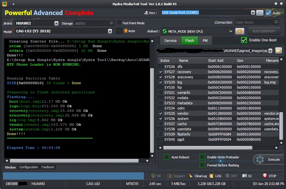

Huawei CAG-L02 Y3 2018 Write Firmware scatter format with hydra
Brand : HUAWEI Model : CAG-L02 (Y3 2018) Connection : Flash Mode
How To Boot : Power off phone
* BROM Mode : Press VOL +
Connection[WAITING]Found
Mode[PreLoader] Port[COM8] Status[Opened]
Identifying Hardware ID
BROM CPUID : 0335 (0000)MT6737[6735]
BROM HW_SW_VER : 8A00 CB00 0000 0000
SECURE VERSION : FF
BL VERSION : 02
BR Secured : 05
Preparing Download Agent..
Download Agent : MT6735_CairoGO-L02_da_pl.bin
MTK_DOWNLOAD_AGENT
MTK_AllInOne_DA_v3.3001.00.00
Initializing Loader [1]
Sending Loader [1] Accepted
PROTOCOL[OLD] - eMMC
5
PRMMCCID : 460001154D32364EE0570642CBB1C6F2
Running DA 4.2 on BBID : 0x9B
Init Configuration
4
00000000
00000000 Ok
Initializing Loader [2]
Sending Loader [2] Accepted
Reading Flashchip data....
eMMC RPMB : 0x0000000000080000 -512 KB
eMMC USER : 0x00000001D2000000 -7.281 GB
ERAM Size : 0x0000000040000000 -1024 MB
IRAM Size : 0x0000000000020000 -128 KB
UNICAL RID : BEBEF5E12E76B0395B1EFB519E9201BC
eMMC CID : 460001154D32364EE0570642CB45C6F2
Change to HIGH SPEED...
Mode Port[COM124] Status[Opened]
Reading Partition Table
SIZE[0x00000D10] 38 Items > Done
Reading System Info
Model : CAG-L02
Brand : HUAWEI
Android Ver : 8.1.0
Manufacturer : HUAWEI
Device : HWCAG-L6737M
Display ID :
Security Patch : 2018-09-01
Kernel ID : 2018-09-01
FingerPrint : HUAWEI/CAG-L02/HWCAG-L6737M:8.1.0/HUAWEICAG-L02/C316B122:user/release-keys
Autobackup Partitions
preloader [0x00000000-0x00080000] 512 KB Done
-> Renaming Preloader.... preloader_cro_go.bin
Creating Scatter file... E:\Setup Box Dongle\Hydra dongle\Hydra Tool\\Backup\Auto\HUAWEI_CAG-L02_0335--8.1.0()_030120140857\MT6737_Android_scatter.txt
nvram [0x00380000-0x00880000] 5 MB Done
nvdata [0x0CD00000-0x0ED00000] 32 MB Done
Done!!!
Preparing to flash selected partitions
Flashing....
boot(boot.img)11.17 MB Ok
logo(logo.bin)672.543 KB Ok
recovery(recovery.img)25.086 MB Ok
erecovery(erecovery.img)25.086 MB Ok
log(log.img)4.602 MB Ok
vendor(vendor.img)153.575 MB Ok
system(system.img)1.228 GB Ok
Done!!!!
Elapsed Time : 00:03:08
