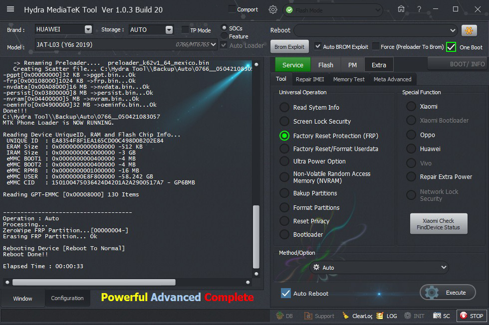

Huawei JAT-L03 (Y6s 2019) FRPL successfully removed by Hydra Tool
1. Run MTK tool of Hydra Dongle.
2. Choose Correct Module and Brand.
3. Go to "Service" -- > "Tool"
4. choose "Factory Reset Protection (FRP)".
5. Choose "Auto" from "Method / Option" drop down menu.
6. Click on "Execute" and connect device with computer using USB cable.
7. Wait until the process is completed.
BR=====================================
FriendlyName :MediaTek USB Port (COM10)
SymbolicName :\??\USB#VID_0E8D&PID_0003#5&521a615&0&7#{a5dcbf10-6530-11d2-901f-00c04fb951ed}
Handshaking...Ok
Identifying Hardware ID.....
BROM CPUID : 0766MT6765[6765]
getMTKPayloadExploit : 0766
#Executing Exploit..
#SUCCESS..
Handshaking...Ok
FUSEID : 00000000
SECURE VERSION : 05
BL VERSION : FE
BR Secured : E0
Preparing Download Agent..
DA : Huawei__6765_8A00CA0000000000_00001000_00030000.bin
Ver : MTK_AllInOne_DA_v3.3001.2018/10/18.17:38_452898
Init : Loader [1]
Sending : Accepted
Identifying Protocol...
Protocol : New
Synchronization...SYNC
Mode : brom
Preloader Initialization...
Parsing preloader_k62v1_64_mexico.bin
Init : Accepted
Execute Secondary Loader
Init : Loader [2]
Executing : SYNC
UNIQUE ID : EA8354F8F1EA165CD00C498D0B202E84
eMMC CID : 150100475036424D4201A2A2900517A7 - GP6BMB
DA Speed : high-speed
Autobackup Partitions
-> Renaming Preloader.... preloader_k62v1_64_mexico.bin
Creating Scatter file... C:\Hydra Tool\\Backup\Auto\0766__050421083057\MT6765_Android_scatter.txt
-frp[0x00108000]1024 KB ->frp.bin...Ok
-nvdata[0x00A08000]16 MB ->nvdata.bin...Ok
-persist[0x03800000]8 MB ->persist.bin...Ok
-nvram[0x04400000]5 MB ->nvram.bin...Ok
-oeminfo[0x04900000]32 MB ->oeminfo.bin...Ok
Done!!!
Operation : Auto
Processing...
ZeroWipe FRP Partition...[00000004-]
Erasing FRP Partition... Ok
Reboot Done!!
Elapsed Time : 00:00:33
