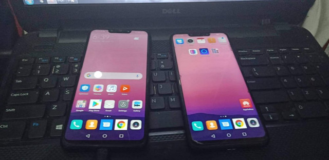

More things to comment, once successfully degraded and echo frp or any repair, if you look at the screenshot I have taken that is not the real or correct background, it is lilac, it is seen in the photo, you connect to the wifi and you are going to updates of the huawei, it will connect to the huawei server, will make checks and you will get the last update that the server has for that huawei, when the process is finished you will see that the wallpaper is not the same and many more things, as long as you want to go back to the emui 9.1 version, with this I want to say you can download firmware, the latest version, put it in an sdcard etc, this is to the taste of each user or technician, thank you very much.

Good, if you follow the procedure, download the file and flash, then factory reset and when you restart safe mode and you will have done the frp baypass, you only have to update the huawei so that the lilac or pink screen is removed
