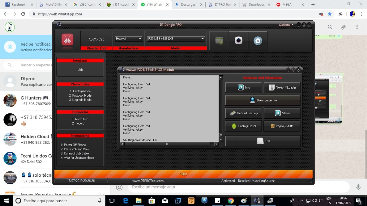

Huawei P20Lite "ANDROID 9.1.0.134(C605E3R1P3)" Downgrade Success - From Colombia!!
DTPRO Tool
Sep 3, 2018
5,221
4,858
nico_2202
Initializing..
1. Select "Xloader" option.
2. Then select proper Xloader (*.xml or .DT) file.
3. Perform "DownGradePRO" operation (All Security of Phone will be Disabled)
Selected interface: USB (KIRIN)
Checking USB driver status...OK (Kirin Flash Device 2.01.02.00)
Plug USB cable
Connected to USB1
Device identification...OK
Comunicating..
Sending Preloader...OK
Sending IDloader...OK
Detecting flash type...OK
Model : ANE-LX3
Build : ANE-LX3 9.1.0.134(C605E3R1P3)
Serial KPS7N18518003737
Imei 867903033231454
Imei 1867903033267466
MEID 00000000000000
Total Files to Process : 64
Writing Partition : huawei_crc_check
Max Write Size : 471859200 bytes
Uploading : huawei_crc_check [0 KB]
Verifying.. okay
Writing : huawei_crc_check
Verifying.. okay
Done..

Shutting down device...OK
Operation completed successfully. You can disconnect the phone now
FINISHED
