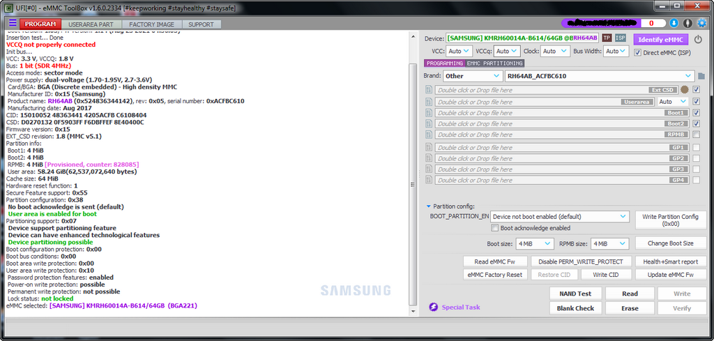

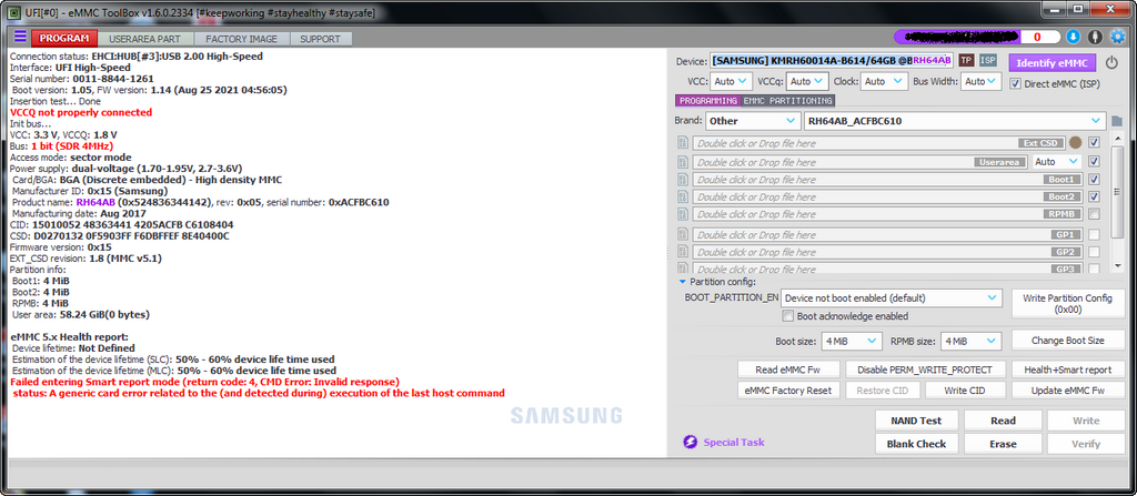

hello everyone I Am New User Of UFI Box & Vivo V9 Hang On LOGO So Please Help Me so i am sharing some report so please help me
CONNECT SUCCESSFULLY:
but when i Was Do Health +Smart Report This error coming :
So Please help me & solve my problem
Note:what will my next work for solve this problem please tell me

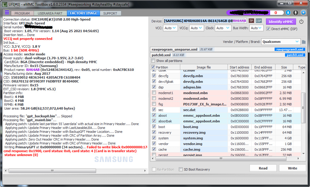

its qualcom cpu
samsung emmc not partion only update and write dump
goto factory image and flash.

first you reset the emmc factory then erase the emmc. now identify emmc then write new perfect dump.(it is better to download new dump from google or any paid website).
at last go to factory image and select correct file then flash it.
set clock speed to 24MHz.
