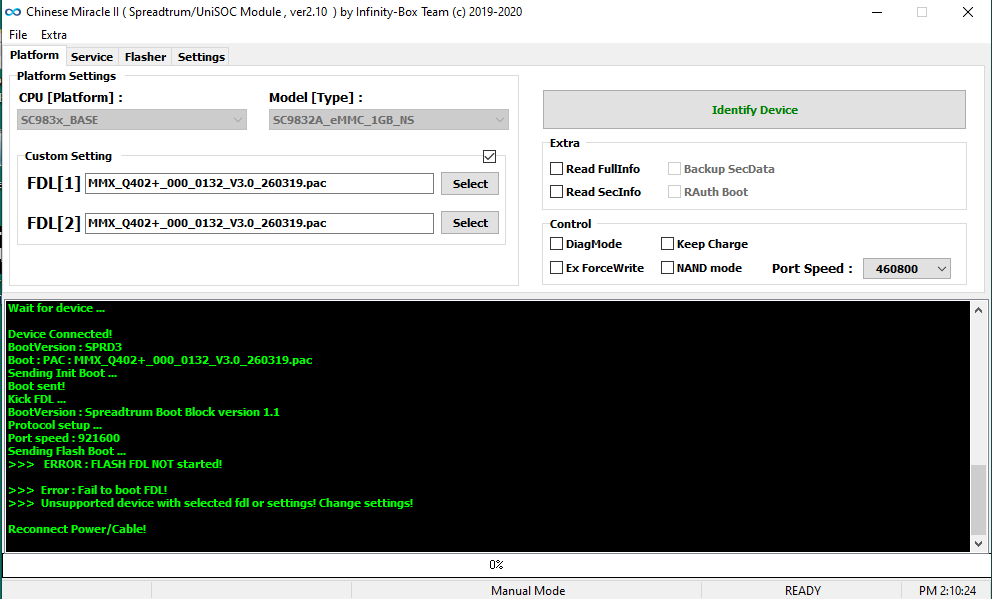

does it support Micromax Bharat 2 Plus(Q402+) NETWORK UNLOCK ?
phone model can be the same but memory structure may be different even for the same model name.
Tho only way to know result - try and see result.
