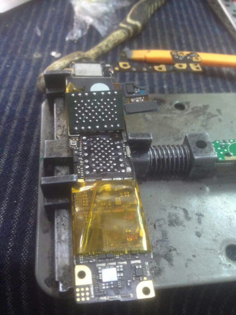

Hi guys I have an IPhone 6 more after restoration it gives error 4013 I removed the Nand then I program with naviplus I try to restore again it gives error 40 that it can create that or that I must do thank you any advice will be received with admiration

How should I do because in the programmer the Nand already gives fail to read the information for up in another Na

if programmer gives you an error .try other nand brother :) and if you dont have info from the original nand.,use GSX to retrieve the phones info afaik :) .hope it helps

the problem was that the Nand was not well reball after reball the phone was successfully restored the images are staying on my desktop so the error 40 reball foul thank you for your for your contribution dice advice
