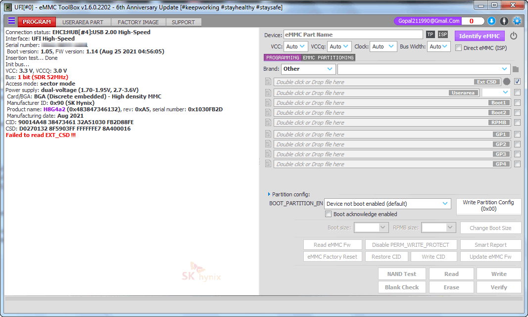

today in my shop itel a23 pro with hang on logo condition i was try many flash tools but still Fail during write flash than i was try in ufi emmc tool but this error coming
i was try write flash but problem still same( every time flash Fail :

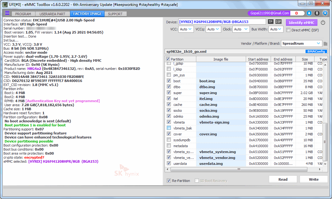

But emmc connect Direct to BGA 221 Adapter but also coonectin problem coming
So please solve my problem

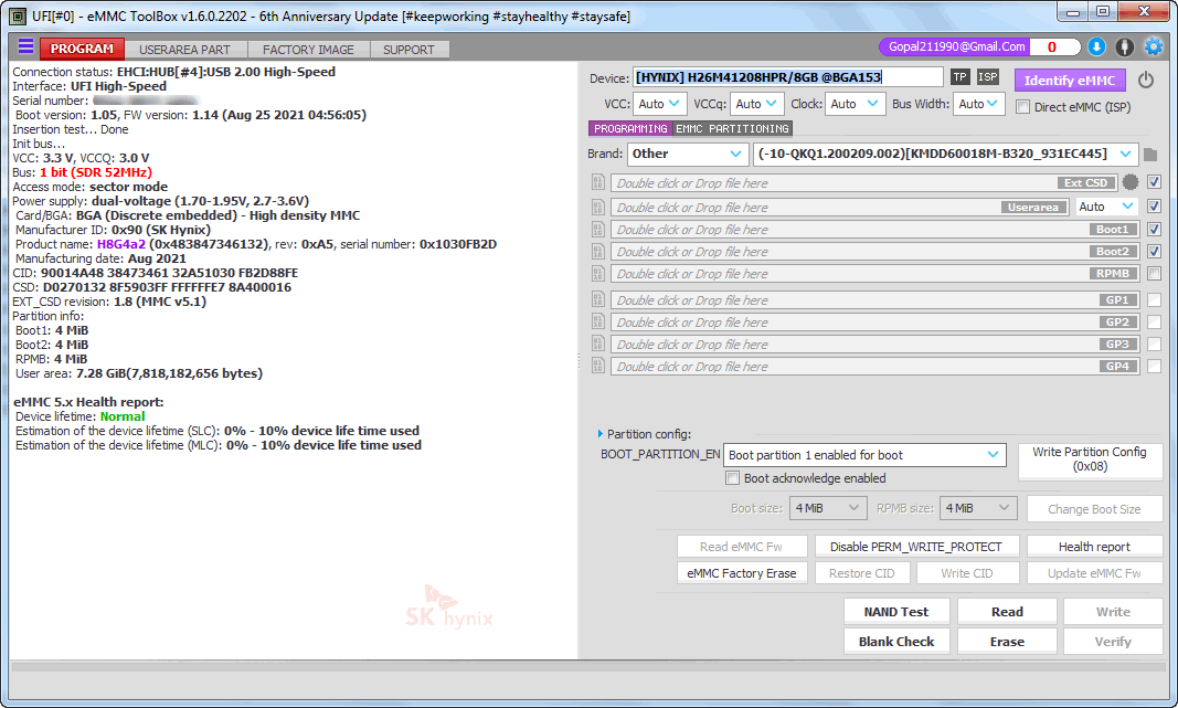

now connect successfully here i giving connect info + Health Report :

This is known bug especially ext_csd with different boot and rpmb size, team will be fix it asap.
For now, you may try to set boot config manually or via preset menu in ext_csd tab according to your SoC platform.
