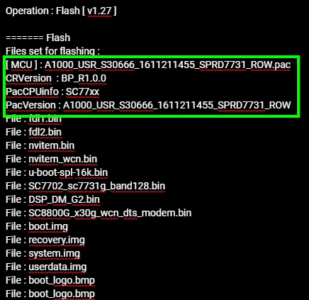

Operation : Flash [ v1.27 ]
======= Flash
Files set for flashing :
[ MCU ] : A1000_USR_S30666_1611211455_SPRD7731_ROW.pac
CRVersion : BP_R1.0.0
PacCPUinfo : SC77xx
PacVersion : A1000_USR_S30666_1611211455_SPRD7731_ROW
======= Flash
PacCPUinfo : SC77xx
======= Flash
PacCPUinfo : SC77xx

Sync...
Sync...
Sending FDL
[Info] : If SW freeze here more, than 15 seconds - remove cable
PickUp loaders from pac
FDL Ready!
Boot Ver : Spreadtrum Boot Block version 1.1
Sending FLASH FDL
FLASH FDL Ready!
Boot Ok!
FlashMode Set : Ok!
PMTManager : Load 0x18 records
PMTManager : PMT Update Ok!
Flashing now
[FlashProc] : ERASE
Current ID : ERASEUBOOT
Current Part : uboot
[FlashProc] : Ok!
[FlashProc] : BOOTCODE
Current ID : SPLLOADER
Current File : u-boot-spl-16k.bin
Flashing now ...
[FlashProc] : Ok!
[FlashProc] : CODE
Current ID : MODEM_W
Current File : SC7702_sc7731g_band128.bin
Flashing now ...
[FlashProc] : Ok!
[FlashProc] : CODE
Current ID : DSP_W
Current File : DSP_DM_G2.bin
Flashing now ...
[FlashProc] : Ok!
[FlashProc] : CODE
Current ID : MODEM_WCN
Current File : SC8800G_x30g_wcn_dts_modem.bin
Flashing now ...
[FlashProc] : Ok!
[FlashProc] : CODE
Current ID : BOOT
Current File : boot.img
Flashing now ...
[FlashProc] : Ok!
[FlashProc] : CODE
Current ID : RECOVERY
Current File : recovery.img
Flashing now ...
[FlashProc] : Ok!
[FlashProc] : IMAGE
Current ID : SYSTEM
Current File : system.img
Flashing now ...
[FlashProc] : Ok!
[FlashProc] : IMAGE
Current ID : USERDATA
Current File : userdata.img
Flashing now ...
[FlashProc] : Ok!
[FlashProc] : CODE
Current ID : BOOTLOGO
Current File : boot_logo.bmp
Flashing now ...
[FlashProc] : Ok!
[FlashProc] : CODE
Current ID : FASTBOOT_LOGO
Flashing now ...
[FlashProc] : Ok!
[FlashProc] : ERASE
Current ID : FLASH
Current Part : wruntimenv1
[FlashProc] : Ok!
[FlashProc] : ERASE
Current ID : FLASH_WCN
Current Part : wcnruntimenv1
[FlashProc] : Ok!
[FlashProc] : CODE
Current ID : PRODNV
Current File : prodnv.img
Flashing now ...
[FlashProc] : Ok!
[FlashProc] : IMAGE
Current ID : CACHE
Current File : cache.img
Flashing now ...
[FlashProc] : Ok!
[FlashProc] : ERASE
Current ID : ERASEMISC
Current Part : misc
[FlashProc] : Ok!
Current ID : UBOOTLOADER
Current File : u-boot.bin
Flashing now ...
[FlashProc] : Ok!
[FlashProc] : IMAGE
Current ID : OEM
Current File : oem.img
Flashing now ...
[FlashProc] : Ok!
Elapsed: 00:09:16
Reconnect Power/Cable!
