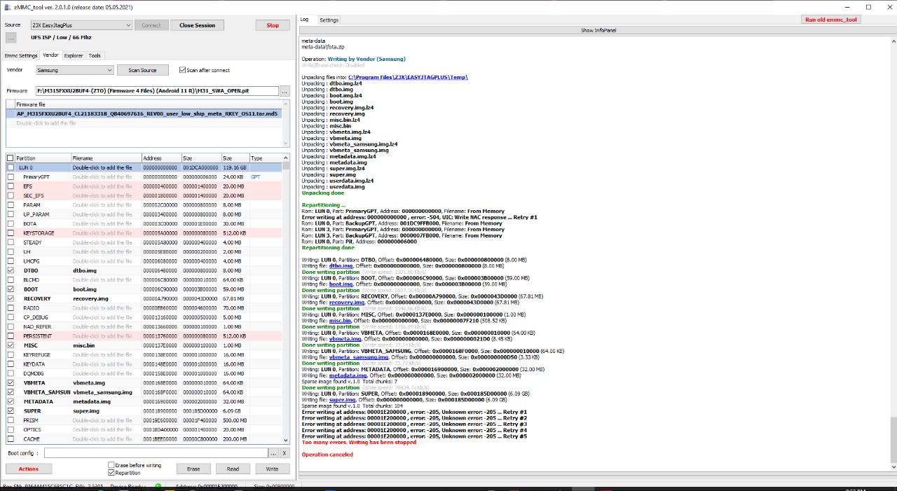

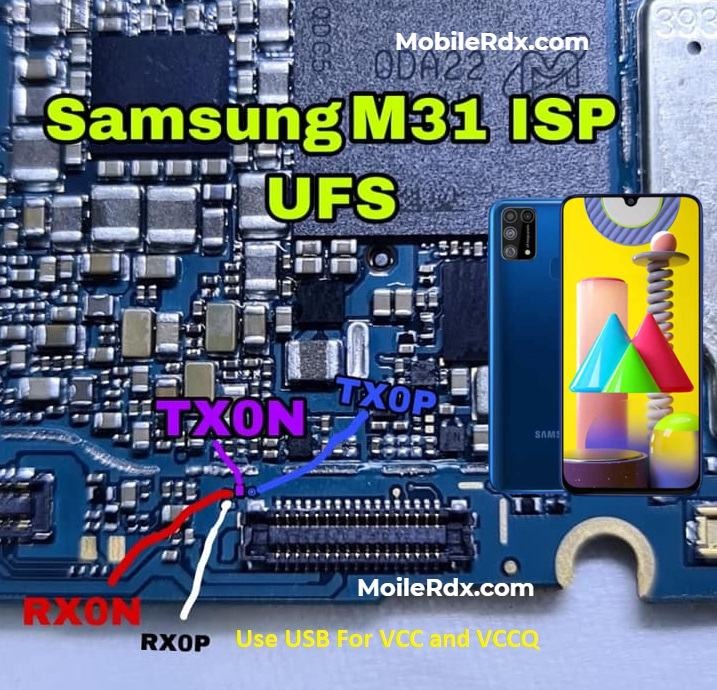

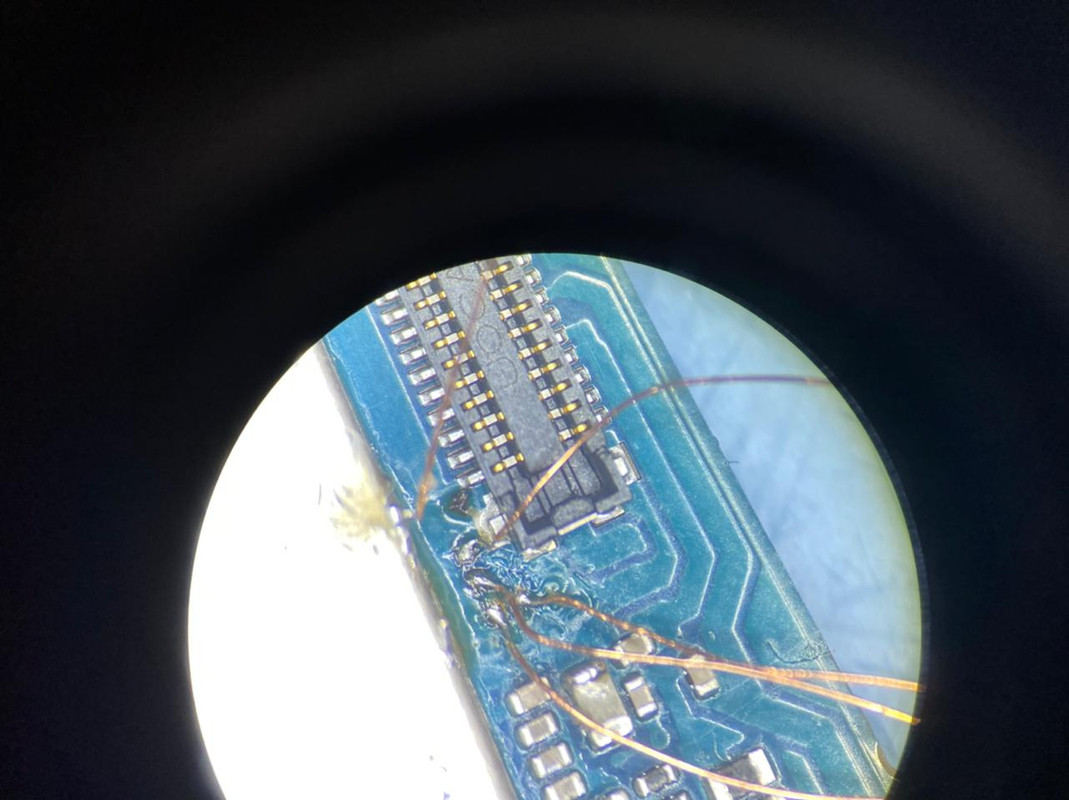

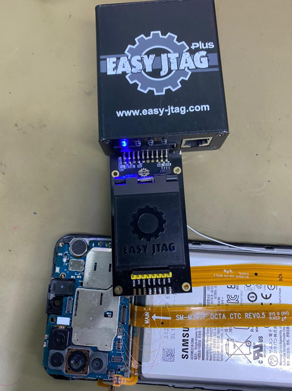

UFS pinouts :

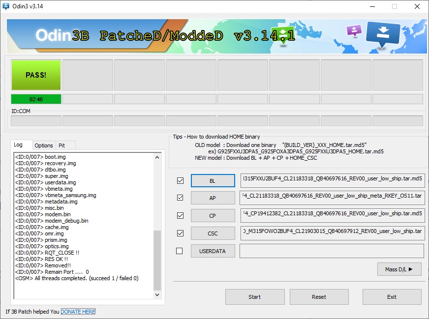

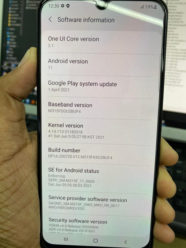

Firmware used : M315FXXU2BUF4
Software used : Easy Jtag Plus 2
Flashing error at this step :
Writing: LUN 0, Partition: SUPER, Offset: 0x000018900000, Size: 0x000185D00000 (6.09 GB)
Writing file: super.img, Offset: 0x000000000000, Size: 0x000185D00000 (6.09 GB)
Sparse image found v.1.0 Total chunks: 104
Error writing at address: 00001E200000 , error: -205, Unknown error: -205 ... Retry #1
Error writing at address: 00001E200000 , error: -205, Unknown error: -205 ... Retry #2
Error writing at address: 00001E200000 , error: -205, Unknown error: -205 ... Retry #3
Error writing at address: 00001E200000 , error: -205, Unknown error: -205 ... Retry #4
Error writing at address: 00001E200000 , error: -205, Unknown error: -205 ... Retry #5
Too many errors. Writing has been stopped
Operation canceled

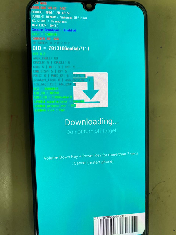

Then remove Jumper wires and flash with download mode
Operation Logs :
Operation canceled
Operation Logs :

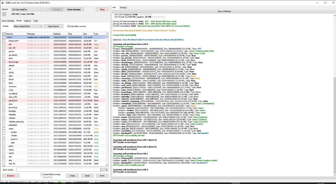

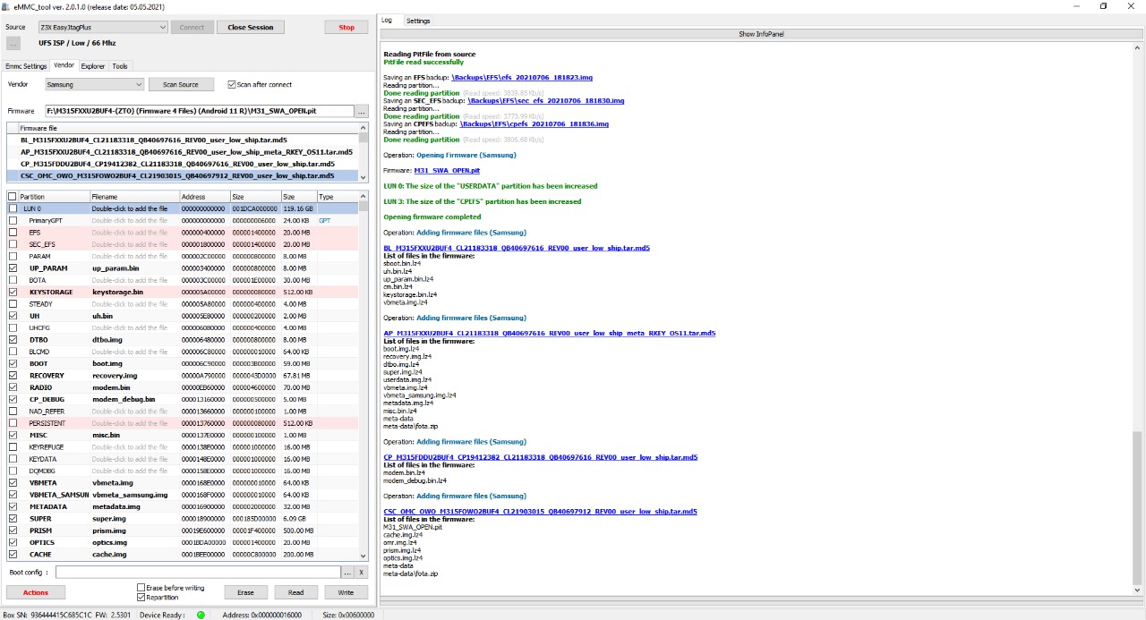

06/07/2021 7:16:22 PM> eMMC_tool ver. 2.0.1.0 (release date: 05.05.2021)
06/07/2021 7:16:22 PM> Microsoft Windows 10 (32 bit) build 19043 (10.0.19041.1023)
06/07/2021 7:16:22 PM> Looking for EasyJTAG box...
06/07/2021 7:16:22 PM> EasyJTAG API ver. 3403
06/07/2021 7:16:23 PM> OpenUSB return = 0
06/07/2021 7:16:23 PM> EasyJTAG Box Serial = 936444415C685C1C
06/07/2021 7:16:24 PM> Card Serial = AA269DBB
06/07/2021 7:16:24 PM> EasyJTAG Box Firmware = 2.5301
06/07/2021 7:16:25 PM>
06/07/2021 7:16:33 PM> OpenUFS return = -56
06/07/2021 7:16:47 PM> Operation: Connect to Z3X EasyJtagPlus
06/07/2021 7:16:47 PM> Setting Interface to EasyJtag2/UFS ISP
06/07/2021 7:16:47 PM> Setting IO Levels to Low
06/07/2021 7:16:47 PM> Setting Frequence to 66 Mhz
06/07/2021 7:16:56 PM> UFS Init Failed. Error: -113. Reason: UTP: Failed to NOP request
06/07/2021 7:24:44 PM> Operation: Connect to Z3X EasyJtagPlus
06/07/2021 7:24:44 PM> Setting Interface to EasyJtag2/UFS ISP
06/07/2021 7:24:44 PM> Setting IO Levels to Low
06/07/2021 7:24:44 PM> Setting Frequence to 66 Mhz
06/07/2021 7:24:52 PM> UFS Init Failed. Error: -113. Reason: UTP: Failed to NOP request
06/07/2021 7:26:32 PM> OpenUFS return = -56
06/07/2021 7:26:42 PM> Operation: Connect to Z3X EasyJtagPlus
06/07/2021 7:26:42 PM> OpenUFS return = -56
06/07/2021 7:26:42 PM> Setting Interface to EasyJtag2/UFS ISP
06/07/2021 7:26:42 PM> Setting IO Levels to Low
06/07/2021 7:26:42 PM> Setting Frequence to 66 Mhz
06/07/2021 7:26:42 PM> Socket Information :
06/07/2021 7:26:42 PM> Socket Mark: EasyJTAG UFS Socket BGA-254 by EasyJTAG 11.12.20
06/07/2021 7:26:42 PM> Socket Serial: 01234DB3D649CC30EE
06/07/2021 7:26:42 PM> Socket Type: UFS_SOCKET_BGA_254
06/07/2021 7:26:42 PM> Can't init device. Error: -56. Reason: BOX: UFS Box init link T0
06/07/2021 7:26:50 PM> Operation: Connect to Z3X EasyJtagPlus
06/07/2021 7:26:51 PM> OpenUFS return = -56
06/07/2021 7:26:51 PM> Setting Interface to EasyJtag2/UFS ISP
06/07/2021 7:26:51 PM> Setting IO Levels to Low
06/07/2021 7:26:51 PM> Setting Frequence to 66 Mhz
06/07/2021 7:26:51 PM> Socket Information :
06/07/2021 7:26:51 PM> Socket Mark: EasyJTAG UFS Socket BGA-254 by EasyJTAG 11.12.20
06/07/2021 7:26:51 PM> Socket Serial: 01234DB3D649CC30EE
06/07/2021 7:26:51 PM> Socket Type: UFS_SOCKET_BGA_254
06/07/2021 7:26:51 PM> Can't init device. Error: -56. Reason: Unknown error: -56
06/07/2021 7:27:02 PM> Operation: Connect to Z3X EasyJtagPlus
06/07/2021 7:27:05 PM> Setting Interface to EasyJtag2/UFS ISP
06/07/2021 7:27:05 PM> Setting IO Levels to Low
06/07/2021 7:27:05 PM> Setting Frequence to 66 Mhz
06/07/2021 7:27:07 PM> Socket Information :
06/07/2021 7:27:07 PM> Socket Mark: EasyJTAG UFS Socket BGA-254 by EasyJTAG 11.12.20
06/07/2021 7:27:07 PM> Socket Serial: 01234DB3D649CC30EE
06/07/2021 7:27:07 PM> Socket Type: UFS_SOCKET_BGA_254
06/07/2021 7:27:07 PM> UFS Power Information :
06/07/2021 7:27:07 PM> Mode: Low, VCC: 3250 mV, VCCQ2: 1917 mV
06/07/2021 7:27:07 PM> UFS Device Information :
06/07/2021 7:27:07 PM> UFS Manufacturer: SAMSUNG, UFS ProductName: KLUDG4U1EA-B0C1
06/07/2021 7:27:07 PM> UFS OemID: SAMSUNG_OEM_ID, UFS SerialNumber: 0x4C6BEB08C63F7EB39414F739C0815648554C3638394A42
06/07/2021 7:27:07 PM> Maximum Number of LUs: 8, Number of LUs found: 5, Number of WLUs found: 1, LUs Re-configure: Disabled
06/07/2021 7:27:07 PM> RPMB Counter: 1061
06/07/2021 7:27:07 PM> UFS LUN 0 Capacity: 122016 MB (001DCA000000)
06/07/2021 7:27:07 PM> UFS LUN 1 (Boot A) Capacity: 4 MB (000000400000)
06/07/2021 7:27:07 PM> UFS LUN 2 (Boot B) Capacity: 4 MB (000000400000)
06/07/2021 7:27:07 PM> UFS LUN 3 Capacity: 8 MB (000000800000)
06/07/2021 7:27:07 PM> UFS LUN 4 Capacity: 8 MB (000000800000)
06/07/2021 7:27:07 PM> UFS W-LUN 0xC4 (RPMB) Capacity: 16 MB (000001000000)
06/07/2021 7:27:07 PM> Device Life Time Estimation B: 0x01 0% - 10% device life time used
06/07/2021 7:27:07 PM> Device Life Time Estimation A: 0x01 0% - 10% device life time used
06/07/2021 7:27:07 PM> Pre EOL information: 0x01 Normal (Consumed less then 80% of reserved block)
06/07/2021 7:27:07 PM> Do not turn the socket before you press "Close Session" button
06/07/2021 7:27:07 PM> Connected successfully
06/07/2021 7:27:07 PM> Operation: Scan PartitionTable from Source (Vendor: Binary Read/Write)
06/07/2021 7:27:07 PM> Scanning soft partitions from LUN 0
06/07/2021 7:27:07 PM> GPT header is found
06/07/2021 7:27:12 PM> Partition: PrimaryGPT, [000000000000 - 000000006000], Size: 000000006000 (24.00 KB), Type: GPT
06/07/2021 7:27:12 PM> Partition: efs, [000000400000 - 000001800000], Size: 000001400000 (20.00 MB), Type: Linux (/mnt/vendor/efs)
06/07/2021 7:27:12 PM> Partition: sec_efs, [000001800000 - 000002C00000], Size: 000001400000 (20.00 MB), Type: Linux (/efs)
06/07/2021 7:27:12 PM> Partition: param, [000002C00000 - 000003400000], Size: 000000800000 (8.00 MB), Type: Raw
06/07/2021 7:27:12 PM> Partition: up_param, [000003400000 - 000003C00000], Size: 000000800000 (8.00 MB), Type: Raw
06/07/2021 7:27:12 PM> Partition: bota, [000003C00000 - 000005A00000], Size: 000001E00000 (30.00 MB), Type: Blank
06/07/2021 7:27:12 PM> Partition: keystorage, [000005A00000 - 000005A80000], Size: 000000080000 (512.00 KB), Type: Raw
06/07/2021 7:27:12 PM> Partition: steady, [000005A80000 - 000005E80000], Size: 000000400000 (4.00 MB), Type: Raw
06/07/2021 7:27:12 PM> Partition: uh, [000005E80000 - 000006080000], Size: 000000200000 (2.00 MB), Type: Raw
06/07/2021 7:27:12 PM> Partition: uhcfg, [000006080000 - 000006480000], Size: 000000400000 (4.00 MB), Type: Blank
06/07/2021 7:27:13 PM> Partition: dtbo, [000006480000 - 000006C80000], Size: 000000800000 (8.00 MB), Type: Raw
06/07/2021 7:27:13 PM> Partition: blcmd, [000006C80000 - 000006C90000], Size: 000000010000 (64.00 KB), Type: Raw
06/07/2021 7:27:13 PM> Partition: boot, [000006C90000 - 00000A790000], Size: 000003B00000 (59.00 MB), Type: Boot
06/07/2021 7:27:13 PM> Partition: recovery, [00000A790000 - 00000EB60000], Size: 0000043D0000 (67.81 MB), Type: Boot
06/07/2021 7:27:13 PM> Partition: radio, [00000EB60000 - 000013160000], Size: 000004600000 (70.00 MB), Type: Raw
06/07/2021 7:27:13 PM> Partition: cp_debug, [000013160000 - 000013660000], Size: 000000500000 (5.00 MB), Type: Raw
06/07/2021 7:27:13 PM> Partition: nad_refer, [000013660000 - 000013760000], Size: 000000100000 (1.00 MB), Type: Blank
06/07/2021 7:27:13 PM> Partition: persistent, [000013760000 - 0000137E0000], Size: 000000080000 (512.00 KB), Type: Blank
06/07/2021 7:27:13 PM> Partition: misc, [0000137E0000 - 0000138E0000], Size: 000000100000 (1.00 MB), Type: Raw
06/07/2021 7:27:13 PM> Partition: keyrefuge, [0000138E0000 - 0000148E0000], Size: 000001000000 (16.00 MB), Type: Blank
06/07/2021 7:27:13 PM> Partition: keydata, [0000148E0000 - 0000158E0000], Size: 000001000000 (16.00 MB), Type: Blank
06/07/2021 7:27:13 PM> Partition: dqmdbg, [0000158E0000 - 0000168E0000], Size: 000001000000 (16.00 MB), Type: Blank
06/07/2021 7:27:13 PM> Partition: vbmeta, [0000168E0000 - 0000168F0000], Size: 000000010000 (64.00 KB), Type: Raw
06/07/2021 7:27:13 PM> Partition: vbmeta_samsung, [0000168F0000 - 000016900000], Size: 000000010000 (64.00 KB), Type: Raw
06/07/2021 7:27:13 PM> Partition: metadata, [000016900000 - 000018900000], Size: 000002000000 (32.00 MB), Type: Linux (/metadata)
06/07/2021 7:27:13 PM> Partition: super, [000018900000 - 00019E600000], Size: 000185D00000 (6.09 GB), Type: Super
06/07/2021 7:27:13 PM> Partition: system, [000018A00000 - 000118A27000], Size: 000100027000 (4.00 GB), Type: Linux
06/07/2021 7:27:13 PM> Partition: vendor, [000118B00000 - 00013C8A7000], Size: 000023DA7000 (573.65 MB), Type: Raw
06/07/2021 7:27:13 PM> Partition: product, [00013C900000 - 000174975000], Size: 000038075000 (896.46 MB), Type: Raw
06/07/2021 7:27:13 PM> Partition: odm, [000174A00000 - 000174E26000], Size: 000000426000 (4.15 MB), Type: Raw
06/07/2021 7:27:13 PM> Partition: prism, [00019E600000 - 0001BDA00000], Size: 00001F400000 (500.00 MB), Type: Linux (/prism)
06/07/2021 7:27:13 PM> Partition: optics, [0001BDA00000 - 0001BEE00000], Size: 000001400000 (20.00 MB), Type: Linux (/optics)
06/07/2021 7:27:13 PM> Partition: cache, [0001BEE00000 - 0001CB600000], Size: 00000C800000 (200.00 MB), Type: Linux (/cache)
06/07/2021 7:27:14 PM> Partition: omr, [0001CB600000 - 0001CE800000], Size: 000003200000 (50.00 MB), Type: Linux (/omr)
06/07/2021 7:27:14 PM> Partition: spu, [0001CE800000 - 0001D1A00000], Size: 000003200000 (50.00 MB), Type: Blank
06/07/2021 7:27:14 PM> Partition: nad_fw, [0001D1A00000 - 0001D2E00000], Size: 000001400000 (20.00 MB), Type: Blank
06/07/2021 7:27:14 PM> Partition: userdata, [0001D2E00000 - 001DC9FFB000], Size: 001BF71FB000 (111.86 GB), Type: Raw
06/07/2021 7:27:14 PM> Partition: BackupGPT, [001DC9FFB000 - 001DCA000000], Size: 000000005000 (20.00 KB), Type: BackupGPT
06/07/2021 7:27:14 PM> GPT header successfully parsed
06/07/2021 7:27:14 PM> Scanning soft partitions from LUN 1 (Boot A)
06/07/2021 7:27:14 PM> GPT header is not found
06/07/2021 7:27:14 PM> Scanning soft partitions from LUN 2 (Boot B)
06/07/2021 7:27:14 PM> Scanning soft partitions from LUN 3
06/07/2021 7:27:14 PM> GPT header is found
06/07/2021 7:27:15 PM> Partition: PrimaryGPT, [000000000000 - 000000006000], Size: 000000006000 (24.00 KB), Type: GPT
06/07/2021 7:27:15 PM> Partition: cpefs, [000000016000 - 0000007FB000], Size: 0000007E5000 (7.89 MB), Type: Linux (/mnt/vendor/cpefs)
06/07/2021 7:27:15 PM> Partition: BackupGPT, [0000007FB000 - 000000800000], Size: 000000005000 (20.00 KB), Type: BackupGPT
06/07/2021 7:27:15 PM> GPT header successfully parsed
06/07/2021 7:27:15 PM> Scanning soft partitions from LUN 4
06/07/2021 7:27:15 PM> GPT header is not found
06/07/2021 7:28:02 PM>
06/07/2021 7:28:02 PM> Operation: Opening Firmware (Samsung)
06/07/2021 7:28:02 PM> Firmware: F:\M315FXXU2BUF4-(ZTO) (Firmware 4 Files) (Android 11 R)\M31_SWA_OPEN.pit
06/07/2021 7:28:02 PM> LUN 0: The size of the "USERDATA" partition has been increased
06/07/2021 7:28:02 PM> LUN 3: The size of the "CPEFS" partition has been increased
06/07/2021 7:28:02 PM> Opening firmware completed
06/07/2021 7:28:06 PM> Operation: Adding firmware files (Samsung)
06/07/2021 7:28:06 PM> F:\M315FXXU2BUF4-(ZTO) (Firmware 4 Files) (Android 11 R)\BL_M315FXXU2BUF4_CL21183318_QB40697616_REV00_user_low_ship.tar.md5
06/07/2021 7:28:06 PM> List of files in the firmware:
06/07/2021 7:28:06 PM> sboot.bin.lz4
06/07/2021 7:28:06 PM> uh.bin.lz4
06/07/2021 7:28:06 PM> up_param.bin.lz4
06/07/2021 7:28:06 PM> cm.bin.lz4
06/07/2021 7:28:06 PM> keystorage.bin.lz4
06/07/2021 7:28:06 PM> vbmeta.img.lz4
06/07/2021 7:28:12 PM> Operation: Adding firmware files (Samsung)
06/07/2021 7:28:12 PM> F:\M315FXXU2BUF4-(ZTO) (Firmware 4 Files) (Android 11 R)\AP_M315FXXU2BUF4_CL21183318_QB40697616_REV00_user_low_ship_meta_RKEY_OS11.tar.md5
06/07/2021 7:28:12 PM> List of files in the firmware:
06/07/2021 7:28:12 PM> boot.img.lz4
06/07/2021 7:28:12 PM> recovery.img.lz4
06/07/2021 7:28:12 PM> dtbo.img.lz4
06/07/2021 7:28:12 PM> super.img.lz4
06/07/2021 7:28:12 PM> userdata.img.lz4
06/07/2021 7:28:12 PM> vbmeta.img.lz4
06/07/2021 7:28:12 PM> vbmeta_samsung.img.lz4
06/07/2021 7:28:12 PM> metadata.img.lz4
06/07/2021 7:28:12 PM> misc.bin.lz4
06/07/2021 7:28:12 PM> meta-data
06/07/2021 7:28:12 PM> meta-data\fota.zip
06/07/2021 7:28:14 PM> Operation: Adding firmware files (Samsung)
06/07/2021 7:28:14 PM> F:\M315FXXU2BUF4-(ZTO) (Firmware 4 Files) (Android 11 R)\CP_M315FDDU2BUF4_CP19412382_CL21183318_QB40697616_REV00_user_low_ship.tar.md5
06/07/2021 7:28:14 PM> List of files in the firmware:
06/07/2021 7:28:14 PM> modem.bin.lz4
06/07/2021 7:28:14 PM> modem_debug.bin.lz4
06/07/2021 7:28:20 PM> Operation: Adding firmware files (Samsung)
06/07/2021 7:28:20 PM> F:\M315FXXU2BUF4-(ZTO) (Firmware 4 Files) (Android 11 R)\CSC_OMC_OWO_M315FOWO2BUF4_CL21903015_QB40697912_REV00_user_low_ship.tar.md5
06/07/2021 7:28:20 PM> List of files in the firmware:
06/07/2021 7:28:20 PM> M31_SWA_OPEN.pit
06/07/2021 7:28:20 PM> cache.img.lz4
06/07/2021 7:28:20 PM> omr.img.lz4
06/07/2021 7:28:20 PM> prism.img.lz4
06/07/2021 7:28:20 PM> optics.img.lz4
06/07/2021 7:28:20 PM> meta-data
06/07/2021 7:28:20 PM> meta-data\fota.zip
06/07/2021 7:28:49 PM> Operation: Writing by Vendor (Samsung)
06/07/2021 7:28:49 PM> Write/Erase check: Disabled
06/07/2021 7:28:49 PM> Unpacking files into: C:\Program Files\Z3X\EASYJTAGPLUS\Temp\
06/07/2021 7:28:49 PM> Unpacking : prism.img.lz4
06/07/2021 7:28:50 PM> Unpacking : prism.img
06/07/2021 7:28:52 PM> Unpacking : optics.img.lz4
06/07/2021 7:28:52 PM> Unpacking : cache.img.lz4
06/07/2021 7:28:52 PM> Unpacking : omr.img.lz4
06/07/2021 7:28:52 PM> Unpacking : userdata.img.lz4
06/07/2021 7:29:06 PM> Unpacking : userdata.img
06/07/2021 7:29:37 PM> Unpacking : sboot.bin.lz4
06/07/2021 7:29:37 PM> Unpacking : cm.bin.lz4
06/07/2021 7:29:37 PM> Unpacking done
06/07/2021 7:29:38 PM> Writing: LUN 0, Partition: PRISM, Offset: 0x00019E600000, Size: 0x00001F400000 (500.00 MB)
06/07/2021 7:29:38 PM> Writing file: C:\Program Files\Z3X\EASYJTAGPLUS\Temp\prism.img, Offset: 0x000000000000, Size: 0x00001F400000 (500.00 MB)
06/07/2021 7:29:38 PM> Sparse image found v.1.0 Total chunks: 18
06/07/2021 7:29:45 PM> Error writing at address: 00019E600000 , error: -504, UIC: Write NAC response ... Retry #1
06/07/2021 7:30:02 PM> Error writing at address: 0001A1DBE000 , error: -506, UIC: No credit are available to send data ... Retry #1
06/07/2021 7:30:12 PM> Error writing at address: 0001A1DBE000 , error: -114, UTP: LU not enable ... Retry #2
06/07/2021 7:30:12 PM> Error writing at address: 0001A1DBE000 , error: -114, UTP: LU not enable ... Retry #3
06/07/2021 7:30:12 PM> Error writing at address: 0001A1DBE000 , error: -114, UTP: LU not enable ... Retry #4
06/07/2021 7:30:12 PM> Error writing at address: 0001A1DBE000 , error: -114, UTP: LU not enable ... Retry #5
06/07/2021 7:30:12 PM> Too many errors. Writing has been stopped
06/07/2021 7:30:12 PM> Operation canceled
06/07/2021 7:33:36 PM> Operation: Writing by Vendor (Samsung)
06/07/2021 7:33:36 PM> Write/Erase check: Disabled
06/07/2021 7:33:36 PM> Unpacking files into: C:\Program Files\Z3X\EASYJTAGPLUS\Temp\
06/07/2021 7:33:36 PM> Unpacking : prism.img.lz4
06/07/2021 7:33:37 PM> Unpacking : prism.img
06/07/2021 7:33:39 PM> Unpacking : optics.img.lz4
06/07/2021 7:33:40 PM> Unpacking : cache.img.lz4
06/07/2021 7:33:40 PM> Unpacking : omr.img.lz4
06/07/2021 7:33:40 PM> Unpacking : userdata.img.lz4
06/07/2021 7:33:52 PM> Unpacking : userdata.img
06/07/2021 7:34:47 PM> Unpacking : sboot.bin.lz4
06/07/2021 7:34:48 PM> Unpacking : sboot.bin
06/07/2021 7:34:49 PM> Unpacking : cm.bin.lz4
06/07/2021 7:34:49 PM> Unpacking done
06/07/2021 7:34:49 PM> Writing: LUN 0, Partition: PRISM, Offset: 0x00019E600000, Size: 0x00001F400000 (500.00 MB)
06/07/2021 7:34:49 PM> Erasing partition...
06/07/2021 7:34:49 PM> Error erasing at address: 00019E600000 , error: -114, UTP: LU not enable ... Retry #1
06/07/2021 7:34:49 PM> Error erasing at address: 00019E600000 , error: -114, UTP: LU not enable ... Retry #2
06/07/2021 7:34:49 PM> Error erasing at address: 00019E600000 , error: -114, UTP: LU not enable ... Retry #3
06/07/2021 7:34:49 PM> Error erasing at address: 00019E600000 , error: -114, UTP: LU not enable ... Retry #4
06/07/2021 7:34:49 PM> Error erasing at address: 00019E600000 , error: -114, UTP: LU not enable ... Retry #5
06/07/2021 7:34:49 PM> Too many errors. Erasing has been stopped
06/07/2021 7:34:49 PM> Operation canceled
06/07/2021 7:37:21 PM> Operation: Writing by Vendor (Samsung)
06/07/2021 7:37:21 PM> Write/Erase check: Disabled
06/07/2021 7:37:21 PM> Unpacking files into: C:\Program Files\Z3X\EASYJTAGPLUS\Temp\
06/07/2021 7:37:21 PM> Unpacking : boot.img.lz4
06/07/2021 7:37:22 PM> Unpacking done
06/07/2021 7:37:22 PM> Writing: LUN 0, Partition: BOOT, Offset: 0x000006C90000, Size: 0x000003B00000 (59.00 MB)
06/07/2021 7:37:22 PM> Erasing partition...
06/07/2021 7:37:22 PM> Error erasing at address: 000006C90000 , error: -114, UTP: LU not enable ... Retry #1
06/07/2021 7:37:22 PM> Error erasing at address: 000006C90000 , error: -114, UTP: LU not enable ... Retry #2
06/07/2021 7:37:23 PM> Error erasing at address: 000006C90000 , error: -114, UTP: LU not enable ... Retry #3
06/07/2021 7:37:23 PM> Error erasing at address: 000006C90000 , error: -114, UTP: LU not enable ... Retry #4
06/07/2021 7:37:23 PM> Error erasing at address: 000006C90000 , error: -114, UTP: LU not enable ... Retry #5
06/07/2021 7:37:23 PM> Too many errors. Erasing has been stopped
06/07/2021 7:37:23 PM> Operation canceled
06/07/2021 7:37:38 PM> Disconnected
06/07/2021 7:37:41 PM> Operation: Connect to Z3X EasyJtagPlus
06/07/2021 7:37:41 PM> Setting Interface to EasyJtag2/UFS ISP
06/07/2021 7:37:41 PM> Setting IO Levels to Low
06/07/2021 7:37:41 PM> Setting Frequence to 66 Mhz
06/07/2021 7:37:43 PM> Socket Information :
06/07/2021 7:37:43 PM> Socket Mark: EasyJTAG UFS Socket BGA-254 by EasyJTAG 11.12.20
06/07/2021 7:37:43 PM> Socket Serial: 01234DB3D649CC30EE
06/07/2021 7:37:43 PM> Socket Type: UFS_SOCKET_BGA_254
06/07/2021 7:37:43 PM> UFS Power Information :
06/07/2021 7:37:43 PM> Mode: Low, VCC: 3251 mV, VCCQ2: 1920 mV
06/07/2021 7:37:43 PM> UFS Device Information :
06/07/2021 7:37:43 PM> UFS Manufacturer: SAMSUNG, UFS ProductName: KLUDG4U1EA-B0C1
06/07/2021 7:37:43 PM> UFS OemID: SAMSUNG_OEM_ID, UFS SerialNumber: 0x4C6BEB08C63F7EB39414F739C0815648554C3638394A42
06/07/2021 7:37:43 PM> Maximum Number of LUs: 8, Number of LUs found: 5, Number of WLUs found: 1, LUs Re-configure: Disabled
06/07/2021 7:37:43 PM> RPMB Counter: 1061
06/07/2021 7:37:43 PM> UFS LUN 0 Capacity: 122016 MB (001DCA000000)
06/07/2021 7:37:43 PM> UFS LUN 1 (Boot A) Capacity: 4 MB (000000400000)
06/07/2021 7:37:43 PM> UFS LUN 2 (Boot B) Capacity: 4 MB (000000400000)
06/07/2021 7:37:43 PM> UFS LUN 3 Capacity: 8 MB (000000800000)
06/07/2021 7:37:43 PM> UFS LUN 4 Capacity: 8 MB (000000800000)
06/07/2021 7:37:43 PM> UFS W-LUN 0xC4 (RPMB) Capacity: 16 MB (000001000000)
06/07/2021 7:37:43 PM> Device Life Time Estimation B: 0x01 0% - 10% device life time used
06/07/2021 7:37:43 PM> Device Life Time Estimation A: 0x01 0% - 10% device life time used
06/07/2021 7:37:43 PM> Pre EOL information: 0x01 Normal (Consumed less then 80% of reserved block)
06/07/2021 7:37:44 PM> Do not turn the socket before you press "Close Session" button
06/07/2021 7:37:44 PM> Connected successfully
06/07/2021 7:37:44 PM> Operation: Scan PartitionTable from Source (Vendor: Binary Read/Write)
06/07/2021 7:37:44 PM> Scanning soft partitions from LUN 0
06/07/2021 7:37:44 PM> GPT header is found
06/07/2021 7:37:54 PM> Error reading at address: 000118B00000 , error: -504, UIC: Write NAC response ... Retry #1
06/07/2021 7:37:59 PM> Partition: PrimaryGPT, [000000000000 - 000000006000], Size: 000000006000 (24.00 KB), Type: GPT
06/07/2021 7:37:59 PM> Partition: efs, [000000400000 - 000001800000], Size: 000001400000 (20.00 MB), Type: Linux (/mnt/vendor/efs)
06/07/2021 7:37:59 PM> Partition: sec_efs, [000001800000 - 000002C00000], Size: 000001400000 (20.00 MB), Type: Linux (/efs)
06/07/2021 7:37:59 PM> Partition: param, [000002C00000 - 000003400000], Size: 000000800000 (8.00 MB), Type: Raw
06/07/2021 7:37:59 PM> Partition: up_param, [000003400000 - 000003C00000], Size: 000000800000 (8.00 MB), Type: Raw
06/07/2021 7:37:59 PM> Partition: bota, [000003C00000 - 000005A00000], Size: 000001E00000 (30.00 MB), Type: Blank
06/07/2021 7:37:59 PM> Partition: keystorage, [000005A00000 - 000005A80000], Size: 000000080000 (512.00 KB), Type: Raw
06/07/2021 7:37:59 PM> Partition: steady, [000005A80000 - 000005E80000], Size: 000000400000 (4.00 MB), Type: Raw
06/07/2021 7:37:59 PM> Partition: uh, [000005E80000 - 000006080000], Size: 000000200000 (2.00 MB), Type: Raw
06/07/2021 7:37:59 PM> Partition: uhcfg, [000006080000 - 000006480000], Size: 000000400000 (4.00 MB), Type: Blank
06/07/2021 7:37:59 PM> Partition: dtbo, [000006480000 - 000006C80000], Size: 000000800000 (8.00 MB), Type: Raw
06/07/2021 7:37:59 PM> Partition: blcmd, [000006C80000 - 000006C90000], Size: 000000010000 (64.00 KB), Type: Raw
06/07/2021 7:37:59 PM> Partition: boot, [000006C90000 - 00000A790000], Size: 000003B00000 (59.00 MB), Type: Boot
06/07/2021 7:37:59 PM> Partition: recovery, [00000A790000 - 00000EB60000], Size: 0000043D0000 (67.81 MB), Type: Boot
06/07/2021 7:37:59 PM> Partition: radio, [00000EB60000 - 000013160000], Size: 000004600000 (70.00 MB), Type: Raw
06/07/2021 7:37:59 PM> Partition: cp_debug, [000013160000 - 000013660000], Size: 000000500000 (5.00 MB), Type: Raw
06/07/2021 7:37:59 PM> Partition: nad_refer, [000013660000 - 000013760000], Size: 000000100000 (1.00 MB), Type: Blank
06/07/2021 7:37:59 PM> Partition: persistent, [000013760000 - 0000137E0000], Size: 000000080000 (512.00 KB), Type: Blank
06/07/2021 7:38:00 PM> Partition: misc, [0000137E0000 - 0000138E0000], Size: 000000100000 (1.00 MB), Type: Raw
06/07/2021 7:38:00 PM> Partition: keyrefuge, [0000138E0000 - 0000148E0000], Size: 000001000000 (16.00 MB), Type: Blank
06/07/2021 7:38:00 PM> Partition: keydata, [0000148E0000 - 0000158E0000], Size: 000001000000 (16.00 MB), Type: Blank
06/07/2021 7:38:00 PM> Partition: dqmdbg, [0000158E0000 - 0000168E0000], Size: 000001000000 (16.00 MB), Type: Blank
06/07/2021 7:38:00 PM> Partition: vbmeta, [0000168E0000 - 0000168F0000], Size: 000000010000 (64.00 KB), Type: Raw
06/07/2021 7:38:00 PM> Partition: vbmeta_samsung, [0000168F0000 - 000016900000], Size: 000000010000 (64.00 KB), Type: Raw
06/07/2021 7:38:00 PM> Partition: metadata, [000016900000 - 000018900000], Size: 000002000000 (32.00 MB), Type: Linux (/metadata)
06/07/2021 7:38:00 PM> Partition: super, [000018900000 - 00019E600000], Size: 000185D00000 (6.09 GB), Type: Super
06/07/2021 7:38:00 PM> Partition: system, [000018A00000 - 000118A27000], Size: 000100027000 (4.00 GB), Type: Linux
06/07/2021 7:38:00 PM> Partition: vendor, [000118B00000 - 00013C8A7000], Size: 000023DA7000 (573.65 MB), Type: Raw
06/07/2021 7:38:00 PM> Partition: product, [00013C900000 - 000174975000], Size: 000038075000 (896.46 MB), Type: Raw
06/07/2021 7:38:00 PM> Partition: odm, [000174A00000 - 000174E26000], Size: 000000426000 (4.15 MB), Type: Raw
06/07/2021 7:38:00 PM> Partition: prism, [00019E600000 - 0001BDA00000], Size: 00001F400000 (500.00 MB), Type: Linux (/prism)
06/07/2021 7:38:00 PM> Partition: optics, [0001BDA00000 - 0001BEE00000], Size: 000001400000 (20.00 MB), Type: Linux (/optics)
06/07/2021 7:38:00 PM> Partition: cache, [0001BEE00000 - 0001CB600000], Size: 00000C800000 (200.00 MB), Type: Linux (/cache)
06/07/2021 7:38:00 PM> Partition: omr, [0001CB600000 - 0001CE800000], Size: 000003200000 (50.00 MB), Type: Linux (/omr)
06/07/2021 7:38:00 PM> Partition: spu, [0001CE800000 - 0001D1A00000], Size: 000003200000 (50.00 MB), Type: Blank
06/07/2021 7:38:00 PM> Partition: nad_fw, [0001D1A00000 - 0001D2E00000], Size: 000001400000 (20.00 MB), Type: Blank
06/07/2021 7:38:00 PM> Partition: userdata, [0001D2E00000 - 001DC9FFB000], Size: 001BF71FB000 (111.86 GB), Type: Raw
06/07/2021 7:38:00 PM> Partition: BackupGPT, [001DC9FFB000 - 001DCA000000], Size: 000000005000 (20.00 KB), Type: BackupGPT
06/07/2021 7:38:00 PM> GPT header successfully parsed
06/07/2021 7:38:00 PM> Scanning soft partitions from LUN 1 (Boot A)
06/07/2021 7:38:01 PM> GPT header is not found
06/07/2021 7:38:01 PM> Scanning soft partitions from LUN 2 (Boot B)
06/07/2021 7:38:01 PM> Scanning soft partitions from LUN 3
06/07/2021 7:38:01 PM> GPT header is found
06/07/2021 7:38:01 PM> Partition: PrimaryGPT, [000000000000 - 000000006000], Size: 000000006000 (24.00 KB), Type: GPT
06/07/2021 7:38:01 PM> Partition: cpefs, [000000016000 - 0000007FB000], Size: 0000007E5000 (7.89 MB), Type: Linux (/mnt/vendor/cpefs)
06/07/2021 7:38:01 PM> Partition: BackupGPT, [0000007FB000 - 000000800000], Size: 000000005000 (20.00 KB), Type: BackupGPT
06/07/2021 7:38:01 PM> GPT header successfully parsed
06/07/2021 7:38:02 PM> Scanning soft partitions from LUN 4
06/07/2021 7:38:02 PM> GPT header is not found
06/07/2021 7:38:14 PM>
06/07/2021 7:38:14 PM> Operation: Opening Firmware (Samsung)
06/07/2021 7:38:14 PM> Firmware: F:\M315FXXU2BUF4-(ZTO) (Firmware 4 Files) (Android 11 R)\M31_SWA_OPEN.pit
06/07/2021 7:38:14 PM> LUN 0: The size of the "USERDATA" partition has been increased
06/07/2021 7:38:14 PM> LUN 3: The size of the "CPEFS" partition has been increased
06/07/2021 7:38:15 PM> Opening firmware completed
06/07/2021 7:38:18 PM> Operation: Adding firmware files (Samsung)
06/07/2021 7:38:18 PM> F:\M315FXXU2BUF4-(ZTO) (Firmware 4 Files) (Android 11 R)\BL_M315FXXU2BUF4_CL21183318_QB40697616_REV00_user_low_ship.tar.md5
06/07/2021 7:38:18 PM> List of files in the firmware:
06/07/2021 7:38:18 PM> sboot.bin.lz4
06/07/2021 7:38:18 PM> uh.bin.lz4
06/07/2021 7:38:18 PM> up_param.bin.lz4
06/07/2021 7:38:18 PM> cm.bin.lz4
06/07/2021 7:38:18 PM> keystorage.bin.lz4
06/07/2021 7:38:18 PM> vbmeta.img.lz4
06/07/2021 7:38:22 PM> Operation: Writing by Vendor (Samsung)
06/07/2021 7:38:22 PM> Write/Erase check: Disabled
06/07/2021 7:38:22 PM> Unpacking files into: C:\Program Files\Z3X\EASYJTAGPLUS\Temp\
06/07/2021 7:38:22 PM> Unpacking : up_param.bin.lz4
06/07/2021 7:38:22 PM> Unpacking : keystorage.bin.lz4
06/07/2021 7:38:23 PM> Unpacking : uh.bin.lz4
06/07/2021 7:38:23 PM> Unpacking : vbmeta.img.lz4
06/07/2021 7:38:23 PM> Unpacking : sboot.bin.lz4
06/07/2021 7:38:23 PM> Unpacking : cm.bin.lz4
06/07/2021 7:38:23 PM> Unpacking done
06/07/2021 7:38:23 PM> Repartitioning ...
06/07/2021 7:38:23 PM> Rom: LUN 0, Part: PrimaryGPT, Address: 000000000000, Filename: From Memory
06/07/2021 7:38:24 PM> Rom: LUN 0, Part: BackupGPT, Address: 001DC9FFB000, Filename: From Memory
06/07/2021 7:38:24 PM> Rom: LUN 3, Part: PrimaryGPT, Address: 000000000000, Filename: From Memory
06/07/2021 7:38:24 PM> Rom: LUN 3, Part: BackupGPT, Address: 0000007FB000, Filename: From Memory
06/07/2021 7:38:24 PM> Rom: LUN 0, Part: Pit, Address: 000000006000
06/07/2021 7:38:24 PM> Repartitioning done
06/07/2021 7:38:24 PM> Writing: LUN 0, Partition: UP_PARAM, Offset: 0x000003400000, Size: 0x000000800000 (8.00 MB)
06/07/2021 7:38:24 PM> Writing file: C:\Program Files\Z3X\EASYJTAGPLUS\Temp\up_param.bin, Offset: 0x000000000000, Size: 0x00000020D000 (2.05 MB)
06/07/2021 7:38:25 PM> Done writing partition (Write speed: 2128.39 Kb/s)
06/07/2021 7:38:25 PM> Writing: LUN 0, Partition: KEYSTORAGE, Offset: 0x000005A00000, Size: 0x000000080000 (512.00 KB)
06/07/2021 7:38:25 PM> Writing file: C:\Program Files\Z3X\EASYJTAGPLUS\Temp\keystorage.bin, Offset: 0x000000000000, Size: 0x000000002000 (8.00 KB)
06/07/2021 7:38:25 PM> Done writing partition (Write speed: 56.86 Kb/s)
06/07/2021 7:38:25 PM> Writing: LUN 0, Partition: UH, Offset: 0x000005E80000, Size: 0x000000200000 (2.00 MB)
06/07/2021 7:38:25 PM> Writing file: C:\Program Files\Z3X\EASYJTAGPLUS\Temp\uh.bin, Offset: 0x000000000000, Size: 0x000000043598 (269.40 KB)
06/07/2021 7:38:26 PM> Done writing partition (Write speed: 1223.14 Kb/s)
06/07/2021 7:38:26 PM> Writing: LUN 0, Partition: VBMETA, Offset: 0x0000168E0000, Size: 0x000000010000 (64.00 KB)
06/07/2021 7:38:26 PM> Writing file: C:\Program Files\Z3X\EASYJTAGPLUS\Temp\vbmeta.img, Offset: 0x000000000000, Size: 0x0000000021D0 (8.45 KB)
06/07/2021 7:38:26 PM> Done writing partition (Write speed: 47.81 Kb/s)
06/07/2021 7:38:26 PM> Writing: LUN 1 (Boot A), Partition: BOOTLOADER, Offset: 0x000000000000, Size: 0x000000400000 (4.00 MB)
06/07/2021 7:38:26 PM> Writing file: C:\Program Files\Z3X\EASYJTAGPLUS\Temp\sboot.bin, Offset: 0x000000000000, Size: 0x00000031A210 (3.10 MB)
06/07/2021 7:38:27 PM> Done writing partition (Write speed: 2043.28 Kb/s)
06/07/2021 7:38:27 PM> Writing: LUN 4, Partition: CM, Offset: 0x000000010000, Size: 0x000000700000 (7.00 MB)
06/07/2021 7:38:27 PM> Writing file: C:\Program Files\Z3X\EASYJTAGPLUS\Temp\cm.bin, Offset: 0x000000000000, Size: 0x0000003EC210 (3.92 MB)
06/07/2021 7:38:29 PM> Done writing partition (Write speed: 2127.24 Kb/s)
06/07/2021 7:38:29 PM> All done
06/07/2021 7:38:33 PM> Operation: Removing firmware files (Samsung)
06/07/2021 7:38:33 PM> F:\M315FXXU2BUF4-(ZTO) (Firmware 4 Files) (Android 11 R)\BL_M315FXXU2BUF4_CL21183318_QB40697616_REV00_user_low_ship.tar.md5
06/07/2021 7:38:37 PM> Operation: Adding firmware files (Samsung)
06/07/2021 7:38:37 PM> F:\M315FXXU2BUF4-(ZTO) (Firmware 4 Files) (Android 11 R)\CP_M315FDDU2BUF4_CP19412382_CL21183318_QB40697616_REV00_user_low_ship.tar.md5
06/07/2021 7:38:37 PM> List of files in the firmware:
06/07/2021 7:38:37 PM> modem.bin.lz4
06/07/2021 7:38:37 PM> modem_debug.bin.lz4
06/07/2021 7:38:38 PM> Operation: Writing by Vendor (Samsung)
06/07/2021 7:38:39 PM> Write/Erase check: Disabled
06/07/2021 7:38:39 PM> Unpacking files into: C:\Program Files\Z3X\EASYJTAGPLUS\Temp\
06/07/2021 7:38:39 PM> Unpacking : modem.bin.lz4
06/07/2021 7:38:40 PM> Unpacking : modem_debug.bin.lz4
06/07/2021 7:38:40 PM> Unpacking done
06/07/2021 7:38:40 PM> Repartitioning ...
06/07/2021 7:38:40 PM> Rom: LUN 0, Part: PrimaryGPT, Address: 000000000000, Filename: From Memory
06/07/2021 7:38:40 PM> Rom: LUN 0, Part: BackupGPT, Address: 001DC9FFB000, Filename: From Memory
06/07/2021 7:38:40 PM> Rom: LUN 3, Part: PrimaryGPT, Address: 000000000000, Filename: From Memory
06/07/2021 7:38:40 PM> Rom: LUN 3, Part: BackupGPT, Address: 0000007FB000, Filename: From Memory
06/07/2021 7:38:41 PM> Rom: LUN 0, Part: Pit, Address: 000000006000
06/07/2021 7:38:41 PM> Repartitioning done
06/07/2021 7:38:41 PM> Writing: LUN 0, Partition: RADIO, Offset: 0x00000EB60000, Size: 0x000004600000 (70.00 MB)
06/07/2021 7:38:41 PM> Writing file: C:\Program Files\Z3X\EASYJTAGPLUS\Temp\modem.bin, Offset: 0x000000000000, Size: 0x0000029074F0 (41.03 MB)
06/07/2021 7:38:52 PM> Done writing partition (Write speed: 3577.49 Kb/s)
06/07/2021 7:38:52 PM> Writing: LUN 0, Partition: CP_DEBUG, Offset: 0x000013160000, Size: 0x000000500000 (5.00 MB)
06/07/2021 7:38:52 PM> Writing file: C:\Program Files\Z3X\EASYJTAGPLUS\Temp\modem_debug.bin, Offset: 0x000000000000, Size: 0x000000500000 (5.00 MB)
06/07/2021 7:38:53 PM> Done writing partition (Write speed: 5239.27 Kb/s)
06/07/2021 7:38:53 PM> All done
06/07/2021 7:38:56 PM> Operation: Removing firmware files (Samsung)
06/07/2021 7:38:56 PM> F:\M315FXXU2BUF4-(ZTO) (Firmware 4 Files) (Android 11 R)\CP_M315FDDU2BUF4_CP19412382_CL21183318_QB40697616_REV00_user_low_ship.tar.md5
06/07/2021 7:39:00 PM> Operation: Adding firmware files (Samsung)
06/07/2021 7:39:00 PM> F:\M315FXXU2BUF4-(ZTO) (Firmware 4 Files) (Android 11 R)\CSC_OMC_OWO_M315FOWO2BUF4_CL21903015_QB40697912_REV00_user_low_ship.tar.md5
06/07/2021 7:39:00 PM> List of files in the firmware:
06/07/2021 7:39:00 PM> M31_SWA_OPEN.pit
06/07/2021 7:39:00 PM> cache.img.lz4
06/07/2021 7:39:00 PM> omr.img.lz4
06/07/2021 7:39:00 PM> prism.img.lz4
06/07/2021 7:39:00 PM> optics.img.lz4
06/07/2021 7:39:00 PM> meta-data
06/07/2021 7:39:00 PM> meta-data\fota.zip
06/07/2021 7:39:02 PM> Operation: Writing by Vendor (Samsung)
06/07/2021 7:39:02 PM> Write/Erase check: Disabled
06/07/2021 7:39:02 PM> Unpacking files into: C:\Program Files\Z3X\EASYJTAGPLUS\Temp\
06/07/2021 7:39:02 PM> Unpacking : prism.img.lz4
06/07/2021 7:39:03 PM> Unpacking : prism.img
06/07/2021 7:39:05 PM> Unpacking : optics.img.lz4
06/07/2021 7:39:06 PM> Unpacking : cache.img.lz4
06/07/2021 7:39:06 PM> Unpacking : omr.img.lz4
06/07/2021 7:39:06 PM> Unpacking done
06/07/2021 7:39:06 PM> Repartitioning ...
06/07/2021 7:39:06 PM> Rom: LUN 0, Part: PrimaryGPT, Address: 000000000000, Filename: From Memory
06/07/2021 7:39:13 PM> Error writing at address: 000000000000 , error: -504, UIC: Write NAC response ... Retry #1
06/07/2021 7:39:17 PM> Rom: LUN 0, Part: BackupGPT, Address: 001DC9FFB000, Filename: From Memory
06/07/2021 7:39:17 PM> Rom: LUN 3, Part: PrimaryGPT, Address: 000000000000, Filename: From Memory
06/07/2021 7:39:17 PM> Rom: LUN 3, Part: BackupGPT, Address: 0000007FB000, Filename: From Memory
06/07/2021 7:39:17 PM> Rom: LUN 0, Part: Pit, Address: 000000006000
06/07/2021 7:39:17 PM> Repartitioning done
06/07/2021 7:39:17 PM> Writing: LUN 0, Partition: PRISM, Offset: 0x00019E600000, Size: 0x00001F400000 (500.00 MB)
06/07/2021 7:39:17 PM> Writing file: C:\Program Files\Z3X\EASYJTAGPLUS\Temp\prism.img, Offset: 0x000000000000, Size: 0x00001F400000 (500.00 MB)
06/07/2021 7:39:17 PM> Sparse image found v.1.0 Total chunks: 18
06/07/2021 7:39:41 PM> Done writing partition (Write speed: 21716.09 Kb/s)
06/07/2021 7:39:41 PM> Writing: LUN 0, Partition: OPTICS, Offset: 0x0001BDA00000, Size: 0x000001400000 (20.00 MB)
06/07/2021 7:39:41 PM> Writing file: C:\Program Files\Z3X\EASYJTAGPLUS\Temp\optics.img, Offset: 0x000000000000, Size: 0x000001400000 (20.00 MB)
06/07/2021 7:39:41 PM> Sparse image found v.1.0 Total chunks: 9
06/07/2021 7:39:42 PM> Done writing partition (Write speed: 33455.82 Kb/s)
06/07/2021 7:39:42 PM> Writing: LUN 0, Partition: CACHE, Offset: 0x0001BEE00000, Size: 0x00000C800000 (200.00 MB)
06/07/2021 7:39:42 PM> Writing file: C:\Program Files\Z3X\EASYJTAGPLUS\Temp\cache.img, Offset: 0x000000000000, Size: 0x00000C800000 (200.00 MB)
06/07/2021 7:39:42 PM> Sparse image found v.1.0 Total chunks: 10
06/07/2021 7:39:42 PM> Done writing partition (Write speed: 494629.12 Kb/s)
06/07/2021 7:39:42 PM> Writing: LUN 0, Partition: OMR, Offset: 0x0001CB600000, Size: 0x000003200000 (50.00 MB)
06/07/2021 7:39:42 PM> Writing file: C:\Program Files\Z3X\EASYJTAGPLUS\Temp\omr.img, Offset: 0x000000000000, Size: 0x000003200000 (50.00 MB)
06/07/2021 7:39:42 PM> Sparse image found v.1.0 Total chunks: 6
06/07/2021 7:39:42 PM> Done writing partition (Write speed: 191099.18 Kb/s)
06/07/2021 7:39:42 PM> All done
06/07/2021 7:39:46 PM> Operation: Removing firmware files (Samsung)
06/07/2021 7:39:46 PM> F:\M315FXXU2BUF4-(ZTO) (Firmware 4 Files) (Android 11 R)\CSC_OMC_OWO_M315FOWO2BUF4_CL21903015_QB40697912_REV00_user_low_ship.tar.md5
06/07/2021 7:39:49 PM> Operation: Adding firmware files (Samsung)
06/07/2021 7:39:49 PM> F:\M315FXXU2BUF4-(ZTO) (Firmware 4 Files) (Android 11 R)\AP_M315FXXU2BUF4_CL21183318_QB40697616_REV00_user_low_ship_meta_RKEY_OS11.tar.md5
06/07/2021 7:39:49 PM> List of files in the firmware:
06/07/2021 7:39:49 PM> boot.img.lz4
06/07/2021 7:39:49 PM> recovery.img.lz4
06/07/2021 7:39:49 PM> dtbo.img.lz4
06/07/2021 7:39:49 PM> super.img.lz4
06/07/2021 7:39:49 PM> userdata.img.lz4
06/07/2021 7:39:49 PM> vbmeta.img.lz4
06/07/2021 7:39:49 PM> vbmeta_samsung.img.lz4
06/07/2021 7:39:49 PM> metadata.img.lz4
06/07/2021 7:39:49 PM> misc.bin.lz4
06/07/2021 7:39:49 PM> meta-data
06/07/2021 7:39:49 PM> meta-data\fota.zip
06/07/2021 7:39:51 PM> Operation: Writing by Vendor (Samsung)
06/07/2021 7:39:51 PM> Write/Erase check: Disabled
06/07/2021 7:39:51 PM> Unpacking files into: C:\Program Files\Z3X\EASYJTAGPLUS\Temp\
06/07/2021 7:39:51 PM> Unpacking : dtbo.img.lz4
06/07/2021 7:39:52 PM> Unpacking : boot.img.lz4
06/07/2021 7:39:53 PM> Unpacking : recovery.img.lz4
06/07/2021 7:39:54 PM> Unpacking : recovery.img
06/07/2021 7:39:55 PM> Unpacking : misc.bin.lz4
06/07/2021 7:39:55 PM> Unpacking : vbmeta.img.lz4
06/07/2021 7:39:55 PM> Unpacking : vbmeta_samsung.img.lz4
06/07/2021 7:39:55 PM> Unpacking : metadata.img.lz4
06/07/2021 7:39:55 PM> Unpacking : super.img.lz4
06/07/2021 7:40:43 PM> Unpacking : super.img
06/07/2021 7:43:33 PM> Unpacking : userdata.img.lz4
06/07/2021 7:43:51 PM> Unpacking : userdata.img
06/07/2021 7:44:35 PM> Unpacking done
06/07/2021 7:44:36 PM> Repartitioning ...
06/07/2021 7:44:36 PM> Rom: LUN 0, Part: PrimaryGPT, Address: 000000000000, Filename: From Memory
06/07/2021 7:44:43 PM> Error writing at address: 000000000000 , error: -504, UIC: Write NAC response ... Retry #1
06/07/2021 7:44:47 PM> Rom: LUN 0, Part: BackupGPT, Address: 001DC9FFB000, Filename: From Memory
06/07/2021 7:44:47 PM> Rom: LUN 3, Part: PrimaryGPT, Address: 000000000000, Filename: From Memory
06/07/2021 7:44:47 PM> Rom: LUN 3, Part: BackupGPT, Address: 0000007FB000, Filename: From Memory
06/07/2021 7:44:47 PM> Rom: LUN 0, Part: Pit, Address: 000000006000
06/07/2021 7:44:47 PM> Repartitioning done
06/07/2021 7:44:47 PM> Writing: LUN 0, Partition: DTBO, Offset: 0x000006480000, Size: 0x000000800000 (8.00 MB)
06/07/2021 7:44:47 PM> Writing file: C:\Program Files\Z3X\EASYJTAGPLUS\Temp\dtbo.img, Offset: 0x000000000000, Size: 0x000000800000 (8.00 MB)
06/07/2021 7:44:51 PM> Done writing partition (Write speed: 2301.80 Kb/s)
06/07/2021 7:44:51 PM> Writing: LUN 0, Partition: BOOT, Offset: 0x000006C90000, Size: 0x000003B00000 (59.00 MB)
06/07/2021 7:44:51 PM> Writing file: C:\Program Files\Z3X\EASYJTAGPLUS\Temp\boot.img, Offset: 0x000000000000, Size: 0x000003B00000 (59.00 MB)
06/07/2021 7:45:02 PM> Done writing partition (Write speed: 5507.50 Kb/s)
06/07/2021 7:45:02 PM> Writing: LUN 0, Partition: RECOVERY, Offset: 0x00000A790000, Size: 0x0000043D0000 (67.81 MB)
06/07/2021 7:45:02 PM> Writing file: C:\Program Files\Z3X\EASYJTAGPLUS\Temp\recovery.img, Offset: 0x000000000000, Size: 0x0000043D0000 (67.81 MB)
06/07/2021 7:45:14 PM> Done writing partition (Write speed: 5546.96 Kb/s)
06/07/2021 7:45:14 PM> Writing: LUN 0, Partition: MISC, Offset: 0x0000137E0000, Size: 0x000000100000 (1.00 MB)
06/07/2021 7:45:14 PM> Writing file: C:\Program Files\Z3X\EASYJTAGPLUS\Temp\misc.bin, Offset: 0x000000000000, Size: 0x00000007F210 (508.52 KB)
06/07/2021 7:45:15 PM> Done writing partition (Write speed: 1756.99 Kb/s)
06/07/2021 7:45:15 PM> Writing: LUN 0, Partition: VBMETA, Offset: 0x0000168E0000, Size: 0x000000010000 (64.00 KB)
06/07/2021 7:45:15 PM> Writing file: C:\Program Files\Z3X\EASYJTAGPLUS\Temp\vbmeta.img, Offset: 0x000000000000, Size: 0x0000000021D0 (8.45 KB)
06/07/2021 7:45:15 PM> Done writing partition (Write speed: 37.34 Kb/s)
06/07/2021 7:45:15 PM> Writing: LUN 0, Partition: VBMETA_SAMSUNG, Offset: 0x0000168F0000, Size: 0x000000010000 (64.00 KB)
06/07/2021 7:45:15 PM> Writing file: C:\Program Files\Z3X\EASYJTAGPLUS\Temp\vbmeta_samsung.img, Offset: 0x000000000000, Size: 0x000000000D50 (3.33 KB)
06/07/2021 7:45:15 PM> Done writing partition (Write speed: 22.77 Kb/s)
06/07/2021 7:45:15 PM> Writing: LUN 0, Partition: METADATA, Offset: 0x000016900000, Size: 0x000002000000 (32.00 MB)
06/07/2021 7:45:15 PM> Writing file: C:\Program Files\Z3X\EASYJTAGPLUS\Temp\metadata.img, Offset: 0x000000000000, Size: 0x000002000000 (32.00 MB)
06/07/2021 7:45:15 PM> Sparse image found v.1.0 Total chunks: 7
06/07/2021 7:45:15 PM> Done writing partition (Write speed: 79934.72 Kb/s)
06/07/2021 7:45:15 PM> Writing: LUN 0, Partition: SUPER, Offset: 0x000018900000, Size: 0x000185D00000 (6.09 GB)
06/07/2021 7:45:15 PM> Writing file: C:\Program Files\Z3X\EASYJTAGPLUS\Temp\super.img, Offset: 0x000000000000, Size: 0x000185D00000 (6.09 GB)
06/07/2021 7:45:15 PM> Sparse image found v.1.0 Total chunks: 104
06/07/2021 7:46:33 PM> Error writing at address: 00001E200000 , error: -205, Unknown error: -205 ... Retry #1
06/07/2021 7:47:33 PM> Error writing at address: 00001E200000 , error: -205, Unknown error: -205 ... Retry #2
06/07/2021 7:48:03 PM> Error writing at address: 00001E200000 , error: -205, Unknown error: -205 ... Retry #3
06/07/2021 7:48:33 PM> Error writing at address: 00001E200000 , error: -205, Unknown error: -205 ... Retry #4
06/07/2021 7:49:03 PM> Error writing at address: 00001E200000 , error: -205, Unknown error: -205 ... Retry #5
06/07/2021 7:49:33 PM> Too many errors. Writing has been stopped
06/07/2021 7:49:33 PM> Operation canceled
