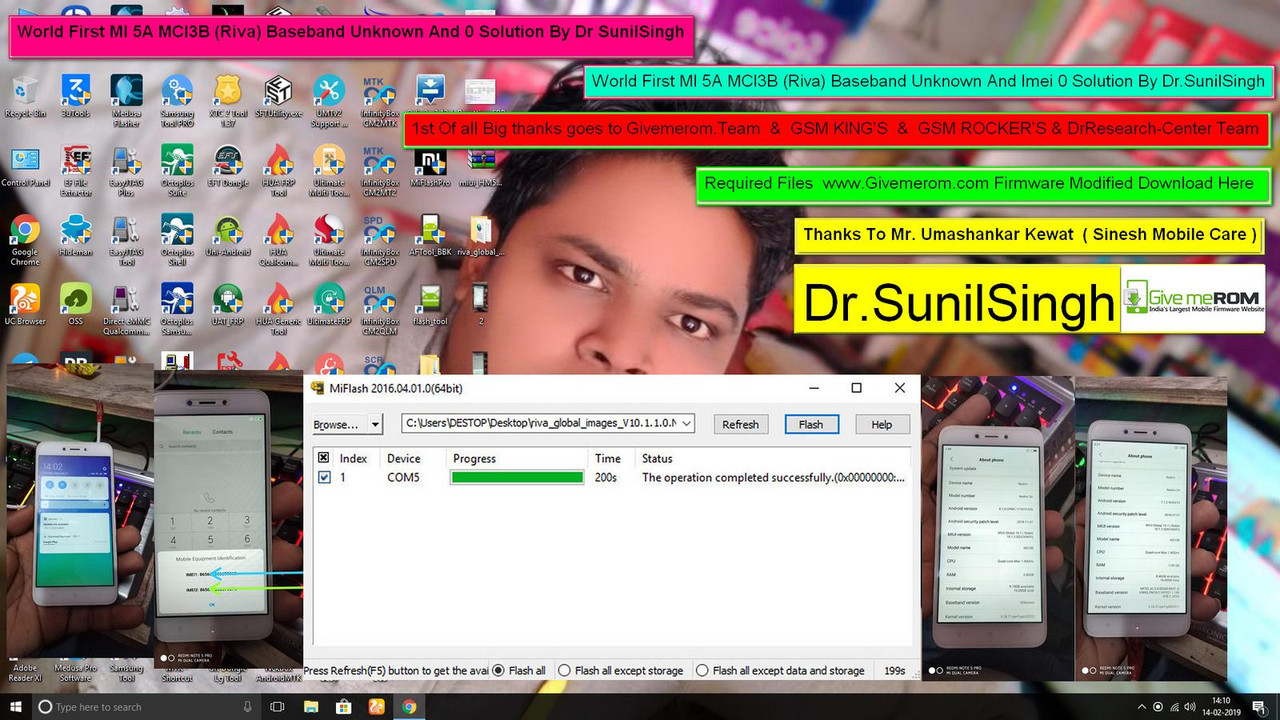

World First MI 5A MCI3B (Riva) Baseband Unknown And 0 Solution By Dr SunilSingh
World First MI 5A MCI3B (Riva) Baseband Unknown And Imei 0 Solution By Dr.SunilSingh
1st Of all Big thanks goes to Givemerom.Team & GSM KING'S & GSM ROCKER'S & DrResearch-Center Team
Required Files: www.Givemerom.com
3914
* Flash Tool Download Here
* Firmware Modified Download Here
Thanks To Mr. Umashankar Kewat ( Sinesh Mobile Care )
* Firmware Og Download Here
* Qcn Og Download Here
Password. ( Mi 5A MCI3A.By.Dr.sunilsingh )
3913
Thanks To . DrResearch-Center
Procedure:
Use This Method @ Your Own Risk We Are Not Responsible If You Brick Your Device Using This Method
1. Connect Your Device In Edl Mode
2. Now Run Flash Tool And Load Modified Firmware And Flash
3. After Success Modified Firmware Flashing
4. Enable Diag Port Dial ##13491##
4. Now Run Qpst Tool And Load Qcn And Start
5. After Success Qcn Writing Restart Phone And Check
IF U FACE GET SIGNAL AND WIFI PROBLEM
6.Now Run Flash Tool And Load OG Firmware And Flash
SUCCESSFUL DONE YOUR PHONE
