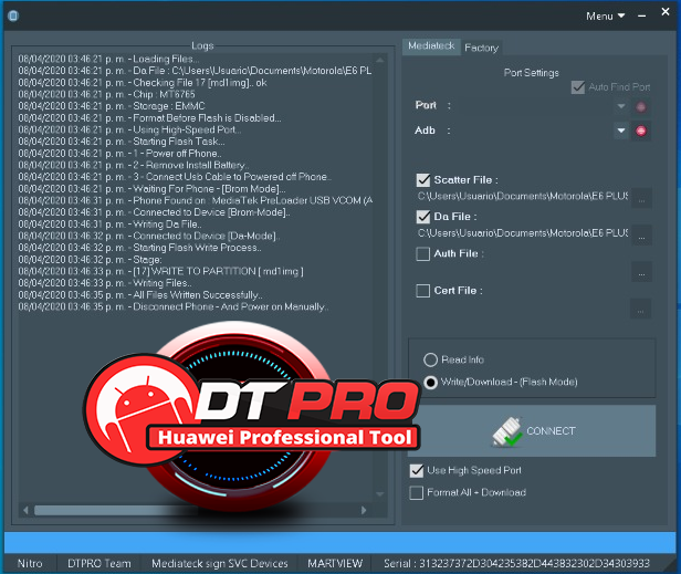

Motorola E6 plus XT2025-1 Writing Engineer MODEM For repair IMEI Success (32GB Version)
DTPRO Tool
Sep 3, 2018
5,170
4,788
nico_2202
08/04/2020 03:46:21 p. m. - Loading Files...
08/04/2020 03:46:21 p. m. - Da File : C:\Users\Usuario\Documents\Motorola\E6 PLUS\Motorola Moto E6 Plus (XT2025-1) 32GB\DA_SWSEC_1848_PTA29.62.bin
08/04/2020 03:46:21 p. m. - Checking File 17 [md1img].. ok
08/04/2020 03:46:21 p. m. - Chip : MT6765
08/04/2020 03:46:21 p. m. - Storage : EMMC
08/04/2020 03:46:21 p. m. - Format Before Flash is Disabled...
08/04/2020 03:46:21 p. m. - Using High-Speed Port...
08/04/2020 03:46:21 p. m. - Starting Flash Task...
08/04/2020 03:46:21 p. m. - 1 - Power off Phone..
08/04/2020 03:46:21 p. m. - 2 - Remove Install Battery..
08/04/2020 03:46:21 p. m. - 3 - Connect Usb Cable to Powered off Phone..
08/04/2020 03:46:21 p. m. - Waiting For Phone - [Brom Mode]...
08/04/2020 03:46:31 p. m. - Phone Found on : MediaTek PreLoader USB VCOM (Android) (COM15)
08/04/2020 03:46:31 p. m. - Connected to Device [Brom-Mode]..
08/04/2020 03:46:31 p. m. - Writing Da File..
08/04/2020 03:46:32 p. m. - Connected to Device [Da-Mode]..
08/04/2020 03:46:32 p. m. - Starting Flash Write Process..
08/04/2020 03:46:32 p. m. - Stage:
08/04/2020 03:46:33 p. m. - [17] WRITE TO PARTITION [ md1img ]
08/04/2020 03:46:33 p. m. - Writing Files..
08/04/2020 03:46:35 p. m. - All Files Written Successfully..
08/04/2020 03:46:35 p. m. - Disconnect Phone - And Power on Manually..
