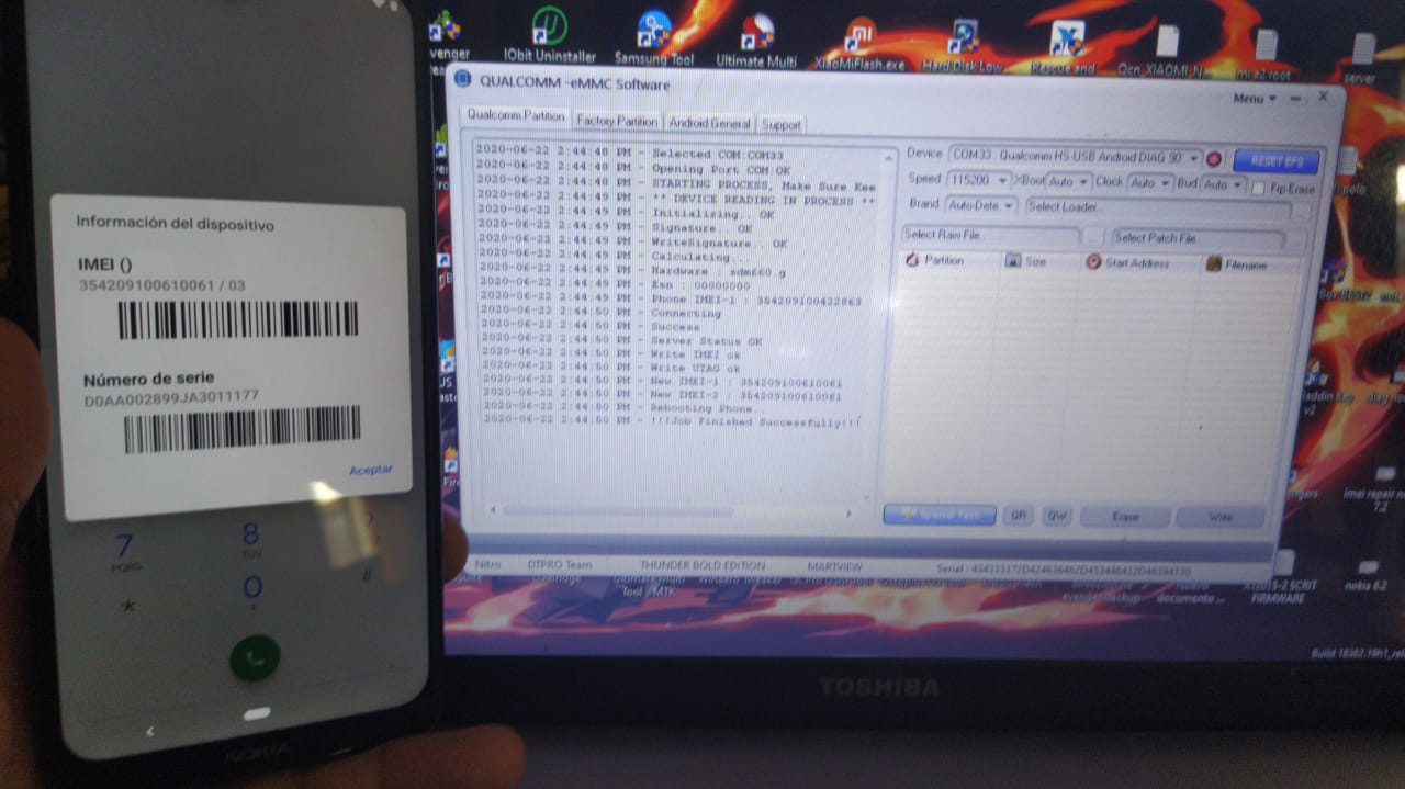

Nokia 6.2 Direct IMEI repair Success!! (thanks to Quimera from colombia by test report)
DTPRO Tool
Sep 3, 2018
5,296
4,915
nico_2202
2020-06-22 2:44:48 PM - Selected COM:COM33
2020-06-22 2:44:48 PM - Opening Port COM:OK
2020-06-22 2:44:48 PM - STARTING PROCESS, Make Sure Keep Phone Screen UNLOCKED!!
2020-06-22 2:44:49 PM - * DEVICE READING IN PROCESS *
2020-06-22 2:44:49 PM - Initializing.. OK
2020-06-22 2:44:49 PM - Signature.. OK
2020-06-22 2:44:49 PM - WriteSignature.. OK
2020-06-22 2:44:49 PM - Calculating...
2020-06-22 2:44:49 PM - Hardware : sdm660.g
2020-06-22 2:44:49 PM - Esn : 00000000
2020-06-22 2:44:49 PM - Phone IMEI-1 : 354209100422863
2020-06-22 2:44:50 PM - Connecting
2020-06-22 2:44:50 PM - Success
2020-06-22 2:44:50 PM - Server Status OK
2020-06-22 2:44:50 PM - Write IMEI ok
2020-06-22 2:44:50 PM - Write UTAG ok
2020-06-22 2:44:50 PM - New IMEI-1 : 354209100610061
2020-06-22 2:44:50 PM - New IMEI-2 : 354209100610061
2020-06-22 2:44:50 PM - Rebooting Phone..
2020-06-22 2:44:50 PM - !!!Job Finished Successfully!!!

1 downgrade to this version which allows to unlock the bootloader free on cmd without problems
HMDSW_Daredevil_N-7.2-00WW_1_200_B01_user
2 then unlock the bootloader in fastboot
3 then you rotate with the same boot with magisk
despues habilitas diag y reparas con dt pro directo sin wipear efs
