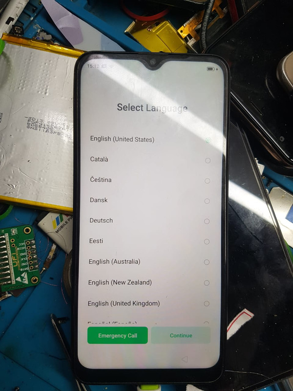

modal = oppo A1k password not resat

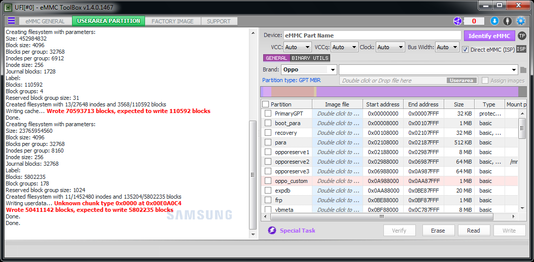

restart after prosses
Factory Reset...
Creating filesystem with parameters:
Block size: 4096
Blocks per group: 32768
Inodes per group: 6912
Inode size: 256
Journal blocks: 1728
Label:
Blocks: 110592
Block groups: 4
Reserved block group size: 31
Created filesystem with 13/27648 inodes and 3568/110592 blocks
Writing cache... Wrote 70593713 blocks, expected to write 110592 blocks
Done.
Block size: 4096
Inodes per group: 8160
Inode size: 256
Journal blocks: 32768
Label:
Blocks: 5802235
Block groups: 178
Reserved block group size: 1024
Created filesystem with 11/1452480 inodes and 135204/5802235 blocks
Writing userdata... Unknown chunk type 0x0000 at 0x00E0A0C4
Wrote 50411142 blocks, expected to write 5802235 blocks
Done.
Done.

Oppo A1k after formatting ,only connects as mediatek port -phone not powering,please assist.
