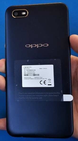

Help oppo A1k dead after wipe user data and remove frp
recan21
Aug 2, 2019
87
21
Selected eMMC Interface
Z3X EasyJtag Software ver. 3.6.1.15
Loading eMMC GEN1 Firmware... IO: 2800 mV
Box S/N: 0707071F24C202D1, ,FW Ver.: 01.63
CMD Pullup Level:2010 mV
CMD Active Level:2660 mV
Box IO Level:2800 mV
CLK Rate:14000 kHz
Bus Width:1bit,SDR
HiPower mode is off!
---------- eMMC Device Information ----------
eMMC CID : 150100514436334D4203464BD8E01682
eMMC CSD : D02701320F5903FFF6DBFFEF8E40400C
eMMC Manufacturer ID: 0015 , OEM ID: 0100
eMMC Date: 01/2019  Rev.0x3
eMMC NAME: QD63MB , S/N: 1179375840
eMMC NAME (HEX): 514436334D42
EMMC ROM1 (Main User Data)   Capacity: 29820 MB , 0x3A3E000 pages , 0x747C00000 bytes
EMMC ROM2 (Boot Partition 1) Capacity: 4096 kB
EMMC ROM3 (Boot Partition 2) Capacity: 4096 kB
EMMC RPMB (Replay Protected Memory Block) Capacity: 16384 kB
EMMC RPMB is programmed and written 568 times
EMMC Permanent Write Protection: No
EMMC Temporary Write Protection: No
EMMC Password Locked: No
  Extended CSD rev 1.8 (MMC 5.1)
Boot configuration [PARTITION_CONFIG: 0x48] Boot from:ROM2 (Boot Partition 1)
Boot bus config [177]: 0x02 , width 8bits  , Partition config [179]: 0x48.
H/W reset function [RST_N_FUNCTION]: 0x01
High-capacity WP group size [HC_WP_GRP_SIZE: 0x00004000]
Partitioning Support [PARTITIONING_SUPPORT]: 0x07
 Device support partitioning feature
 Device can have enhanced tech.
Partitioning Setting [PARTITION_SETTING_COMPLETED]: 0x00
Found valid GPT with protective MBR; using GPT.
Real (Hardware) Disk/Image size: 3A3E000 sectors 29.1 GiB
Soft (Partitioned) Disk/Image size: 3A3DFBC sectors 29.1 GiB
Disk identifier (GUID): 00000000-0000-0000-0000-000000000000
Logical sector size: 0x200  bytes ,First/Last usable sector: 34,61071326
Partition info successfully found
------ Android information ------
Detected (Android Userdata) USERDATA : 0x01BB800000 (22.132GB)
Erasing...
Done.
Detected (Android Cache)) CACHE : 0x01A0800000 (432.0MB)
Erasing...
Done.
Done.
help !
