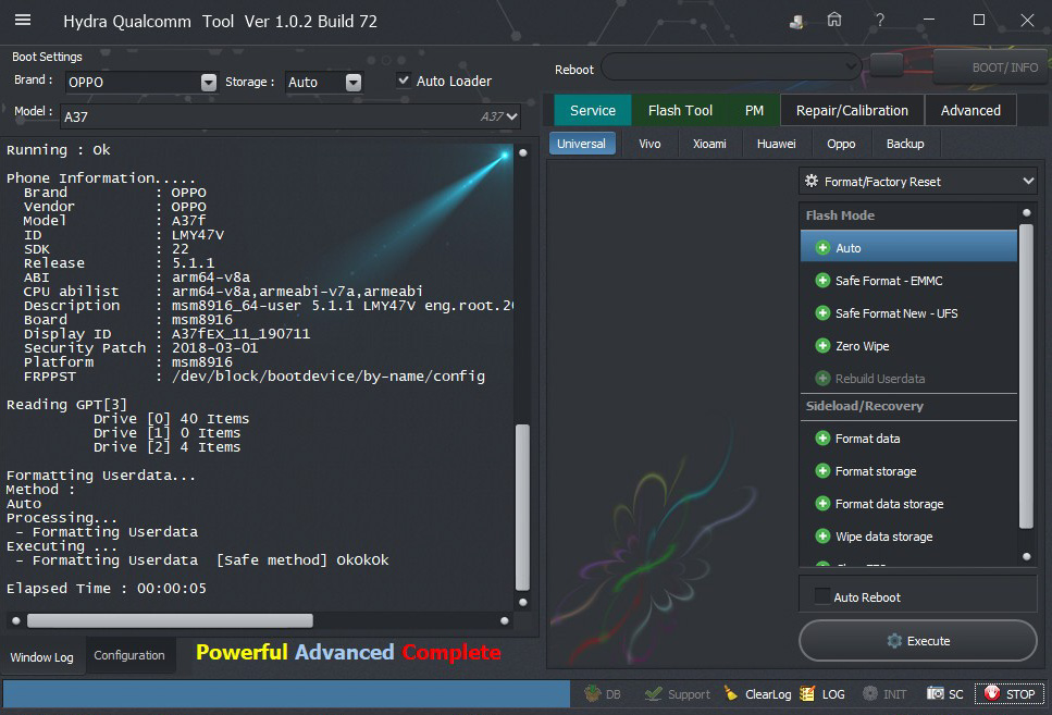

Hydra Oppo A37 Safe Format user data successfully Done by Hydra Tool
543
PreOperation Configuration
Brand : OPPO Model : A37 Storage : Auto
Loader: 8916.mbn
Port : Auto
Connection :
FriendlyName :Qualcomm HS-USB QDLoader 9008 (COM23)
SymbolicName :\??\USB#VID_05C6&PID_9008#5&15c311e1&0&1#{a5dcbf10-6530-11d2-901f-00c04fb951ed}
Driver Ver :08/31/2015,2.1.2.0
Getting device info.....
Serial No.: 0x25DD2BA9
MSM ID : 0x007050E1, MSM8916-Qualcomm Snapdragon 410
PBL Ver : 00000000
PK HASH : CC3153A80293939B90D02D3BF8B23E02
92E452FEF662C74998421ADAD42A380F
Firehose Loader[8916.mbn]
SaharaBoot... Ok
Sending .....Ok
Connecting to Firehose...
Ping. Ok
Configuration........
Identifying Chip....
Ok
Chip Configuration :
MemoryName : eMMC
MaxXMLSizeInBytes : 4096
TargetName : 8916
Version : 1
Protocol : Universal
Running : Ok
Phone Information.....
Brand : OPPO
Vendor : OPPO
Model : A37f
SDK : 22
Release : 5.1.1
ABI : arm64-v8a
Description : msm8916_64-user 5.1.1 LMY47V eng.root.20190711.032745 release-keys
Board : msm8916
Display ID : A37fEX_11_190711
Security Patch : 2018-03-01
Platform : msm8916
Reading GPT[3]
Drive [0] 40 Items
Drive [1] 0 Items
Drive [2] 4 Items
Formatting Userdata...
Method :
Auto
Processing...
- Formatting Userdata
Executing ...
- Formatting Userdata [Safe method] OkOkOk
Elapsed Time : 00:00:05
