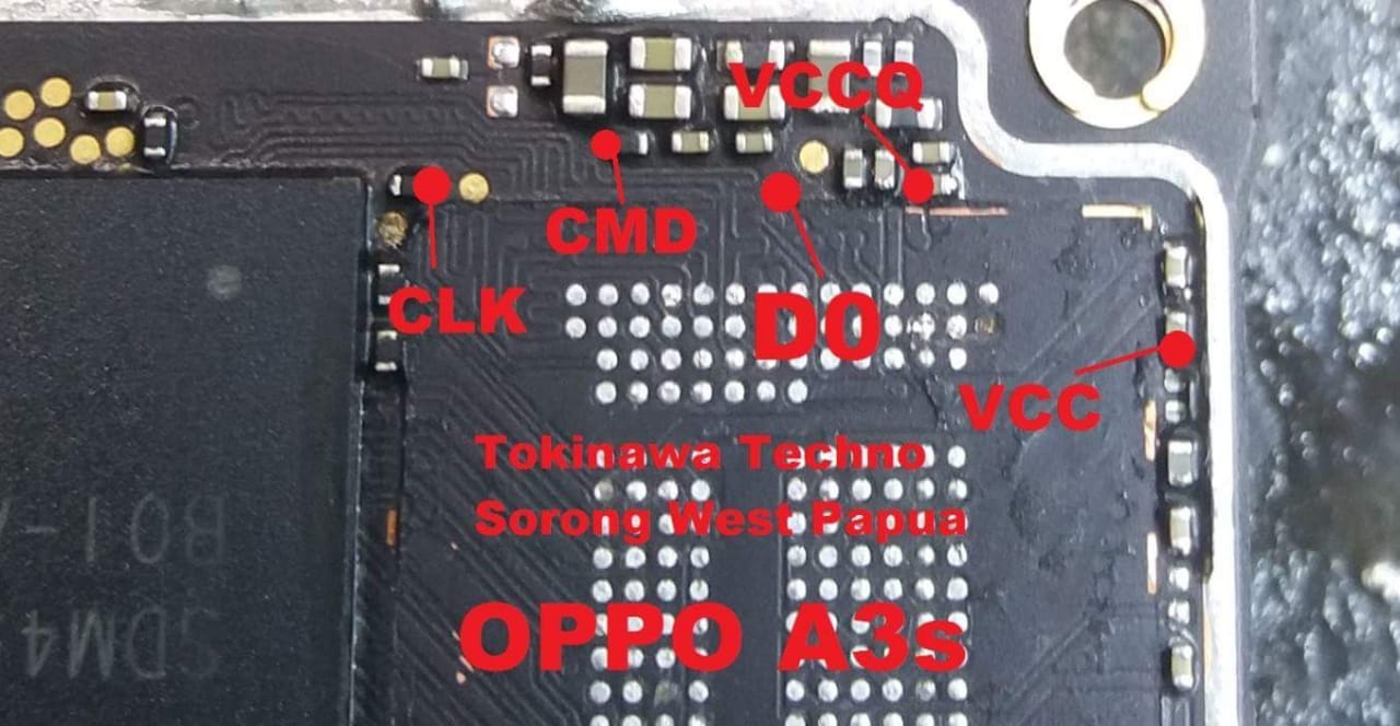

Hello, if you want to Clear User Lock, you can try using ISP method via UFI eMMC ToolBox, use "Factory Reset" under Special Task in User Partition Tab.
Here the ISP Oppo A3S by Tokinawa, credit to him.
Oppo A3s Remove Pattern lock | Oppo A3s Remove User Lock | Oppo A3s FRP Lock Reset | Oppo A3s Remove Google Account
will this also remove google lock / account lock?
