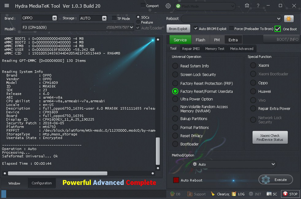

Oppo F3 (CPH 1609) Safe format universal done by Hydra Tool
1. Run MTK module
2. Go to "Service"--> "Factory Reset (FRP) / Format User Data"
3. Choose "Auto" from Method / Option
4. Click "Execute"
5. Connect device with computer with USB data cable.
6. Wait until the operation is completed.
4. Click "Execute"
BR==============================
FriendlyName :MediaTek USB Port_V1632 (COM11)
SymbolicName :\??\USB#VID_0E8D&PID_0003#6&868c983&0&1#{a5dcbf10-6530-11d2-901f-00c04fb951ed}
Handshaking...Ok
Identifying Hardware ID.....
BROM CPUID : 0326MT6750T[6755]
BROM HW_SW_VER : 8A00 CB00 0001 0000
getMTKPayloadExploit : 0326
#Executing Exploit..
#SUCCESS..
Handshaking...Ok
FUSEID : 41140000
SECURE VERSION : 00
BL VERSION : FE
BR Secured : 00
NORMAL BOOT
Preparing Download Agent..
DA : 6755_SWSEC_D36514C0DE.bin
Ver : MTK_AllInOne_DA_v3.3001.00.00
Init : Loader [1]
Sending : Accepted
Identifying Protocol...
Protocol : New
Synchronization...SYNC
Mode : brom
Preloader Initialization...
Parsing preloader_oppo6750_16391.bin
Init : Accepted
Execute Secondary Loader
Init : Loader [2]
Executing : SYNC
UNIQUE ID : 585E24139EAF4E8B44E099215AFDE024
IRAM Size : 0x0000000080000000 -2 GB
eMMC CID : 150100524836344D4205AE1FC6513449 - RH64MB
DA Speed :
Change to HIGH SPEED...
Port Identification :DA_HIGHSPEED_VCOM
FriendlyName :MediaTek DA USB VCOM (Android) (COM10)
SymbolicName :\??\USB#VID_0E8D&PID_2001#6&868c983&0&1#{a5dcbf10-6530-11d2-901f-00c04fb951ed}
Reading System Info
Brand : OPPO
Vendor : OPPO
Model : CPH1609
SDK : 23
Release : 6.0
ABI : arm64-v8a
Locale : en-US
Description : full_oppo6750_16391-user 6.0 MRA58K 1551111655 release-keys
Device : CPH1609
Board : full_oppo6750_16391
Display ID : CPH1609EX_11_A.25_190225
Security Patch : 2018-06-05
Platform : mt6750
FRPPST : /dev/block/platform/mtk-msdc.0/11230000.msdc0/by-name/frp
StorageType : mtp,mass_storage
Userdata State : Encrypted
Autobackup Partitions
-> Renaming Preloader.... preloader_oppo6750_16391.bin
Creating Scatter file... C:\Hydra Tool\\Backup\Auto\0326__042521164936\MT6750T_Android_scatter.txt
-frp[0x06F88000]1024 KB ->frp.bin...Ok
-persist[0x07088000]48 MB ->persist.bin...Ok
-nvdata[0x0A088000]32 MB ->nvdata.bin...Ok
-nvram[0x12F00000]5 MB ->nvram.bin...Ok
Done!!!
Reading System Info
Brand : OPPO
Vendor : OPPO
Model : CPH1609
SDK : 23
Release : 6.0
ABI : arm64-v8a
Locale : en-US
Device : CPH1609
Platform : mt6750
Operation : Auto
Processing...
Safeformat Universal... Ok
Elapsed Time : 00:00:44
