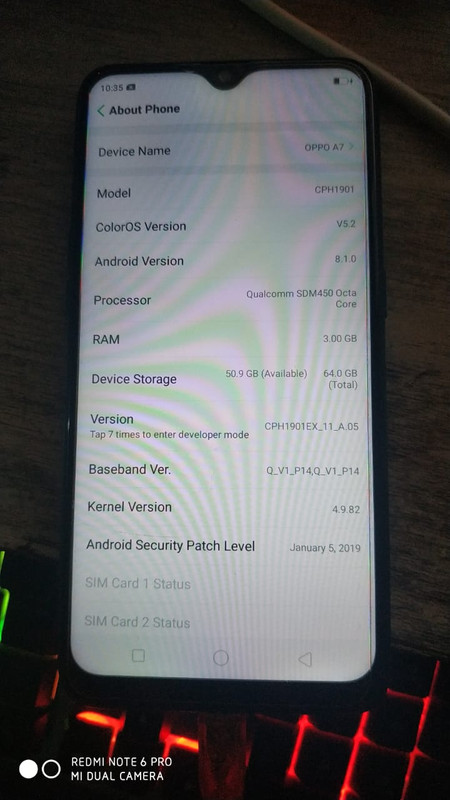

Oppo A7 ( CPH1901 ) Remove Userlocks+Frp Lock Done Without Any Risk Of Stuck On Logo All Job Successfully Done Ufi-Box Only

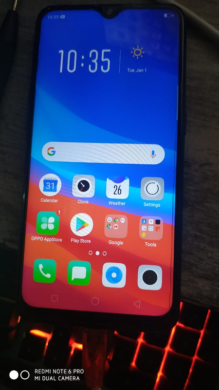

OPPO A7X CPH1903 PASSWORD REMOVE AND FRP DONE

Factory Reset...
Creating filesystem... Done.
Writing cache... Done.
Writing userdata... Done.
Done.

Clear FRP Lock... Done.

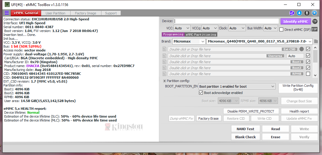

Sending firehose loader... Done.
Handshaking...
Sending ping... Done.
Sending configurations...
TargetName: 8953
MemoryName: eMMC
Version: 1
Firehose configured.
Storage type: eMMC
Product name: RH64AB (0x524836344142), rev: 0x05, serial number: 0x6D59D814
Capacity: 58.25 GiB(62,549,655,552 bytes)
Boot1: 4096 KiB
Boot2: 4096 KiB
RPMB: 4096 KiB
User area: 58.24 GiB(62,537,072,640 bytes)
platform: msm8953, cpu abi: arm64-v8a
manufacturer: vivo
board: msm8953, name: PD1708F_EX
brand: vivo, model: vivo 1716
build id: N2G47H, version: 7.1.2 Nougat (N2G47H release-keys)
build description: msm8953_64-user 7.1.2 N2G47H eng.compil.20180528.223559 release-keys

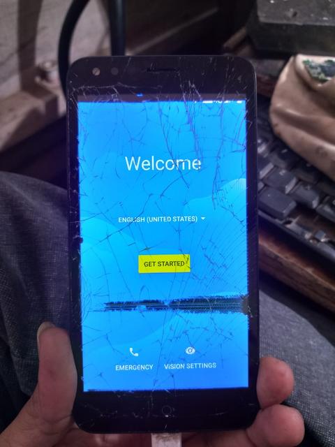

redmi s2 frp done
Scanning for Qualcomm HS-USB QDLoader 9008 device...
Download Port: Qualcomm HS-USB QDLoader 9008 (COM51)
Connection status: XHCI:HUB3:USB 2.0 High-Speed
USB Driver: [Qualcomm Incorporated] qcusbser, version: 2.1.2.7, date: 8-2-2017
Initializing...
MSM Serial number: 0xfc2e7e88
MSM HW ID: 0x000460e1 (MSM8953)
OEM Public Key Hash: 0x57158eaf1814d78fd2b3105ece4db18a817a08ac664a5782a925f3ff8403d39a
SBL SW version: 1
Firehose: prog_emmc_firehose_8953_ddr[1].mbn
sha1: c8c70e280ecf388e1ba42387268782cac92302a5, size: 366.35 KiB
QC_IMAGE_VERSION: BOOT.BF.3.3-00228
IMAGE_VARIANT: JAADANAZA
OEM_IMAGE_VERSION: c3-bsp-builder-job004.bj
Handshaking...
TargetName: 8953
MemoryName: eMMC
Version: 1
Storage type: eMMC
Manufacturer ID: 0x13 (Micron)
Product name: S0J9B7 (0x53304a394237), rev: 0x04, serial number: 0x046BFD7D
Capacity: 29.13 GiB(31,281,119,232 bytes)
Boot1: 4096 KiB
Boot2: 4096 KiB
RPMB: 4096 KiB
User area: 29.12 GiB(31,268,536,320 bytes)
platform: msm8953, cpu abi: armeabi-v7a
manufacturer: Xiaomi
board: ysl, name: ysl
brand: xiaomi, model: Redmi S2
build id: OPM1.171019.011, version: 8.1.0 Oreo (OPM1.171019.011) (MIUI10)
build description: ysl-user 8.1.0 OPM1.171019.011 V10.3.1.0.OEFMIXM release-keys
