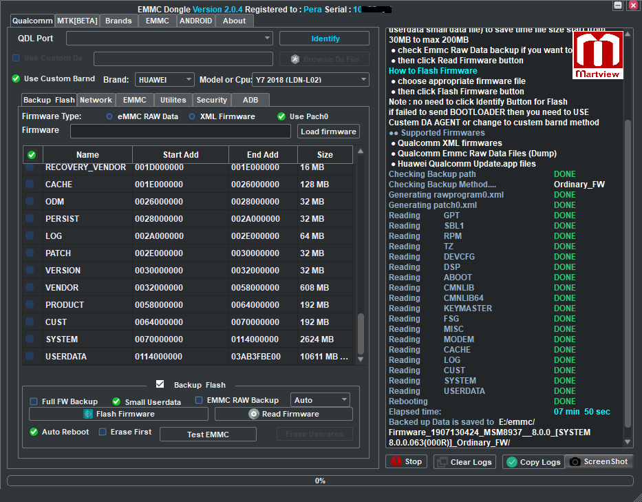

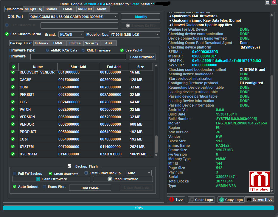

READ FIRMWARE HUAWEI Y7 2018 /LDN-L01/ 8.0 BY EMMC DONGLE
INFO
Waiting For EDL Device        DONE
Checking device communication    DONE
Device connection is being verified    DONE
Checking Qcom Boot Download Agent    Done
Checking device platform         (MSM8937)
SERIAL :    0x00D93038DD
MSMID  :    0x000004F0E1
OEM PK :    0x6bc369511da9cadb3a7af61574f89db3
SW VER :    0x0000000000
Checking send bootloader method    CUSTEM Brand
Sending device bootloader        DONE
Start protocol initialization        DONE
Configuring Firehose protocol    FH configured
Requesting Device partition table    DONE
Loading device partition table    DONE
Parsing device partition table    DONE
Loading Device Information        DONE
Parsing Device Information        DONE
Android Ver        8.0.0
Build Date        1530713814
Build Number        SYSTEM 8.0.0.063(000R)
Inc Ver        ENG.JENKIN.20180704.221654
Region        EU
Sdk Version        26
Vendor        HW
Block Size        512
Emmc Name        HAG4a2
Emmc Size        15027 MB
Fw Version        0
Memory Type        eMMC
Mfr Id        144
Page Size        512
Phy num        3
Serial        3390334471
Total Blocks        30777344
Type        ARM64-V8A
INFO READ

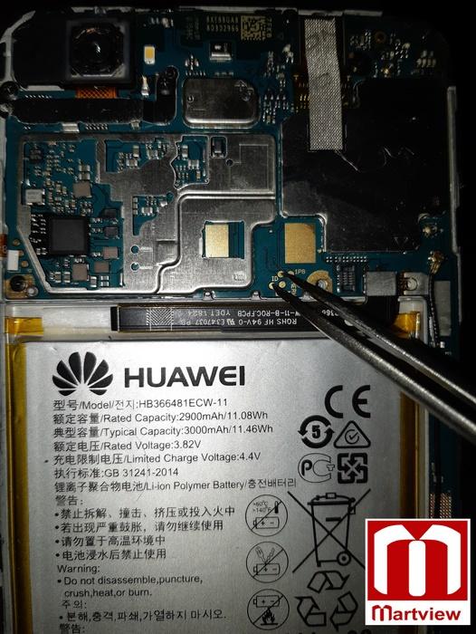

Allah razı olsun. Şükran. I did it on my phone (those two points) but nothing happened. Is it possible to shoot a video. also what is the above program. (HUAWEI LDN-L01 8.0 Y7 2018 BY EMMC DONGLEI) downloaded the folder. Thank you again.

Teşekkürler. Sadece telefonumu EDL moduna geçirmek istiyorum

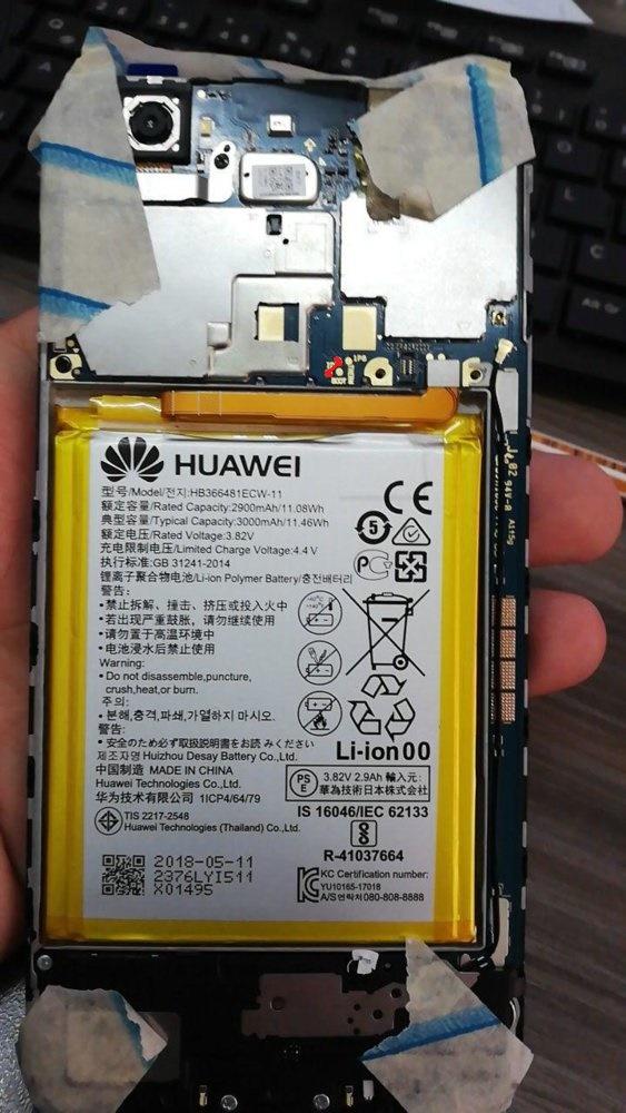

I disconnected the battery cable. I didn't put it back. I made a 2 point chassis. I plugged the cable at the same time. just huaweiii post is going to come.
kendisi
Aug 27, 2019
4
sorry . I dont understand.Do not insert the battery.???? In the picture I made 2 points, the chassis is red.
