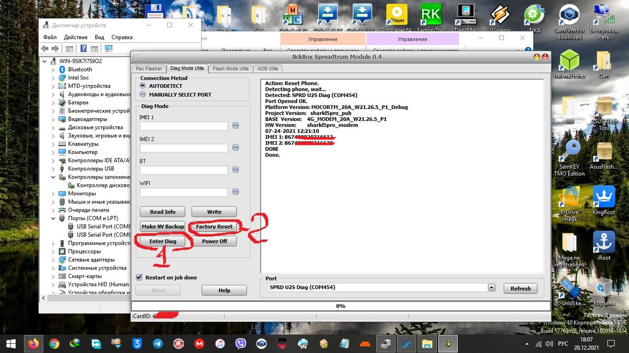

Realme C21Y RMX3261 hardreset with NCK Box SPRD Module v0.4

ACTION: Flash Firmware.
Selected firmware: S19610AA1_ctcc-user-native_SHARKL5PRO_SUPER_R.pac
NV: Default Mode (protect calibration)
Device Storage: EMMC
Start Detect phone...
Long press "VOL -" key and insert usb cable.
For some phones need to
Long press "VOL -"+ "VOL +" key and insert usb cable.
Detected: SCI USB2Serial (COM19)
[00:00:00] Sending loader.
BOOT: SPRD3
Sending loader, keep boot key untill loader start.
[00:00:02] Loader ok
[00:00:02] Wait for loader....
Loader OK: ~"Spreadtrum Boot Block version 1.1
Changing bautrate OK.
[00:00:03] [1]First boot done.
[00:00:03] Sending second loader.
[00:00:09] Second loader sent ok.
New flash protocol detected.
[00:00:09] Reading: system
Error while read flash(1).
[00:00:29] Reading: super
System name: super
Phone and firmware have same android
[00:00:29] Reading: miscdata
[00:00:29] Reading: l_fixnv1_a
NVRAM saved to: C:\Users\wan\Documents\spreadtrum_module\flashmode_nvram_backup\_867400020316612_11\_867400020316612_nvram_backup.tar
Phone have super partition.
[00:00:39] Making flash ic repartition.
[00:00:39] Start write: l_fixnv1_a
Protecting GSM_CALI_ITEM_ID id: 0x2
Protecting LTE_Calibration id: 0xA05
Protecting LTE_Cali_Band1 id: 0x9C4
Protecting LTE_Cali_Band2 id: 0xA04
Protecting LTE_Cali_Band3 id: 0x9C8
Protecting LTE_Cali_Band4 id: 0x9C9
Protecting LTE_Cali_Band5 id: 0x9CA
Protecting LTE_Cali_Band6 id: 0x9CB
Protecting LTE_Cali_Band7 id: 0x9CC
Protecting LTE_Cali_Band8 id: 0x9CD
Protecting LTE_Cali_Band9 id: 0x9CE
Protecting LTE_Cali_Band10 id: 0x9CF
Protecting LTE_Cali_Band11 id: 0x9D0
Protecting LTE_Cali_Band12 id: 0x9D1
Protecting LTE_Cali_Band13 id: 0x9D2
Protecting LTE_Cali_Band14 id: 0x9D3
Protecting LTE_Cali_Band15 id: 0x9D4
Protecting LTE_Cali_Band16 id: 0x9D5
Protecting LTE_Cali_Band17 id: 0x9D6
Protecting LTE_Cali_Band18 id: 0x9D7
Protecting LTE_Cali_Band19 id: 0xA01
Protecting LTE_Cali_Band20 id: 0xA02
Protecting LTE_Cali_Band21 id: 0xA08
Protecting LTE_Cali_Band22 id: 0xA09
Protecting LTE_Cali_Band23 id: 0xA0A
Protecting W_Calibration id: 0x12D
Protecting C_Calibration id: 0x133
Protecting AFC id: 0x9C7
Protecting GSM_Agc_Cali id: 0x4
Protecting PMIC_AFC_CALI id: 0xA3C
Protecting SIMLOCK_SIGN id: 0x1A3
Protecting SIMLOCK_PK id: 0x1A4
Protecting SIMLOCK_CUSTOMIZE_DATA id: 0x1F0
Protecting SIMLOCK_USER_DATA id: 0x1F1
Protecting SIMLOCK_NVCONTROL_KEY id: 0x1F2
Protecting SIMLOCK_KEY id: 0x1F4
Protecting SIMLOCK_CFG id: 0x7E4
Protecting SUBSIDY_BLOB id: 0x91B
Protecting SUBSIDY_PUBKEY id: 0x91D
Protecting SECURITY_DATA_PK id: 0x91E
Protecting SECURITY_DATA_SIGN id: 0x91F
Protecting GSM_rf_8psk_tx_gain_table id: 0xAA3
Protecting MEID1 id: 0x1E5
Protecting MEID2 id: 0x1E6
Protecting NV_CARLIBRATION_CRC id: 0x1AE
Protecting ENGPCBA_DATA id: 0x1CC
Protecting ENIMEI1_DATA id: 0x1CD
Protecting ENIMEI2_DATA id: 0x1CE
[00:00:45] Format: splloader
[00:00:45] [splloader]Format OK.
[00:00:45] Start write: prodnv
[00:00:45] Format: uboot_log
[00:00:45] [uboot_log]Format OK.
[00:00:45] Start write: vbmeta_a
[00:00:45] Start write: vbmeta_system_a
[00:00:45] Start write: vbmeta_system_ext_a
[00:00:45] Start write: vbmeta_vendor_a
[00:00:45] Start write: vbmeta_product_a
[00:00:46] Start write: l_modem_a
[00:00:49] Start write: l_deltanv_a
[00:00:50] Start write: l_ldsp_a
[00:00:53] Start write: l_gdsp_a
[00:00:55] Start write: l_agdsp_a
[00:00:56] Start write: l_cdsp_a
[00:00:56] Start write: pm_sys_a
[00:00:57] Start write: gnssmodem_a
[00:00:57] Start write: wcnmodem_a
[00:00:57] Start write: boot_a
[00:01:06] Start write: dtbo_a
[00:01:08] Start write: super
[emmc_direct]Error write mod: 0000FC08
[4000EC00]writing super wrong responce.
[YAFFS_IMG2]Error Write: Super ,aborting.
Error while writing firmware, aborting.
Exe version: NckBox Spreadtrum Module 2.1.3
Log saved:
C:\Users\wan\Documents\spreadtrum_module\Saved_Logs\_writepac__16.txt
Total Time: 00:03:29
Done.
