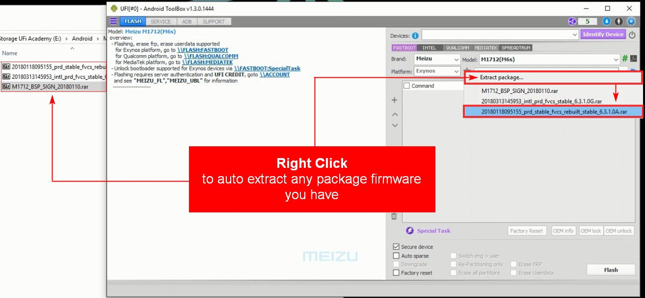

Flashing Meizu M6S (Exynos)

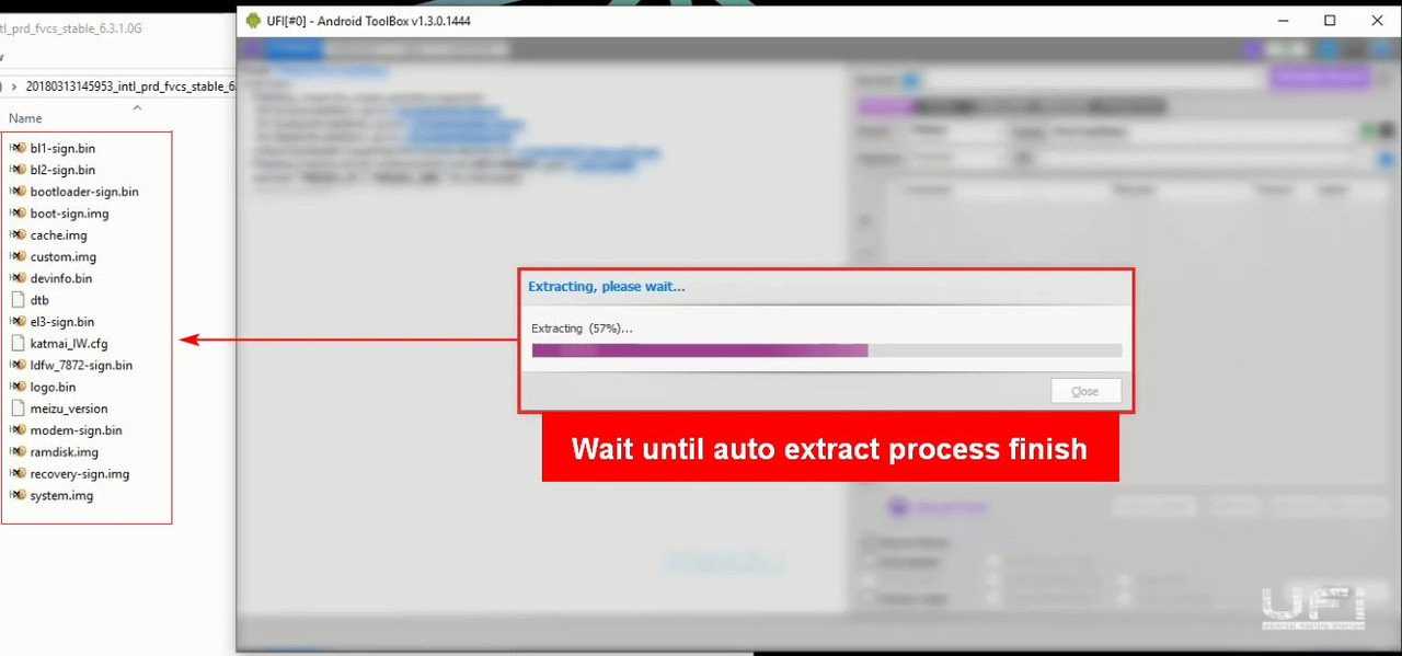

1. Newest and updated stock firmware already available at Support Server
Download, use Right Click to auto extract firmware package

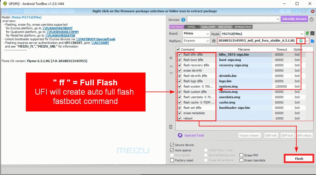

2. After finish extract, now you can re-select model and firmware,
UFI will load the files and create Full Flash fastboot command

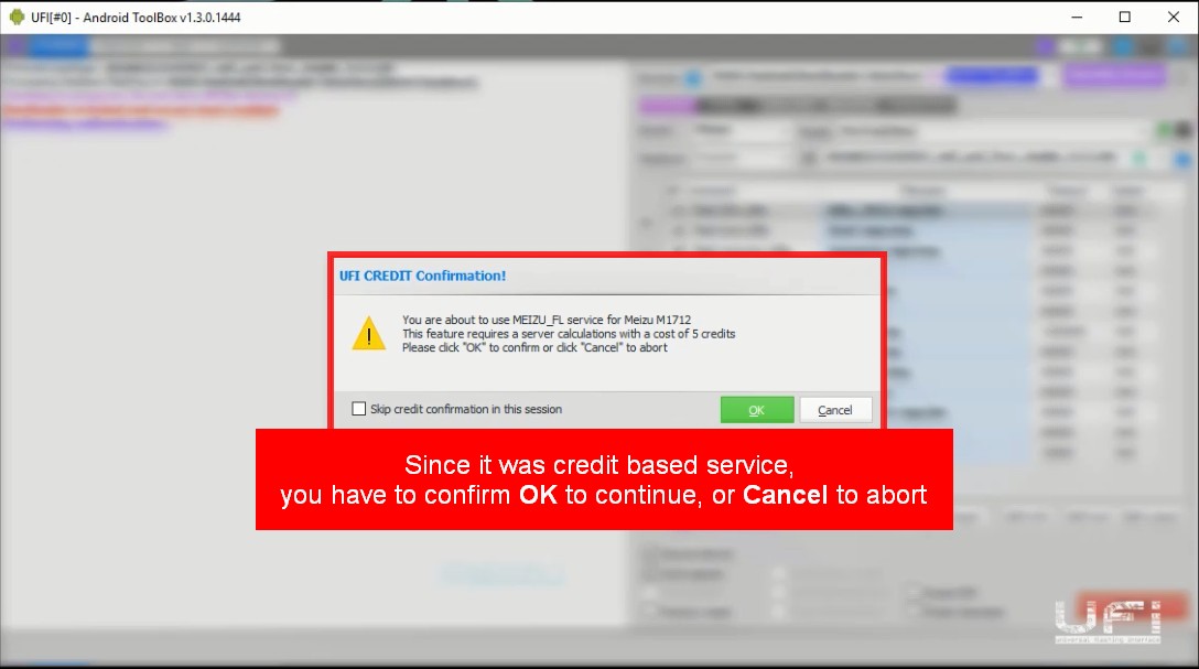

3. UFI CREDIT Confirmation window will appear

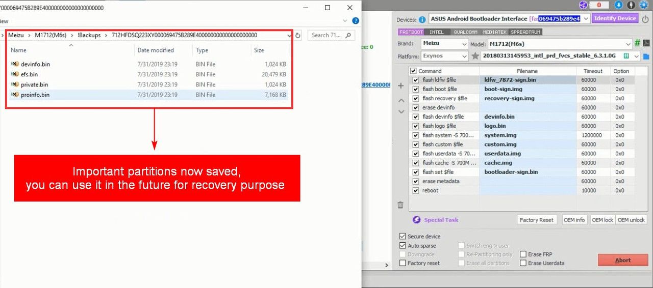

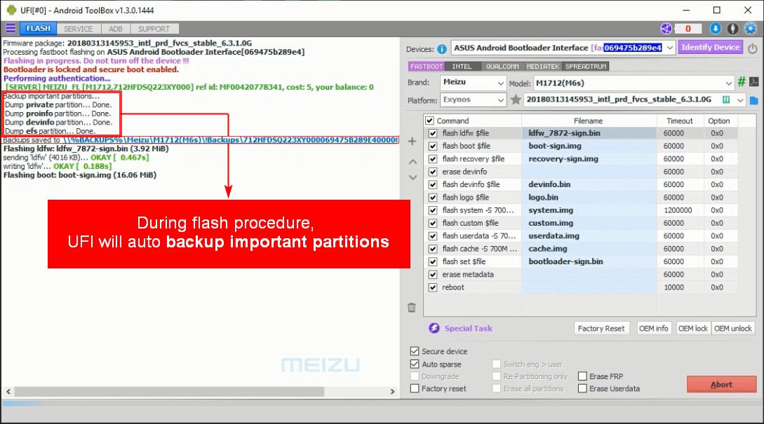

4. Backup Important Partitions
During flashing procedure, UFI will backup unique and important partitions for recovery or later use.

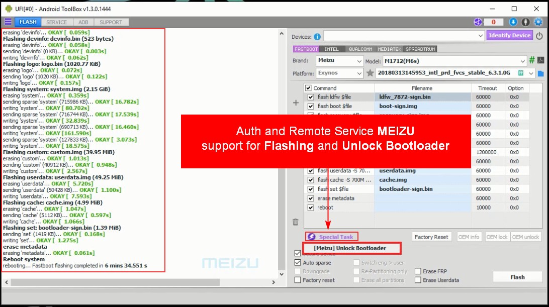

5. Auth and Remote Service MEIZU support for FLASHING and UNLOCK BOOTLOADER via Special Task
