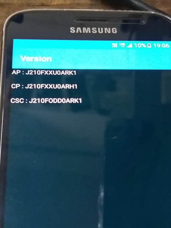

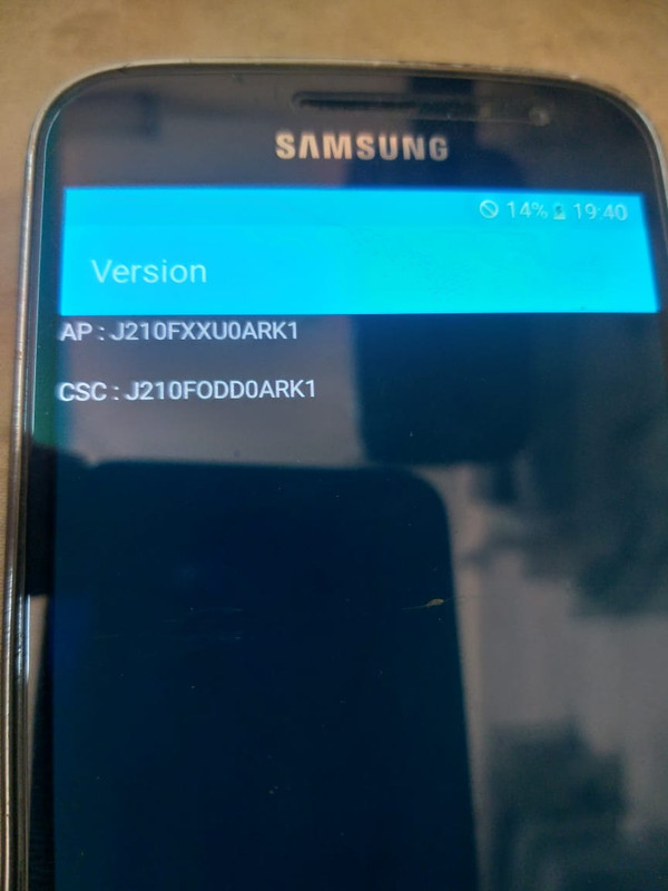

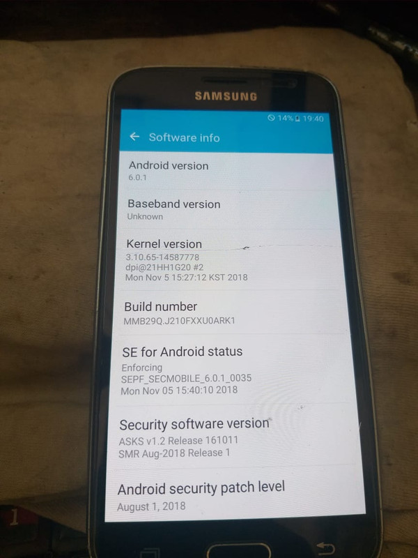

BB Unknown
After Check-*#1234# Cp Info Not Show

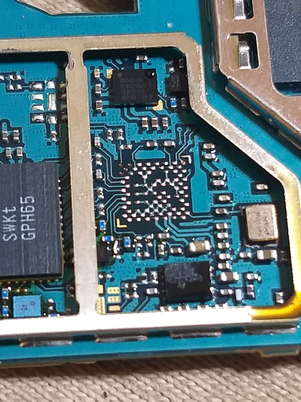

Remove BAseband Ic And Found Some Pads Missing

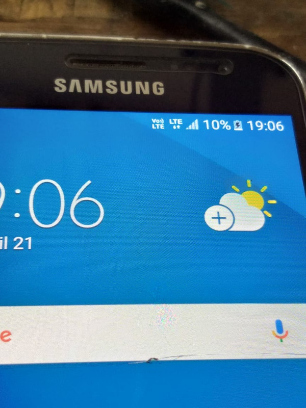

Repair All Pads Micro Jumper Under Ic And Check After- Now Cp Ver. Show On Screen-*#1234#
Congratulation Now HandSet Repair Done
