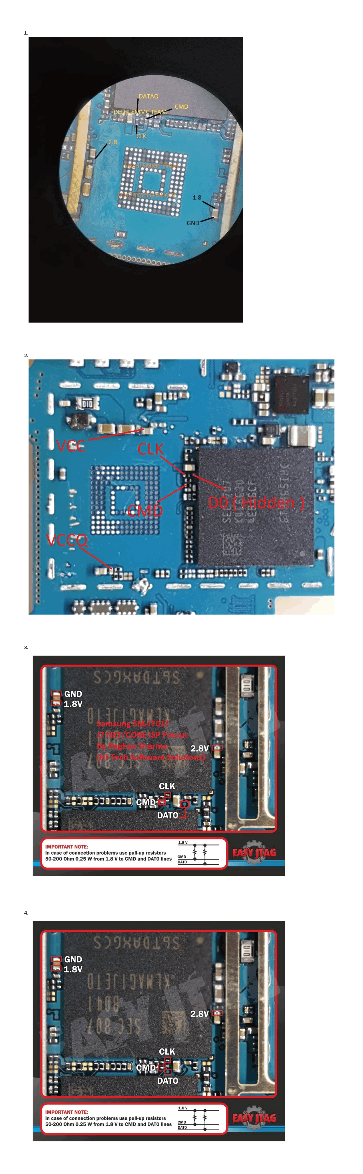

Hello Everyone From Some Days i Doing Try Connect Samsung J701F Via Many eMMC Pinouts But Mobile Still Not Connect & Many Error Coming So Please
Z3X EasyJtag Software ver. 3.6.1.9
Loading eMMC GEN1 Firmware... IO: 2800 mV
Box S/N: 0B0170135E37F259, ,FW Ver.: 01.63
CMD Pullup Level:536 mV
CMD Active Level:2567 mV
Box IO Level:2800 mV
CLK Rate:7000 kHz
Bus Width:1bit,SDR
HiPower mode is off!
Can't init device, Reason: CMD Timeout Error
Done.
Loading eMMC GEN1 Firmware... IO: 3300 mV
CMD Pullup Level:567 mV
CMD Active Level:2877 mV
Box IO Level:3300 mV
CLK Rate:7000 kHz
Bus Width:1bit,SDR
Done.
CMD Pullup Level:2258 mV
CMD Active Level:2846 mV
CLK Rate:7000 kHz
Bus Width:1bit,SDR
Done.
Second Error:
Loading eMMC GEN1 Firmware... IO: 1800 mV
CMD Pullup Level:587 mV
CMD Active Level:1722 mV
Box IO Level:1800 mV
CLK Rate:7000 kHz
Bus Width:1bit,SDR
Can't init device, Reason: OCR Ready Timeout Error [Check VCC or eMMC DEAD]
Done.
CMD Pullup Level:649 mV
CMD Active Level:2536 mV
CLK Rate:7000 kHz
Bus Width:1bit,SDR
Done.
CMD Pullup Level:505 mV
CMD Active Level:2794 mV
CLK Rate:7000 kHz
Bus Width:1bit,SDR
HiPower mode is ON!
Done.
Sir I Was Try All These Pinouts But Mobile Still Not Connect
CLK Rate:7000 kHz
Bus Width:1bit,SDR
Done.
CLK Rate:7000 kHz
Bus Width:1bit,SDR
Done.
CLK Rate:7000 kHz
Bus Width:1bit,SDR
Done.
Second Error:
CLK Rate:7000 kHz
Bus Width:1bit,SDR
Done.
CLK Rate:7000 kHz
Bus Width:1bit,SDR
Done.
CLK Rate:7000 kHz
Bus Width:1bit,SDR
HiPower mode is ON!
Done.
