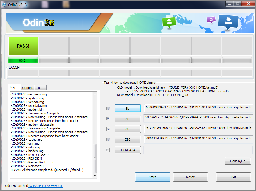

Samsung SM-J600G After Update 9.0 Touch Not Work
Just Downgrade 9.0 To 8.0
(J600GDXU3ARI7_ODM3ARJ1)

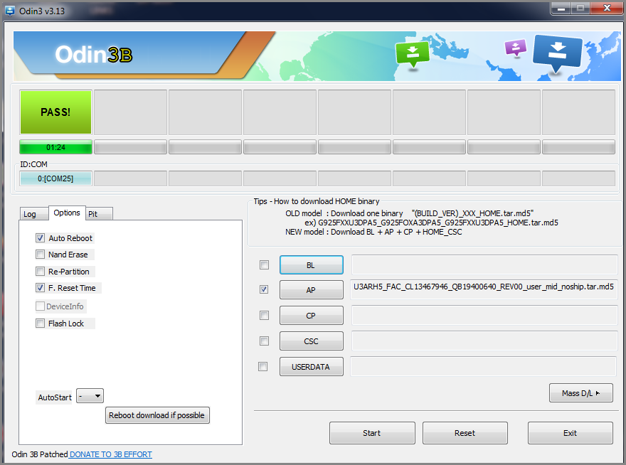

For Frp Reset
Flash With Combination File & Unlock Oem
(COMBINATION_FAC_FA80_J600GDXU3ARH5)

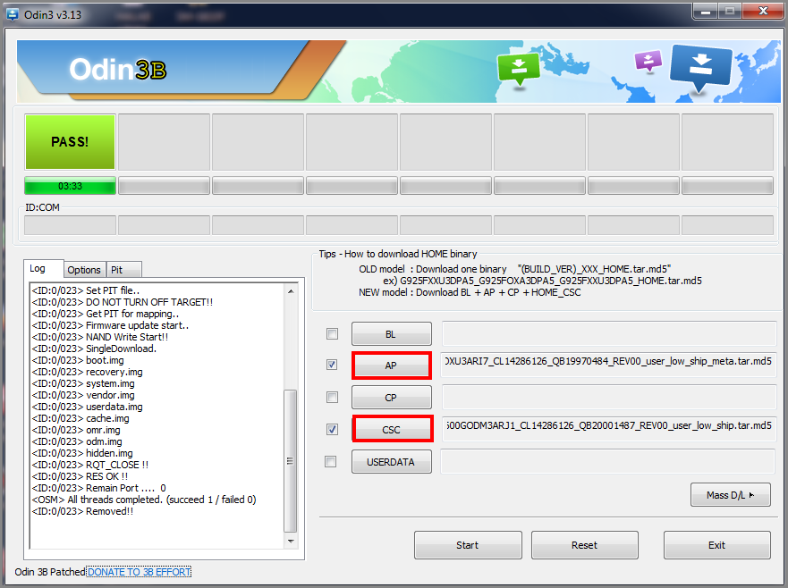

After Flash Combination File & Unlock Oem
Flash Only Ap & Csc Only
Done 100%.....
