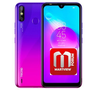

New Tecno Spark 4 Air KC1J Tested MTK Secure boot DA File

Tecno KC1J Run on android 9.0 OS Which is Powered by Mediatek MT6761 Processor. it is a Dual SIM (GSM) Smartphone Support Nano-SIM. Connectivity options include Wi-Fi, GPS, Bluetooth, USB OTG, FM, 3G. The device come with 2GB of RAM and 32GB of Storage can be expandable via SD card.
