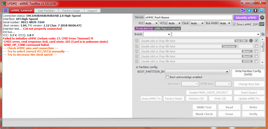

ufi box emmc ips every time show clock not properly connect please solution

1st Reball eMMC Chip Then Put it into UFi eMMC Adapter | Socket and try again it will work 99.99% :up:
IF you are using ISP Pinouts then Use Short Jumper Wires For eMMC Connection
