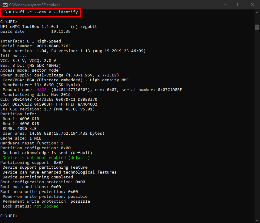

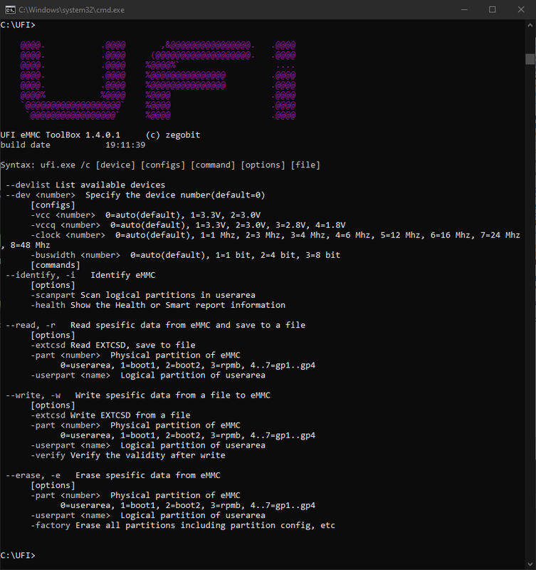

ADD:     Introduced console mode by executing UFI.exe with command line /c
        Syntax : ufi.exe /c [device][config][command]options][file]

wow imagine having this console thing super fast no waiting for UI
i was expecting more work on nokia though and oppo ufs memory
but sofar we really appreciate
