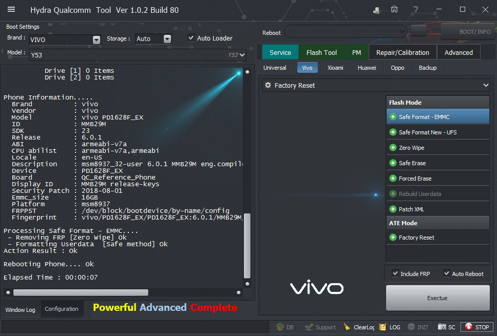

Vivo Y53 FRP Zero Wipe successfully removed by Hydra Tool
1. Run Qualcomm Tool and choose "Sosc"
2. Choose Brand and Module.
3. Go to "Service"--> "Vivo"
4. Choose "Factory Reset" from drop down menu
5. Choose "Safa formet EMMC" from Flash Mode
6. Click on "Execute"
7. Connect device to computer using USB Data Cable.
8. Wait until the operation is completed.

BRPreOperation Configuration
Brand : VIVO Model : Y53 Storage : Auto
Loader: 8917.mbn
Port : Auto
Connection :
FriendlyName :Qualcomm HS-USB QDLoader 9008 (COM17)
SymbolicName :\??\USB#VID_05C6&PID_9008#5&1b10848e&0&6#{a5dcbf10-6530-11d2-901f-00c04fb951ed}
Getting device info......
Serial No.: 0x4DF96731
MSM ID : 0x000560E1, MSM8917-Qualcomm Snapdragon 425
PBL Ver : 00000000
PK HASH : 60BA997FEF6DA9F05885FA11F1DD6D2A
90D052A257A09C2075D7246CC73C0D43
Firehose Loader[8917.mbn]
SaharaBoot... Ok
Sending .................Ok
Connecting to Firehose...
Ping... Ok
Configuration......
Identifying Chip....
Ok
Chip Configuration :
MemoryName : eMMC
MaxXMLSizeInBytes : 4096
TargetName : 8917
Version : 1
*** STORAGE DEVICE INFO ***
Memory Type : eMMC
Block Size in Bytes : 512
Page Size : 512
Manufacturer ID : 144
Serial Number : 929177802
Firmware Version : 165
Product Name : HAG4a2
Physical Partitions : 3
Total Logical Blocks:
Drive [0] 30777344[14.676 GB]
Drive [1] 8192[4 MB]
Drive [2] 8192[4 MB]
Protocol : Universal
Running : Ok
Reading GPT[3]
Drive [0] 52 Items
Drive [1] 0 Items
Drive [2] 0 Items
Phone Information.....
Brand : vivo
Vendor : vivo
Model : vivo PD1628F_EX
SDK : 23
Release : 6.0.1
ABI : armeabi-v7a
Locale : en-US
Description : msm8937_32-user 6.0.1 MMB29M eng.compiler.20190105.211334 release-keys
Device : PD1628F_EX
Board : QC_Reference_Phone
Display ID : MMB29M release-keys
Security Patch : 2018-08-01
Emmc_size : 16GB
Platform : msm8937
Fingerprint : vivo/PD1628F_EX/PD1628F_EX:6.0.1/MMB29M/compiler01052117:user/release-keys
Processing Safe Format - EMMC....
- Removing FRP [Zero Wipe] Ok
- Formatting Userdata [Safe method] Ok
Action Result : Ok
Rebooting Phone.... Ok
Elapsed Time : 00:00:07
