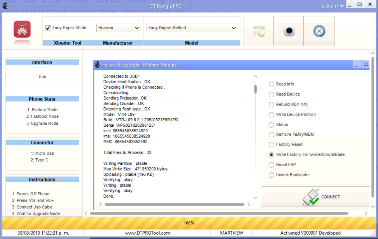

VTR-L09 9.0.1.205(C521E6R1P8) with Bootloader Reseted - DownGrade Success...
DTPRO Tool
Sep 3, 2018
5,221
4,858
nico_2202
Selected interface: USB (KIRIN)
Checking USB driver status...OK (Kirin Flash Device 2.01.02.00)
Plug USB cable
Connected to USB1
Device identification...OK
Comunicating..
Sending Preloader...OK
Sending IDloader...OK
Detecting flash type...OK
Model : VTR-L09
Build : VTR-L09 9.0.1.205(C521E6R1P8)
Serial WPG0218202001231
Imei 865545038524920
Imei 1865545038524920
MEID 86554503852492
Total Files to Process : 33
Writing Partition : ptable
Max Write Size : 471859200 bytes
Uploading : ptable [196 KB]
Verifying.. okay
Writing : ptable
Verifying.. okay
Done..

Shutting down device...OK
Operation completed successfully. You can disconnect the phone now
FINISHED
