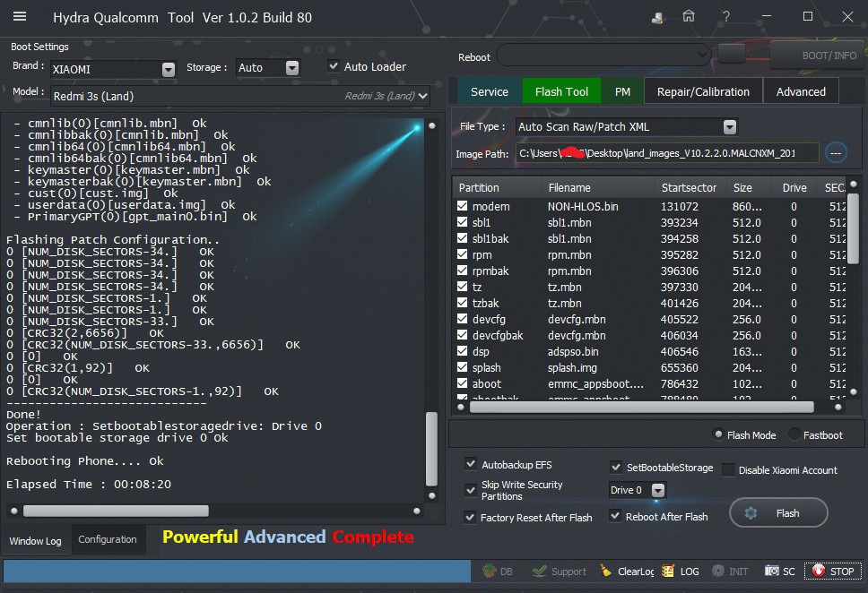

Xiaomi Redmi 3S (Land) Successfully Flashed by Hydra Tool
1. Run Hydra Qualcomm Module and Sosc.
2. Choose Brand and Module.
3. Go to "Flash Tool" Tab.
4. Choose Flash file and its location.
5. Click on "Flash"
6. connect device to the computer with USB Data cable
7. Wait until the process is completed.
5. Click on "Flash"
BRSearching for Qualcomm 9008 Device...Found
FriendlyName :Qualcomm HS-USB QDLoader 9008 (COM4)
SymbolicName :\??\USB#VID_05C6&PID_9008#5&3478949&0&1#{a5dcbf10-6530-11d2-901f-00c04fb951ed}
Driver Ver :08/31/2015,2.1.2.0
Getting device info......
Serial No.: 0x00E7DB3E
MSM ID : 0x0004F0E1, MSM8937-Qualcomm Snapdragon 430
PBL Ver : 00000000
Firehose Loader[mi_1_7.mbn]
SaharaBoot... Ok
Sending .....................Ok
Connecting to Firehose...
Ping... Ok
Configuration......
Identifying Chip....
Ok
Chip Configuration :
MemoryName : eMMC
MaxXMLSizeInBytes : 4096
TargetName : 8937
Version : 1
*** STORAGE DEVICE INFO ***
Memory Type : eMMC
Block Size in Bytes : 512
Page Size : 512
Manufacturer ID : 21
Serial Number : 3060409189
Firmware Version : 6
Product Name : Q313MB
Physical Partitions : 3
Total Logical Blocks:
Drive [0] 30535680[14.561 GB]
Drive [1] 8192[4 MB]
Drive [2] 8192[4 MB]
Protocol : Universal
Running : Ok
Phone Information.....
Brand : Xiaomi
Vendor : Xiaomi
Model : Redmi 3S
SDK : 23
Release : 6.0.1
ABI : arm64-v8a
Locale : zh-CN
Description : land-user 6.0.1 MMB29M V7.3.11.0.MALCNDE release-keys
Miui Ver : V7
Device : land
Board : msm8937
Display ID : MMB29M
Security Patch : 2016-06-01
Emmc_size : 16G
Platform : msm8937
Fingerprint : Xiaomi/land/land:6.0.1/MMB29M/V7.3.11.0.MALCNDE:user/release-keys
Reading GPT[3]
Drive [0] 52 Items
Drive [1] 0 Items
Drive [2] 0 Items
Backup Security partitions...
Reading Security Items....
> modemst1
> modemst2
> fsg
E:\Hydra Dongle\HydraTool_Fullpackage_1-30-2021\Backup\Security_Backup\Redmi 3S_msm8937_6.0.1_Security_050421101511.sec
Backup Security Success....
- modem(0)[NON-HLOS.bin] Ok
- sbl1(0)[sbl1.mbn] Ok
- sbl1bak(0)[sbl1.mbn] Ok
- rpm(0)[rpm.mbn] Ok
- rpmbak(0)[rpm.mbn] Ok
- tz(0)[tz.mbn] Ok
- tzbak(0)[tz.mbn] Ok
- devcfg(0)[devcfg.mbn] Ok
- devcfgbak(0)[devcfg.mbn] Ok
- dsp(0)[adspso.bin] Ok
- splash(0)[splash.img] Ok
- boot(0)[boot.img] Ok
- system(0)[system.img] Ok
- cache(0)[cache.img] Ok
- misc(0)[misc.img] Ok
- lksecapp(0)[lksecapp.mbn] Ok
- lksecappbak(0)[lksecapp.mbn] Ok
- cmnlib(0)[cmnlib.mbn] Ok
- cmnlibbak(0)[cmnlib.mbn] Ok
- cmnlib64(0)[cmnlib64.mbn] Ok
- cmnlib64bak(0)[cmnlib64.mbn] Ok
- keymaster(0)[keymaster.mbn] Ok
- keymasterbak(0)[keymaster.mbn] Ok
- cust(0)[cust.img] Ok
0 [NUM_DISK_SECTORS-34.] OK
0 [NUM_DISK_SECTORS-1.] OK
0 [NUM_DISK_SECTORS-33.] OK
0 [CRC32(2,6656)] OK
0 [CRC32(NUM_DISK_SECTORS-33.,6656)] OK
0 [0] OK
0 [CRC32(1,92)] OK
0 [0] OK
Done!
Rebooting Phone.... Ok
Elapsed Time : 00:08:20
