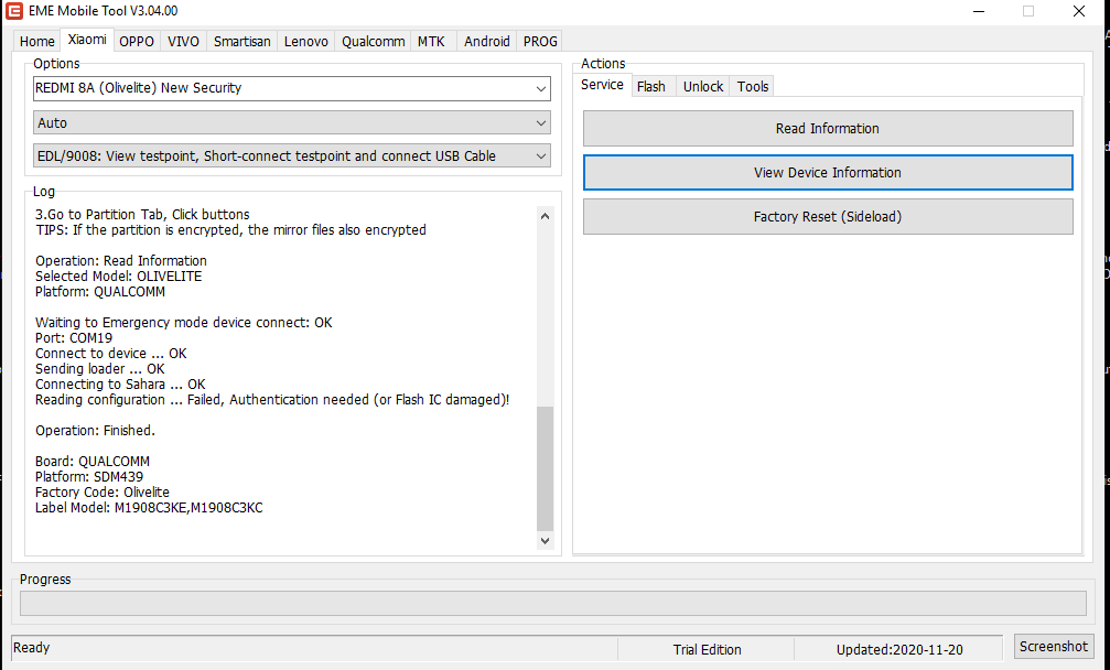

Good evening everyone
I would like to flash my smartphone, but I have an error, the fastboot and recovery does not work, I can only use the edl mod.
What do I have to do ?
Thank you

Hi,
Redmi 8A not support skip auth right now, so you have to do "Auth Service" before flashing
p/s: redmi 8a will add into skip auth list soon.
Best Reagards
EmeGSM Team
