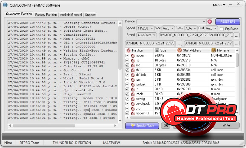

Xiaomi Redmi Note 4 Writing Special firmware (Mi account removed)
DTPRO Tool
Sep 3, 2018
5,288
4,890
nico_2202
27/04/2020 10:44:48 p. m. - Checking Connected Devices..
27/04/2020 10:44:48 p. m. - Device @COM60;
27/04/2020 10:44:48 p. m. - Switching Phone Mode..
27/04/2020 10:44:48 p. m. - Comunicating..
27/04/2020 10:44:49 p. m. - Msm : 0x000460E1
27/04/2020 10:44:49 p. m. - PBL : 0x0xcc3153a80293939b90d02d3bf8b23e0292e452fef662c7499
27/04/2020 10:44:49 p. m. - Sbl : 0x00000000
27/04/2020 10:44:49 p. m. - Writing Flash-Boot Loader..
27/04/2020 10:44:53 p. m. - Setting Config..
27/04/2020 10:44:55 p. m. - Memory : eMMC
27/04/2020 10:44:55 p. m. - IN[4096] OUT[1048576]
27/04/2020 10:44:56 p. m. - Chip Size : 57,75 GB
27/04/2020 10:44:56 p. m. - Gpt Count : 49
27/04/2020 10:44:58 p. m. - Brand : Xiaomi
27/04/2020 10:44:58 p. m. - Model : Redmi Note 4
27/04/2020 10:44:58 p. m. - Android Version : 7.0
27/04/2020 10:44:58 p. m. - Build : AL1512-mido-build-20191107001817
27/04/2020 10:44:58 p. m. - Cpu : arm64-v8a
27/04/2020 10:44:58 p. m. - Chip : msm8953
27/04/2020 10:44:58 p. m. - Writing.. modem From : 131072 To : 172032;
27/04/2020 10:45:01 p. m. - Writing.. sbl1 From : 393234 To : 1024;
27/04/2020 10:45:01 p. m. - Writing.. sbl1bak From : 394258 To : 1024;
27/04/2020 10:45:01 p. m. - Writing.. rpm From : 395282 To : 1024;
27/04/2020 10:45:01 p. m. - Writing.. rpmbak From : 396306 To : 1024;
27/04/2020 10:45:01 p. m. - Writing.. tz From : 397330 To : 4096;
27/04/2020 10:45:01 p. m. - Writing.. tzbak From : 401426 To : 4096;
27/04/2020 10:45:01 p. m. - Writing.. devcfg From : 405522 To : 512;
27/04/2020 10:45:01 p. m. - Writing.. devcfgbak From : 406034 To : 512;
27/04/2020 10:45:01 p. m. - Writing.. dsp From : 406546 To : 32768;
27/04/2020 10:45:02 p. m. - Writing.. fsg From : 524352 To : 3072;
27/04/2020 10:45:02 p. m. - Writing.. sec From : 527424 To : 32;
27/04/2020 10:45:02 p. m. - Writing.. splash From : 655360 To : 22528;
27/04/2020 10:45:02 p. m. - Writing.. aboot From : 786432 To : 2048;
27/04/2020 10:45:02 p. m. - Writing.. abootbak From : 788480 To : 2048;
27/04/2020 10:45:02 p. m. - Writing.. boot From : 790528 To : 131072;
27/04/2020 10:45:03 p. m. - Writing.. recovery From : 921600 To : 131072;
27/04/2020 10:45:04 p. m. - Writing.. system From : 1054720 To : 6291456;
27/04/2020 10:47:21 p. m. - Writing.. cache From : 7471104 To : 524288;
27/04/2020 10:47:22 p. m. - Writing.. persist From : 7995392 To : 65536;
27/04/2020 10:47:22 p. m. - Writing.. lksecapp From : 8912896 To : 256;
27/04/2020 10:47:22 p. m. - Writing.. lksecappbak From : 8913152 To : 256;
27/04/2020 10:47:22 p. m. - Writing.. cmnlib From : 8913408 To : 512;
27/04/2020 10:47:22 p. m. - Writing.. cmnlibbak From : 8913920 To : 512;
27/04/2020 10:47:23 p. m. - Writing.. cmnlib64 From : 8914432 To : 512;
27/04/2020 10:47:23 p. m. - Writing.. cmnlib64bak From : 8914944 To : 512;
27/04/2020 10:47:23 p. m. - Writing.. keymaster From : 8915456 To : 512;
27/04/2020 10:47:23 p. m. - Writing.. keymasterbak From : 8915968 To : 512;
27/04/2020 10:47:23 p. m. - Writing.. userdata From : 10748944 To : 0;
27/04/2020 10:47:28 p. m. - Writing.. primarygpt From : 0 To : 34;
27/04/2020 10:47:28 p. m. - Writing.. backupgpt From : NUM_DISK_SECTORS-33. To : 33;
27/04/2020 10:47:28 p. m. - Rebooting..
