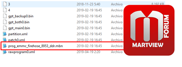

How do I flash the files to unlock the boot of a Xiaomi Redmi 7 with a chimera since you do not take the firehorse, thank you very much.
Good, if you look at the screenshot and it is marked in red if it has a loader, to do it with the chimera tool, we make test point to the xiaomi, we can do it in two ways:
  1. Searching by model.
  2. For qualcomm generic depending on whether one gives an error we make the second point.
Once I do the first step, we go to the second step, we unzip the file, but this time we don't need chimera tool pro, as administrator we open the file.exe, logically we do test point again. It asks for a tungcamlang password, it does its job and finally we have to unlock the bootloader through miunlock by putting the xiaomi in fastboot mode, once unlocked, we will only have to restore to the miui version that we want in fastboot mode or in edl, but now it will not request authorization from the server.
