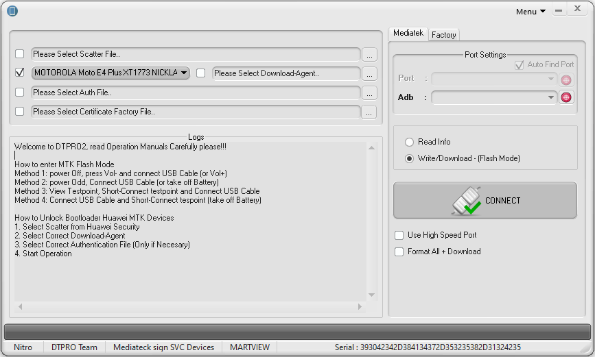

17/06/2020 01:03:03 - Loading Files...
17/06/2020 01:03:03 - Da File : C:\Users\Server-PC\Downloads\DT_MEDIATEK -Signed-Software V2.0.0.0.378\X-Agent\MOTOROLA Moto E4 Plus XT1773 NICKLAUS .bin
17/06/2020 01:03:03 - Checking File 21 [frp].. ok
17/06/2020 01:03:03 - Chip : MT6737M
17/06/2020 01:03:04 - Storage : EMMC
17/06/2020 01:03:04 - Format Before Flash is Disabled...
17/06/2020 01:03:04 - Using High-Speed Port...
17/06/2020 01:03:04 - Starting Flash Task...
17/06/2020 01:03:06 - Waiting For Phone - [Brom Mode]...
17/06/2020 01:03:13 - Phone Found on : MediaTek PreLoader USB VCOM (Android) (COM17)
17/06/2020 01:03:14 - Connected to Device [Brom-Mode]..
17/06/2020 01:03:14 - Writing Da File..
17/06/2020 01:03:16 - Connected to Device [Da-Mode]..
17/06/2020 01:03:16 - Starting Flash Write Process..
17/06/2020 01:03:16 - Device Hardware : MT6737M
17/06/2020 01:03:17 - Writing Files..
17/06/2020 01:03:17 - All Files Written Successfully..
17/06/2020 01:03:17 - Disconnect Phone - And Power on Manually..
