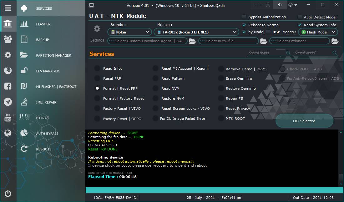

1. Power off device
7. Install drivers if needed
Connection : Flash Mode
Method : By Model
Brand : Nokia
Model : TA-1032 (Nokia 3 LTE NE1)
Process : Format | Reset FRP
Searching for device...
Device found
MediaTek PreLoader USB VCOM_V1632 (Android) (COM31)
Mode : PreLoader
Port : COM31
Preparing Download Agent ...
DA Version : MTK_AllInOne_DA_v3.3001.00.00
Handshaking : DONE
Loading Preloader : DONE
Connecting to Brom : DONE
Chip name : [MT6737M]
Sending DA Download-Agent : ACCEPTED
Identifying Hardware ID ...
ChipID : MT6737M
Software Ver : 0000
Hardware Ver : CA00
Secure Ver : FF
BootLdr Ver : 02
Ext RAM : 0x80000000
SRAM : 0x00020000
Storage : 0x03AC000000
RAM Size : 2.000 GB
SRAM Size : 128.000 KB
Storage Size : 14.688 GB
Storage Type : EMMC
Partition count : 28
Reading system Information...
Model : NE1
Android Ver. : 9
Android OS : Pie
CPU : arm64-v8a
Display id : 00WW_5_18D
Build Date : Thu Aug 27 18:46:15 CST 2020
Build id : PPR1.180610.011
Security Patch : 2020-09-05
Brand : alps
Manufacturer : alps
Product : NE1
Local lang. : en-GB
Carrier : unknown
Searching for required data... DONE
Formatting device ... DONE
Searching for frp data... DONE
Resetting FRP...
USING ALGO - 1
Reset FRP DONE
Rebooting device
If it does not reboot automatically , please reboot manually
If device stuck on Logo, please use recovery to wipe it and reboot
DONE BY UAT MTK MODULE : 4.01
Elapsed Time : 00:00:18
