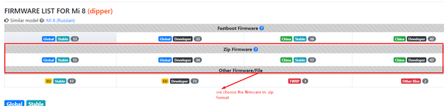

2. The firmware can not be downloaded from this page there are many.
Link: Download Xiaomi Firmware - MIUI Download - Mi ROM - MiFirm
3. The firmware has to be in zip format as I show in the screenshot.
Process:
1. We take the xiaomi, enter the recovery mode and choose the 3rd option of the recovery connect with MiAssistant press power and connect with the xiaomi usb cable.
2. We install the miflash software, we update it, since the same software is another way to download firmware either in zip or fastboot format. We go to the recovery screen and you will see that the software automatically recognizes us the xiaomi, we only have to locate the firmware in .zip format will check the firmware and automatically flash the firmware, without credits or authorized xiaomi accounts.
I hope it has served.
