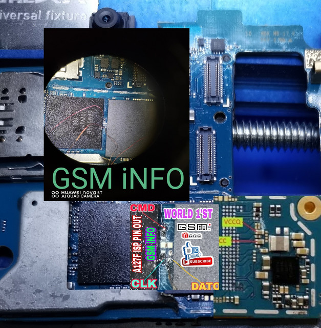

WORLD 1'ST EXCLUSIVE A127F A12 [Exynos 850] ISP PINOUT FRP RESET and DUMP FILE READ

Setting box Pinout ...

Selected pinout: GEN2 ISP Pinout
Change EasyJTAG Pinout OK

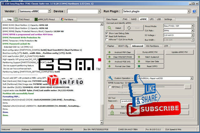

Running:Format FRP Partition...
Z3X EasyJtag Software ver. 3.7.0.20
Loading eMMC GEN2 Firmware... IO: 2800 mV
Box S/N: F6F272D292237F2E, ,FW Ver.: 02.53
CMD Pullup Level:2092 mV
CMD Active Level:2260 mV
Box IO Level:2800 mV
CLK Rate:6000 kHz
Bus Width:1bit,SDR
HiPower mode is off!
---------- eMMC Device Information ----------
eMMC CID : 15010044503644414200E1E0D3E3789B
eMMC CSD : D02701320F5903FFF6DBFFEF8E40400D
eMMC Manufacturer ID: 0015 , OEM ID: 0100
eMMC Date: 07/2005 Rev.0x0
eMMC NAME: DP6DAB , S/N: 3789607907
eMMC NAME (HEX): 445036444142
EMMC ROM1 (Main User Data) Capacity: 59640 MB , 0x747C000 pages , 0xE8F800000 bytes
EMMC ROM2 (Boot Partition 1) Capacity: 4096 kB
EMMC ROM3 (Boot Partition 2) Capacity: 4096 kB
EMMC RPMB (Replay Protected Memory Block) Capacity: 16384 kB
EMMC RPMB is programmed and written 404 times
EMMC Permanent Write Protection: No
EMMC Temporary Write Protection: No
EMMC Password Locked: No
Extended CSD rev 1.8 (MMC 5.1)
Boot configuration [PARTITION_CONFIG: 0x48] Boot from:ROM2 (Boot Partition 1)
Boot bus config [177]: 0x01 , width 4bits , Partition config [179]: 0x48.
H/W reset function [RST_N_FUNCTION]: 0x01
High-capacity WP group size [HC_WP_GRP_SIZE: 0x00004000]
Partitioning Support [PARTITIONING_SUPPORT]: 0x07
Device support partitioning feature
Device can have enhanced tech.
Partitioning Setting [PARTITION_SETTING_COMPLETED]: 0x00
Found valid GPT with protective MBR; using GPT.
Real (Hardware) Disk/Image size: 747C000 sectors 58.2 GiB
Soft (Partitioned) Disk/Image size: 747BFBC sectors 58.2 GiB
Disk identifier (GUID): 52444E41-494F-2044-4D4D-43204449534B
Logical sector size: 0x200 bytes ,First/Last usable sector: 34,122142686
Partition info successfully found
Formatting FRP...
Detected LINUX(Android) PERSISTENT : 0x0012D00000 (512.0KB) formatting...
Done.
Detected LINUX(Android) CACHE : 0x01A2000000 (200.0MB) , formatting...
Done.
Detected LINUX(Android) USERDATA : 0x01B5100000 (51.406GB) , formatting...
Done.
Done.
Done.

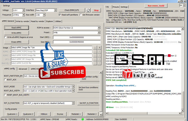

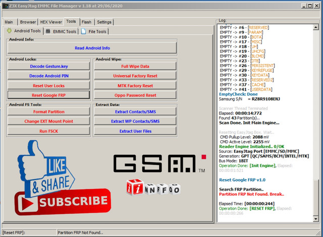

Z3X EasyJtag EMMC File Manager v 1.18 at 29/06/2020 Started..
Box API Version: 3401
FS Driver Version: 29062020
SQLite Version: 3.32.0
FSCK Engine Version: 29062020
ESE DB Version: 29062020
System Util Version: 29062020
System: Windows NT 6.1 (Build 7601, Service Pack 1) / 32 BIT
CPU: Intel(R) Core(TM) i5-3230M CPU @ 2.60GHz
Total RAM: 2.89 GB
Telegram Support: EFM Easy Jtag Emmc Manager Official Russian Group
FRP Apps: Z3X FRP Files
Z3X Card Serial: AA2778BA
EasyJtag Plus Box Found at: COM4
EasyJtag Plus Box Firmware: 2.53.1
Source: EasyJtag Port [EMMC/SD/MMC]
Generation: GPT [QC/SAMS/BCM/INTEL/MTK]
Box Voltage set to: 2800 mV
Scanner Thread Created..
Config: 1011111111101111
Setup HiPower CLK: OFF
Connecting To EasyJtag Plus Box: 2800mV/4MHz/1BIT
EasyJtag Plus Box Found! Result: 0/OK
CMD Pullup Level: 2087 mV
CMD Active Level: 2257 mV
EasyJtag Plus S/N: F6F272D292237F2E
EasyJtag Plus Box FirmWare: 2.53
Box Bus Width = 1 BIT
Box Hardware = EasyJtag 2nd Generation
Search EMMC Chip...
EMMC Chip Found! 0/OK
EMMC CID: 15010044503644414200E1E0D3E3789B
EMMC CSD: D02701320F5903FFF6DBFFEF8E40400D
EMMC VENDOR: SAMSUNG
EMMC NAME: DP6DAB
EMMC SERIAL: E1E0D3E3
EMMC REVISION: 00
EMMC ROM1 Size: 122142720 Block(s)/59640 MB
EMMC ROM2/3 Size: 8192 Block(s)/4096 KB
EMMC RPMB Size: 32768 Block(s)/16384 KB
EMMC RPMB Counter: 404
EMMC RPMB Answer: 0/OK
Switch To ROM1 Part: 0/OK
EMMC REV: 1.8 (for MMC v5.1)
EMMC VER: MMC 5.1
EMMC DEV Life Time: 0x01 -> Normal
EMMC MLC Life Time: 0x01 -> 0% - 10% Life Time Used
EMMC SLC Life Time: 0x01 -> 0% - 10% Life Time Used
EMMC Boot Config: 0x48/0x01/0x01
ExtCSD Automatically Saved..
Scanning Data From EMMC. Please wait..
Scanning GUID Partition Table from ROM1
GUID Partition Table is Found. Max Parts: 128
GPT: GPT [000000000000 - 000000004400] Size: 17.00 KB
GPT: EFS [000000400000 - 000001400000] Size: 20.00 MB
GPT: SEC_EFS [000001800000 - 000001400000] Size: 20.00 MB
GPT: RESERVED [000002C00000 - 000000400000] Size: 4.00 MB
GPT: CPEFS [000003000000 - 000000800000] Size: 8.00 MB
GPT: STEADY [000003800000 - 000000400000] Size: 4.00 MB
GPT: PARAM [000003C00000 - 000000800000] Size: 8.00 MB
GPT: BOTA [000004400000 - 000002400000] Size: 36.00 MB
GPT: LDFW [000006800000 - 000000800000] Size: 8.00 MB
GPT: TZSW [000007000000 - 000000180000] Size: 1.50 MB
GPT: TZAR [000007180000 - 000000680000] Size: 6.50 MB
GPT: KEYSTORAGE [000007800000 - 000000080000] Size: 512.00 KB
GPT: NAD_REFER [000007880000 - 000000100000] Size: 1.00 MB
GPT: UP_PARAM [000007980000 - 000000800000] Size: 8.00 MB
Bus Mode: 1BIT
Operation Done: [Init Engine], Elapsed: 00:00:01:582
Reset Google FRP v1.0
Search FRP Partition..
Partition FRP Not Found. Break..
Elapsed Time: [00:00:00:255]
Operation Done: [RESET FRP], Elapsed: 00:00:00:278
eMMC_tool Suite ver. 1.6.6.0 (release date: 05.05.2021)
Microsoft Windows 7 (32 bit) build 7601 (6.1.7600.16385)
Looking for EasyJTAG box...
EasyJTAG API ver. 3403
EasyJTAG Box Serial = F6F272D292237F2E
Card Serial = AA2778BA
EasyJTAG Box Firmware = 2.5301
Changelog:
05.05.2021 (ver 1.6.6.0)
Add: New keys for Oppo unpack
Fix: Bugs that have been found through your crash report
05.05.2021 (ver 2.0.1.0)
Add: Vendor LG
Add: Mediatek Preloader Parser
Add: OnePlus Unpacker
Add: Xiaomi Custom EDL Authorization
Add: Xiaomi Remove Mi Account (only Qualcomm)
Setting interface to EasyJtag2/ISP
Setting bus width to 1 Bit
Setting frequence to 24 MHz
CMD Pullup Level: 2081 mV
CMD Active Level: 2255 mV
EMMC Device Information :
EMMC Manufacture : SAMSUNG , EMMC NAME: DP6DAB , HEX: 445036444142 , S/N: E1E0D3E3 , rev. 0x00
EMMC Manufacture ID: 0x15 , OEM ID: 0x00 , Device Type: BGA (Discrete embedded) , Date: 7/2021
EMMC ROM 1 (Main User Data) Capacity: 59640 MB (000E8F800000)
EMMC ROM 2/3 (Boot Partition 1/2) Capacity: 4096 KB (000000400000)
EMMC RPMB (Replay Protected Memory Block) Capacity: 16384 KB (000001000000) Counter: 404 , Response: Not Clean
Extended CSD Information :
Extended CSD rev: 1.8 (MMC 5.1)
Boot configuration [PARTITION_CONFIG]: 0x48 , Boot from: ROM2 (Boot partition 1)
Boot Bus Config: 0x01 , width 4bit
H/W Reset Function [RST_N_FUNCTION]: 0x01, RST_n signal is permanently enabled
Supported partition features [PARTITIONING_SUPPORT]: 0x07
Device supports partitioning features
Device can have enhanced technological features in partitions and user data area
Device can have extended partitions attribute
Partition Settings [PARTITION_SETTING_COMPLETED]: 0x00
Backup saved: DP6DAB_E1E0D3E3_20211024_194219.extcsd
EMMC Init completed.
Operation: Reading from eMMC...
Reading from: ROM1 , start: 0x000000000000 , size: 0x000080000000
Output file: C:\Program Files\Z3X\EASYJTAGPLUS\A127F DUMP\EMMC_NONAME_ROM1_000000000000_000080000000.bin
eMMC switching to ROM1
Reading partition...
Done reading partition. Read speed: 2839.96 Kb/s
All done time: [00:12:18:809]
CMD Pullup Level: 2086 mV
Backup saved: DP6DAB_E1E0D3E3_20211024_195619.extcsd
Reading from: ROM2 , start: 0x000000000000 , size: 0x000000400000
Output file: C:\Program Files\Z3X\EASYJTAGPLUS\A127F DUMP\EMMC_DP6DAB_ROM2_000000000000_000000400000.bin
eMMC switching to ROM2
Done reading partition. Read speed: 2198.99 Kb/s
All done time: [00:00:02:104]
Backup saved: DP6DAB_E1E0D3E3_20211024_195639.extcsd
Reading from: ROM3 , start: 0x000000000000 , size: 0x000000400000
Output file: C:\Program Files\Z3X\EASYJTAGPLUS\A127F DUMP\EMMC_DP6DAB_ROM3_000000000000_000000400000.bin
eMMC switching to ROM3
Done reading partition. Read speed: 2211.76 Kb/s
All done time: [00:00:02:156]
