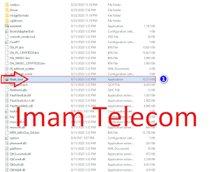

STEP :- 1
Download SP TOOL , Extract and Open Sp flash tool Folder and Run Flash Tool.exe.

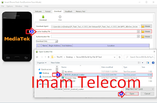

STEP :-2
Sp flash tool is Launched, Select Scatter loading File from FRP remove file folder.

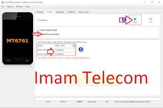

STEP :-3
1.Format Menu and Select Manual format flash
2.Enter Begin Address and Format Length from FRP address txt file
STEP :-4
1.connect your phone (Sp flash tool Detect your Phone flashing will start automatically)
2.After flash complete disconnect your device and reboot
3.All done.
