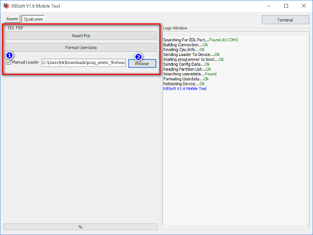

Remove Vivo V7 Plus Screen Lock Remove Vivo V7+ FRP Lock Reset
Unlock VIVO FRP lock and do a hard reset using RBSoft Mobile Tool v1.6, you can also download free RBSoft Qualcomm EDL Mode FRP reset tool and it’s working.
You can easily remove pattern lock from your any OPPO Qualcomm processor device and also if you don’t know your device processor,
So you can find out your smartphone specifications on google and there you will be able to find your device processor whether it is “Qualcomm” or not. This method is especially for Qualcomm processor devices.
Note: This method has successfully been applied on Vivo V7 Plus.
Download Vivo V7 Plus FRP Lock Removal Tool:
FRP Bypass Tool RBSoft_V1.6_Mobile_Tool.rar
Vivo V7 Plus FRP File prog_emmc_firehose_8953_ddr_vivo_v7_plus.mbn
Vivo V7 Plus Drivers driver_qualcomm_9008.rar
How To Remove Vivo V7 Plus Screen Lock FRP Bypass:
  • Download all the files and move them into the same folder on pc. It will help you to find the all required files easily.
Power off >> Press & Hold Volume Up key + Volume Down key + Insert USB cable at the same time.
It will create “Qualcomm HS-USB QDLoader 9008 port under the “Device Manager” on pc. That means the device is properly connected with pc into EDL mode.
  • Next, extract the downloaded “REBSOFT v1.6 zip” file and run “RBSoft_V1.6_Mobile_Tool.exe” file as administrator.
  • Here it will ask to put correct “password” to continue the installation process. [Check “pass.txt” file for password]
Select “Qualcomm” tab >> Tick mark on “manual Loader” >> click on “browse” button >> load the “prog_emmc_firehose_8953_ddr_vivo_v7_plus.mbn” file
  • In the last, hit on “Format Data” button to reset phone data completely.
  • Format process will start on the device and just in few second devices will reboot again.
  • Once you see the below screen, select “Reboot” option by pressing power key and “data wipe” process will start.
  • Factory reset done on the device but still, it will ask to verify Google account verification.
  • Again boot device into “EDL Mode” using hardware key combination.
  • In next step, again go to “RBSoft v1.6” and click on “Reset FRP” button to remove FRP on Vivo V7 plus.
  • All done!!! reboot the device, set up the device again as a new device. At this time, it will not ask you to enter Google ID & password to verify Google account. That means you have unlocked screen lock and FRP lock on Vivo V7 plus using the RBSoft v1.6 tool.

Remove Vivo Y71 Plus Screen Lock FRP Bypass Without Box
Vivo Y71 Patter Lock Remove Tool Delete User Lock Screen Password Using Rbsoft v1.6 Tool Vivo Y71 TestPoint
Download Vivo Y71 FRP Tool:
Vivo Y71 FRP File prog_emmc_firehose_8917_ddr_y71.mbn
Vivo Y71 Drivers driver_qualcomm_9008.rar
How To Remove Vivo Y71 Screen Lock FRP Bypass:
Vivo Y71 Test Point:
Next, extract the downloaded “REBSOFT v1.6 and Follow bellow method
How to Vivo FRP Lock With RBSoft 1.6
