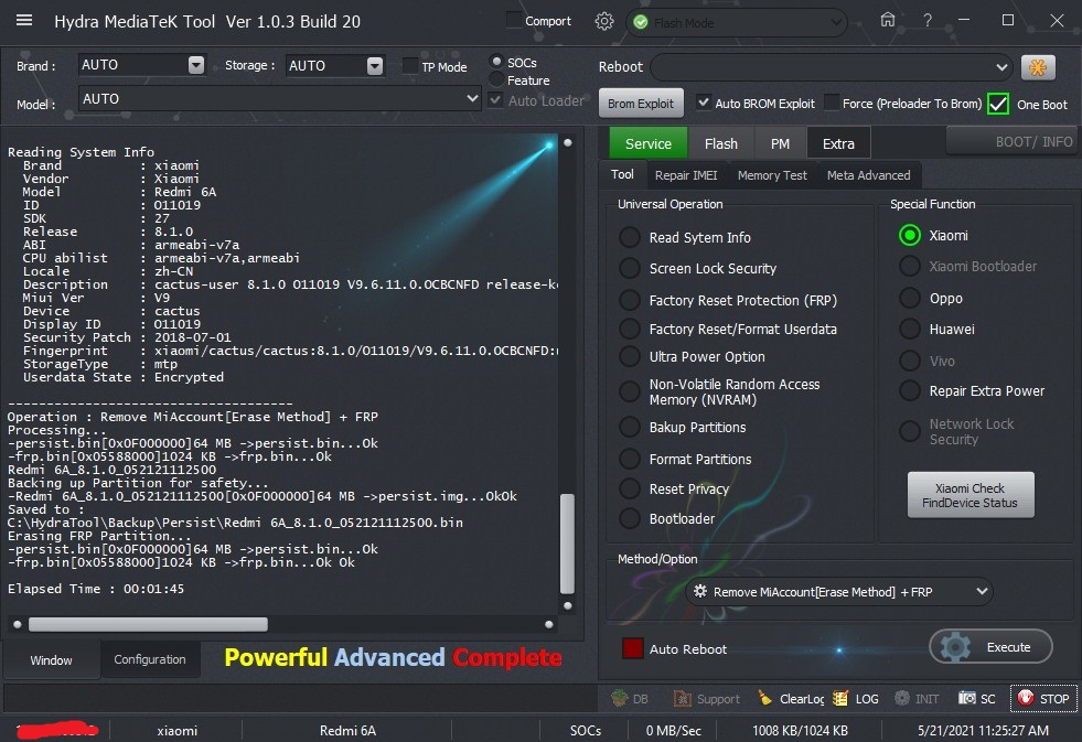

Another Xiaomi Redmi 6a Mi Account successfully Removed by Hydra Tool
1. Run Hydra MTK Module and choose "Sosc"
2. Select Brand and Model as "Auto"
3. Go to Service-->Tools-->Xiaoami
4. Choose "Remove Mi Account + FRP" from "Method / Option" drop down menu
5. Execute and connect the device to the computer with data cable
6. wait until the process is completed
.2. Select Brand and Model as "Auto"
Screen Shorts
Logs

Operation : Remove MiAccount[Erase Method] + FRP
Processing...
-persist.bin[0x0F000000]64 MB ->persist.bin...Ok
-frp.bin[0x05588000]1024 KB ->frp.bin...Ok
Redmi 6A_8.1.0_052121112500
Backing up Partition for safety...
-Redmi 6A_8.1.0_052121112500[0x0F000000]64 MB ->persist.img...OkOk
Saved to :
C:\HydraTool\Backup\Persist\Redmi 6A_8.1.0_052121112500.bin
Erasing FRP Partition...
-frp.bin[0x05588000]1024 KB ->frp.bin...Ok Ok
Elapsed Time : 00:01:45
