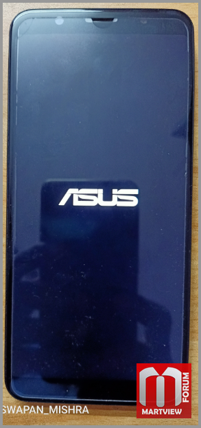

ASUS ZENFONE MAX PRO M1 (X00TD) HANG ON LOGO SOLVED BY UMT

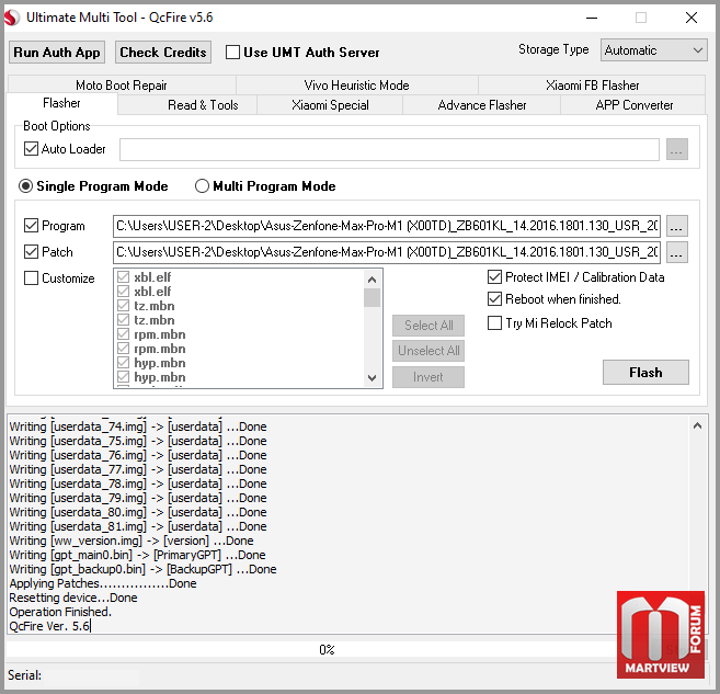

Operation : Flash
Checking for existing devices...Not Found
Found Port : Qualcomm HS-USB QDLoader 9008 (COM6)
Driver Info : Qualcomm Incorporated, qcusbser.sys, 2.1.2.2
Connecting to phone...OK
Waiting for response...Ignored
Init Handshake Sequence...OK
Hardware ID : E1C00C00 [8996] 00000000
OPK_DATA : 2C58A12EBD1022BD5DBD5D937D1E2451092F62C202525FFCF06EB106DBF93155
Initializing Protocol...OK
Preparing Loader...Done
Sending Loader [8996_019]...Done
Executing Loader...OK
Detecting Chip Type...OK
Hardware : MSM8996, eMMC, 64 GB
LU Count : 1 [0x0747C000]
Payload Info : In: 65536 [4096], Out: 131072, Sector Size: 512
Writing [xbl.elf] -> [xbl] ...Failed
Operation Finished.
