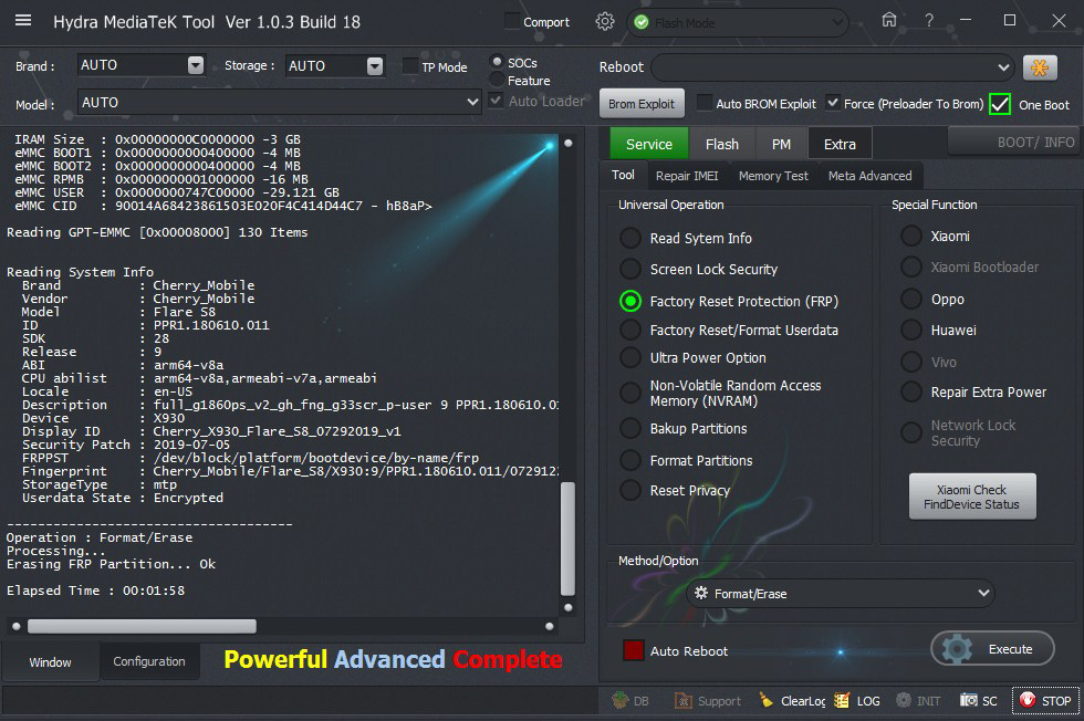

Hydra Cherry Mobile Flare S8 FRP partition successfully removed by Hydra Tool
550
FriendlyName :MediaTek USB Port_V1632 (COM120)
SymbolicName :\??\USB#VID_0E8D&PID_0003#5&31f1a2f8&0&5#{a5dcbf10-6530-11d2-901f-00c04fb951ed}
Handshaking...Ok
Identifying Hardware ID.....
BROM CPUID : 0690MT6763T[6763]
BROM HW_SW_VER : 8A00 CA01 0001 0000
SECURE VERSION : 00
BL VERSION : FE
BR Secured : 00
NORMAL BOOT
Preparing Download Agent..
DA : 6763.bin
Ver : MTK_AllInOne_DA_v3.3001.2020-11-03.22:07_536568
Init : Loader [1]
Sending : Accepted
Identifying Protocol...
Protocol : New
Synchronization...SYNC
Mode : brom
Preloader Initialization...
Parsing preloader_oppo6763_17031.bin
Init : Accepted
Execute Secondary Loader
Init : Loader [2]
Executing : SYNC
UNIQUE ID : D5C913713E6CCBAF1E808F772A9E246B
eMMC CID : 90014A68423861503E020F4C414D44C7 - hB8aP>
DA Speed : high-speed
Reading System Info
Brand : Cherry_Mobile
Vendor : Cherry_Mobile
Model : Flare S8
SDK : 28
Release : 9
ABI : arm64-v8a
Locale : en-US
Description : full_g1860ps_v2_gh_fng_g33scr_p-user 9 PPR1.180610.011 0729122925 release-keys
Device : X930
Display ID : Cherry_X930_Flare_S8_07292019_v1
Security Patch : 2019-07-05
FRPPST : /dev/block/platform/bootdevice/by-name/frp
Fingerprint : Cherry_Mobile/Flare_S8/X930:9/PPR1.180610.011/0729122925:user/release-keys
StorageType : mtp
Userdata State : Encrypted
Autobackup Partitions
-> Renaming Preloader.... preloader_g1860ps_v2_gh_fng_g33scr_p.bin
Creating Scatter file... C:\Hydra Tool\\Backup\Auto\0690_Cherry_Mobile_Flare_S8_X930_9_PPR1.180610.011_0729122925_031721070147\MT6763T_Android_scatter.txt
-frp[0x03588000]1024 KB ->frp.bin...Ok
-nvdata[0x05688000]64 MB ->nvdata.bin...Ok
-persist[0x0D000000]48 MB ->persist.bin...Ok
-nvram[0x17800000]64 MB ->nvram.bin...Ok
Done!!!
Reading System Info
Model : Flare S8
SDK : 28
Release : 9
ABI : arm64-v8a
Locale : en-US
Device : X930
StorageType : mtp
Operation : Format/Erase
Processing...
Erasing FRP Partition... Ok
Elapsed Time : 00:01:58
