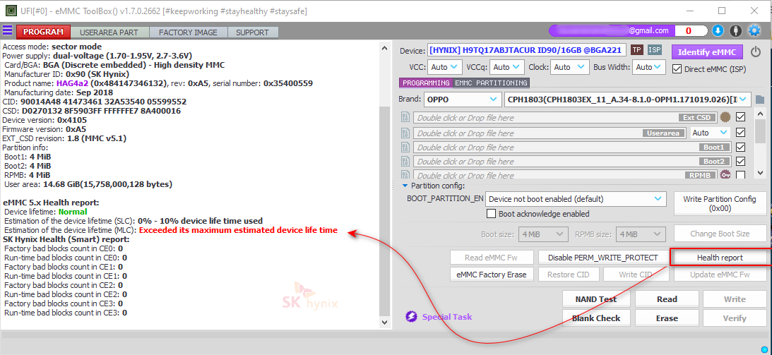

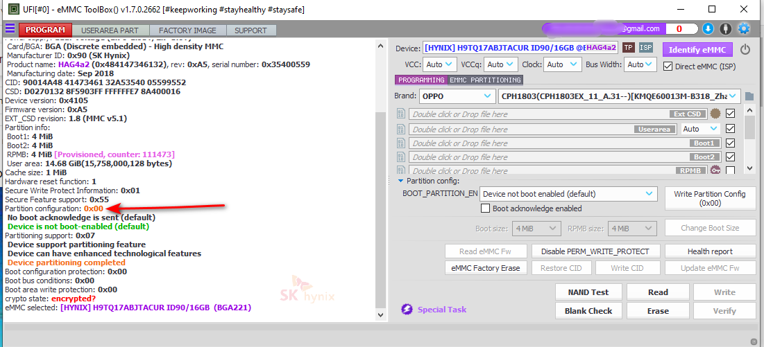

I have oppo a3s cph1803 auto restart ... after flash with dump ...
Current partition access:
 Access to boot partition 1
Loading file: "\\C:\Users\M\Desktop\ma\dump%20from%20net\CPH1803(CPH1803EX_11_A.34-8.1.0-OPM1.171019.026)[KMQE60013M-B318_8A12978C]\boot1.bin", size: 4 MiB...
Writing boot1 (8192 sectors)... Done in 8.983 s
 Access to boot partition 2
Loading file: "\\C:\Users\M\Desktop\m\dump%20from%20net\CPH1803(CPH1803EX_11_A.34-8.1.0-OPM1.171019.026)[KMQE60013M-B318_8A12978C]\boot2.bin", size: 4 MiB...
Writing boot2 (8192 sectors)... Done in 8.838 s
 Access to user area
Loading file: "\\C:\Users\M\Desktop\mdump%20from%20net\CPH1803(CPH1803EX_11_A.34-8.1.0-OPM1.171019.026)[KMQE60013M-B318_8A12978C]\userarea_512MiB.bin", size: 512 MiB...
Writing userarea (1048576 sectors)... Done in 18 mins 24.846 s
Loading file: "\\C:\Users\M\Desktop\m\dump%20from%20net\CPH1803(CPH1803EX_11_A.34-8.1.0-OPM1.171019.026)[KMQE60013M-B318_8A12978C]\ext_csd.bin", size: 512 bytes...
Writing extcsd, 512 bytes... Done
New EXT CSD info:
EXT_CSD revision: 1.8 (MMC v5.1)
Partition info:
 Boot1: 4 MiB
 Boot2: 4 MiB
 RPMB: 4 MiB [Provisioned, counter: 111473]
 User area: 14.68 GiB(15,758,000,128 bytes)
Cache size: 1 MiB
Hardware reset function: 1
Secure Write Protect Information: 0x01
Secure Feature support: 0x55
Partition configuration: 0x38
Partitioning support: 0x07
Boot configuration protection: 0x00
Boot bus conditions: 0x00
Boot area write protection: 0x00

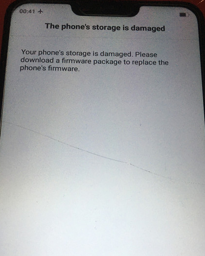

now Phone’s Storage is damaged

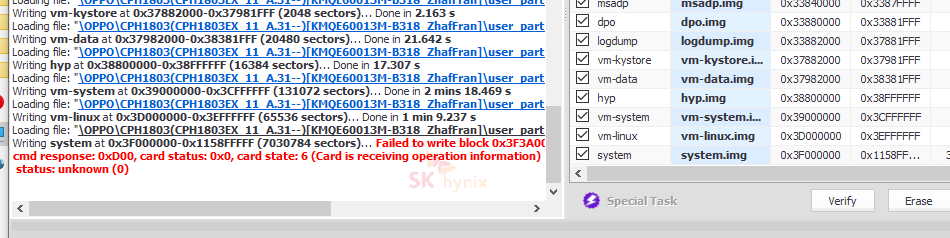

but error during write system partition
Loading file: "\OPPO\CPH1803(CPH1803EX_11_A.31--)[KMQE60013M-B318_ZhafFran]\user_part\system.img", size: 3.35 GiB...
Writing system at 0x3F000000-0x1158FFFFF (7030784 sectors)... Failed to write block 0x3F3A0000:65536 (return code: 36, Transmission Error: Data CRC fail)
cmd response: 0xD00, card status: 0x0, card state: 6 (Card is receiving operation information)
 status: unknown (0)

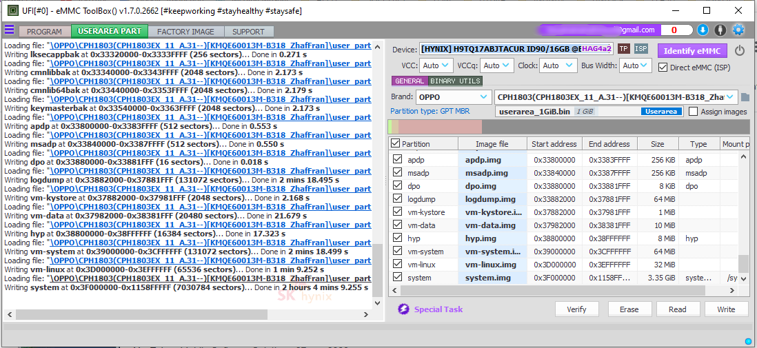

thank you ...
flashing done by changing usb cable

but problem not solved ... and now i have partition configuration 0x00

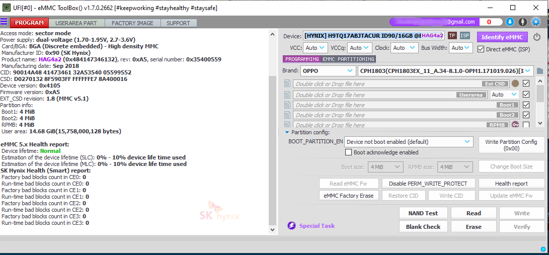

thank you ...
